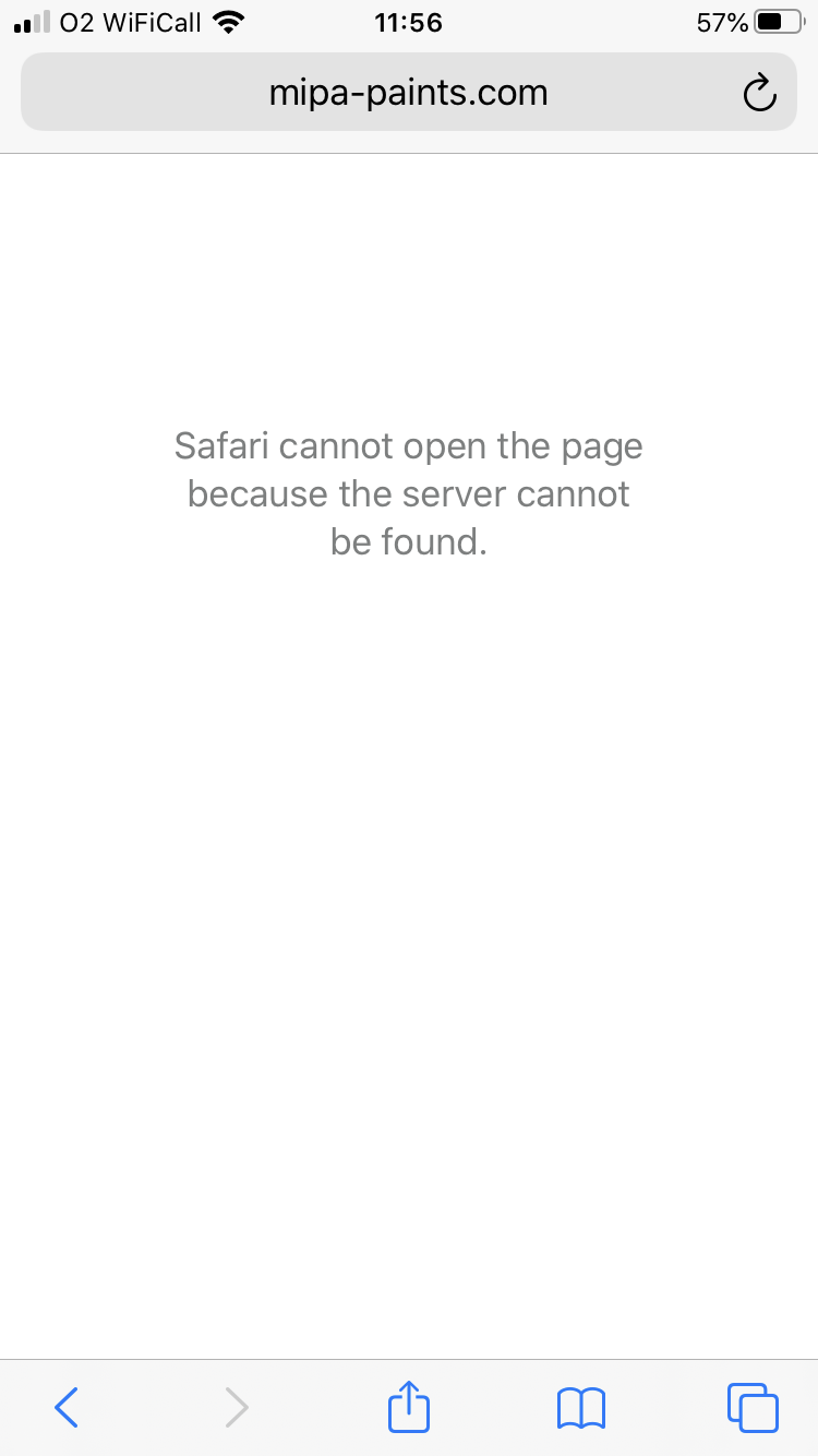

No drip test measurements for technico coatings. Carbon suggested adjusting my clear to about 18 seconds. I’ve got Mipa clear on order now. I’ll set it’s viscosity at around 18 if I can’t see any viscosity test on the cans. Their website doesn’t work currently.If you have your gun set right and drip test is good, top coat speed is about 1sec to 1mtr

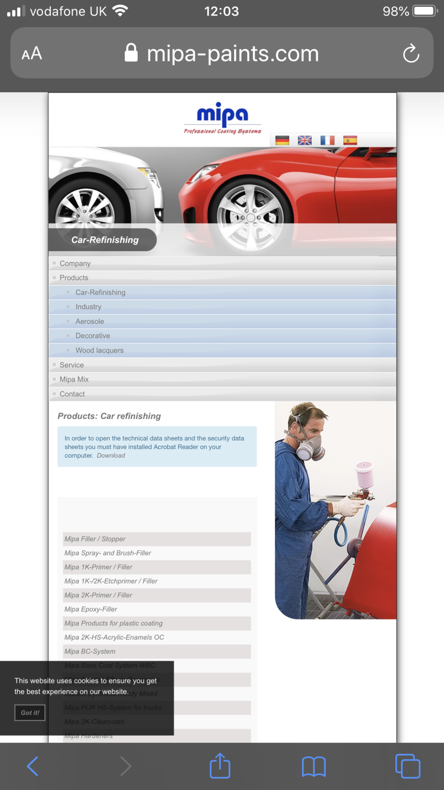

I keep getting thisMipa's site with SDS and Product info can be found here https://www.mipa-paints.com/en/products/car-refinishing/
