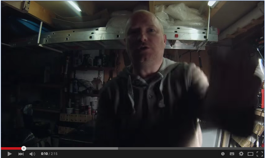

Actually... if you've seen my videos (most shot in the depths of winter) you'll see that it's not exactly bursting with light right now
