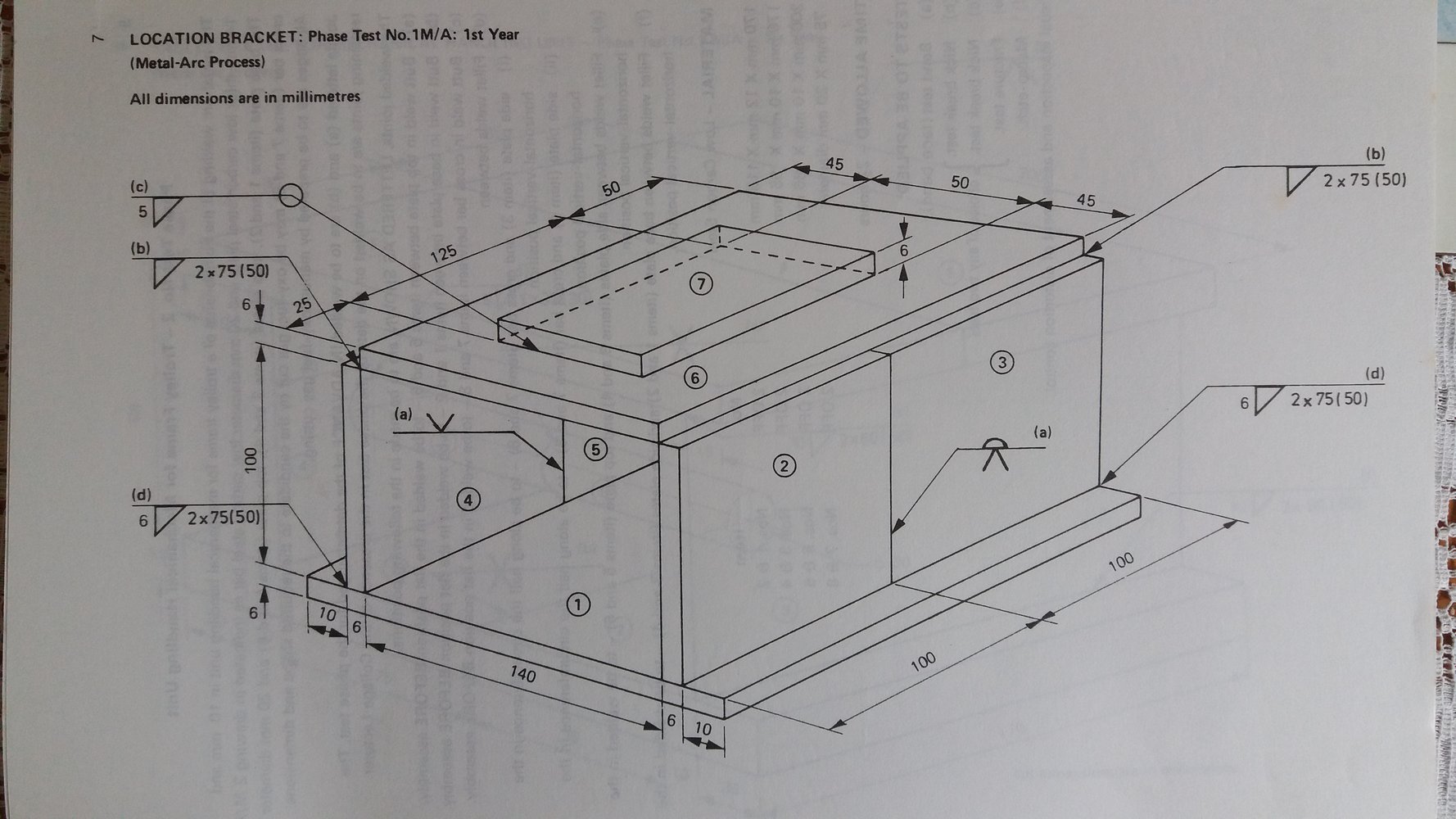

Apologies, I meant a stop-start, not a gap between welds (a stop-start is a requirement of most awarding bodies)The isometric with the weld symbols posted above has several stop/start annotations - the "2x75(50)" - two welds, 75mm long, with a 50mm gap
I have pictures of the rest of the manual if you want themDont you use phase testing nowadays? this is one of the exercises from the EMFEC course left over from my teaching days which was derived from and equivalent to City and Guilds, this is a first year practical test for MMA welding complete with material thicknesses and weld details all in mm, I have pictures of the rest of the manual if you want them, did have all the books up to year five covering all the processes but unfortunately were lost in a house move some years ago
Does this include all weld details and symbols etc?I am quite late to this thread, but we are building something that may be of interest here.
