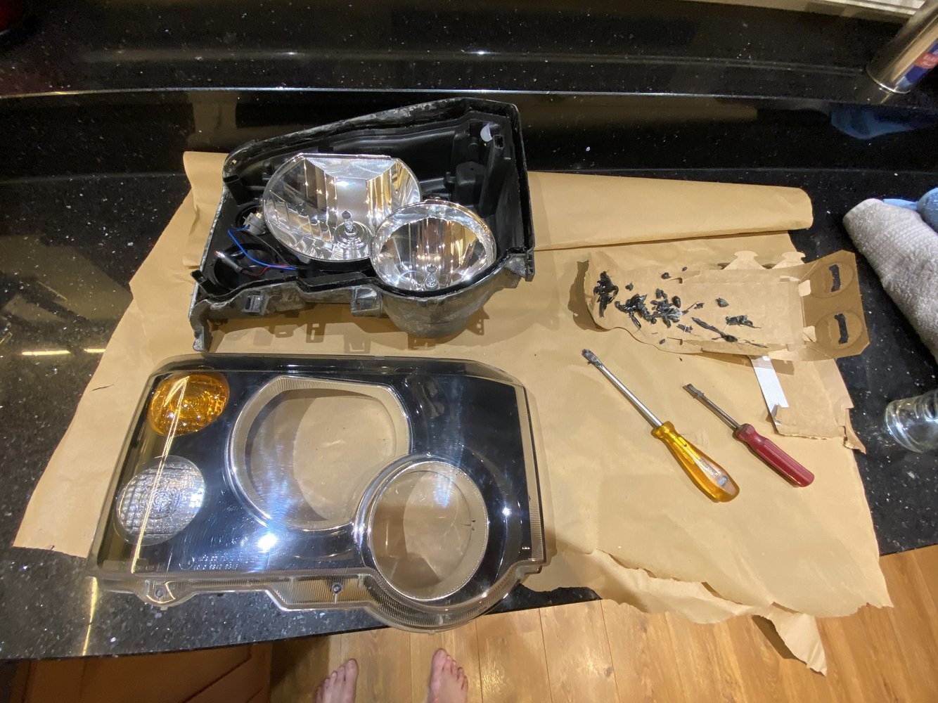

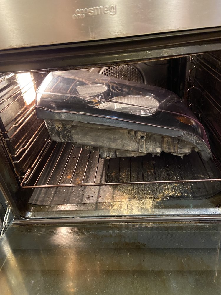

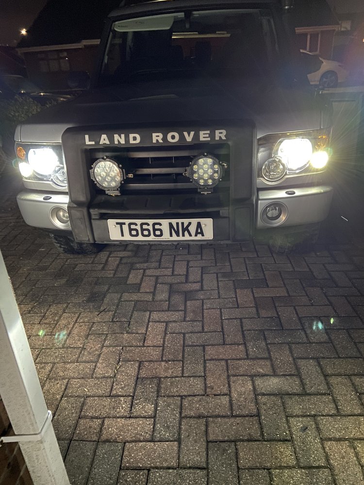

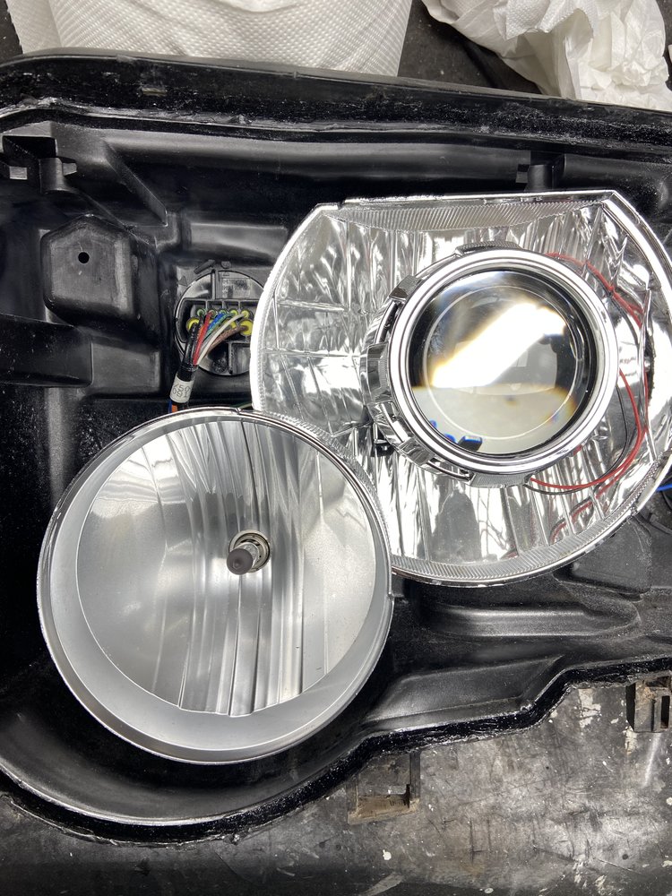

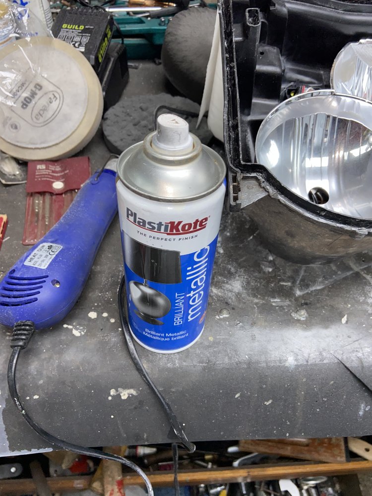

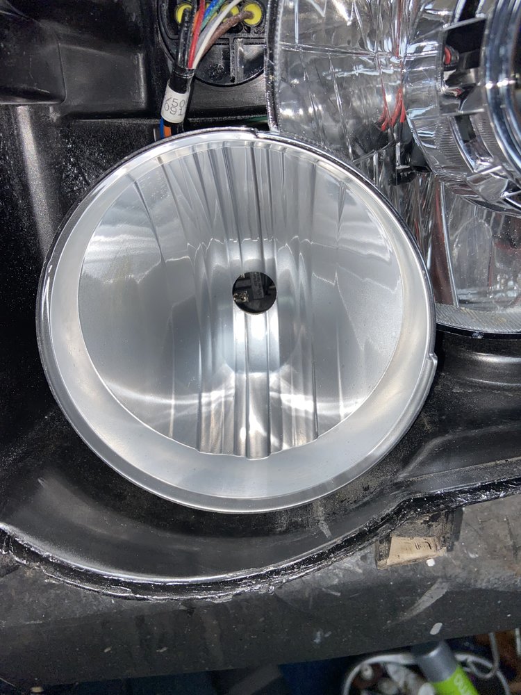

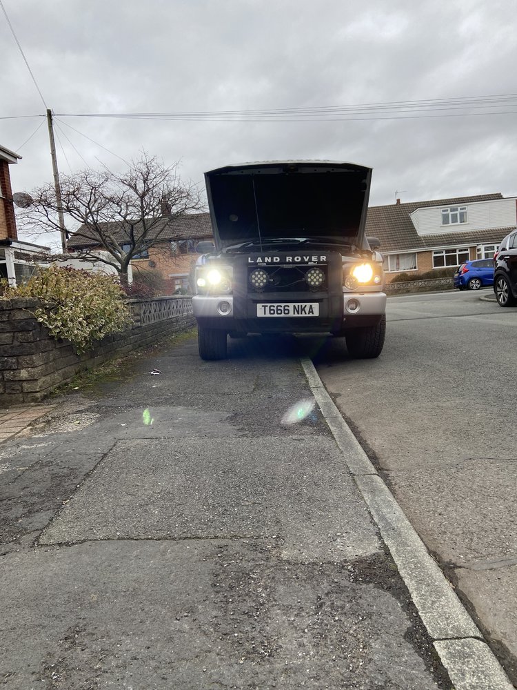

no plate sign of the Devil in youEnded up not bothering with the painted bowl, i wouldnt have been able to unsee it. Ive used the oven method to melt the lens glue and can split a unit and clean the excess in ten minutes so converted a good one off the car. Im more than impressed with the light output and beam cut off
View attachment 383919 View attachment 383920 View attachment 383921 View attachment 383922 View attachment 383923 View attachment 383924
