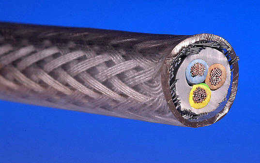

R Rayf Member Messages 50 Location UK Norfolk Feb 15, 2021 #23 SY cable would be a durable option: 2.5mm² 3 Core SY Protected Cable Flex - 50M Drum
J1nx Member Messages 675 Location Somerset UK Feb 15, 2021 #24 Rayf said: SY cable would be a durable option: 2.5mm² 3 Core SY Protected Cable Flex - 50M Drum Click to expand... Outside? Needs protecting from UV I believe.
R Rayf Member Messages 50 Location UK Norfolk Feb 15, 2021 #25 Yes, a UV protected specification is available, as used frequently by air con. installers.
