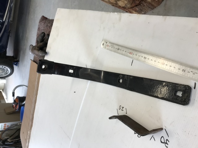

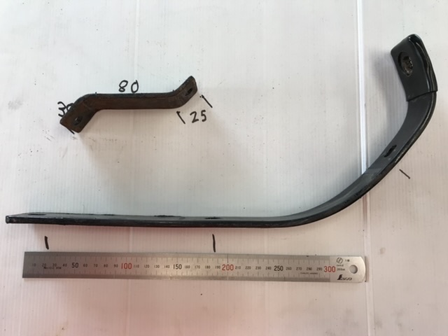

Took one off the car this morning, they appear to have just been bent rather than rolled
Went to my usual steel supplier today, they don’t do stainless, so I thought why not make them in aluminium? Earlier cars were Ali, not quite as much impact resistance but if you crash in a Morgan the outcome is never going to be good, and weight saving is always good.
Anyway, they had no ali the right size, but they called head office who had 3m of 40x8 on the shelf, so they’re dropping it round to me on Wednesday
Allly is awful in fatigue.....dont do it........aeroplanes use uncommon grades glued and rivetted together
