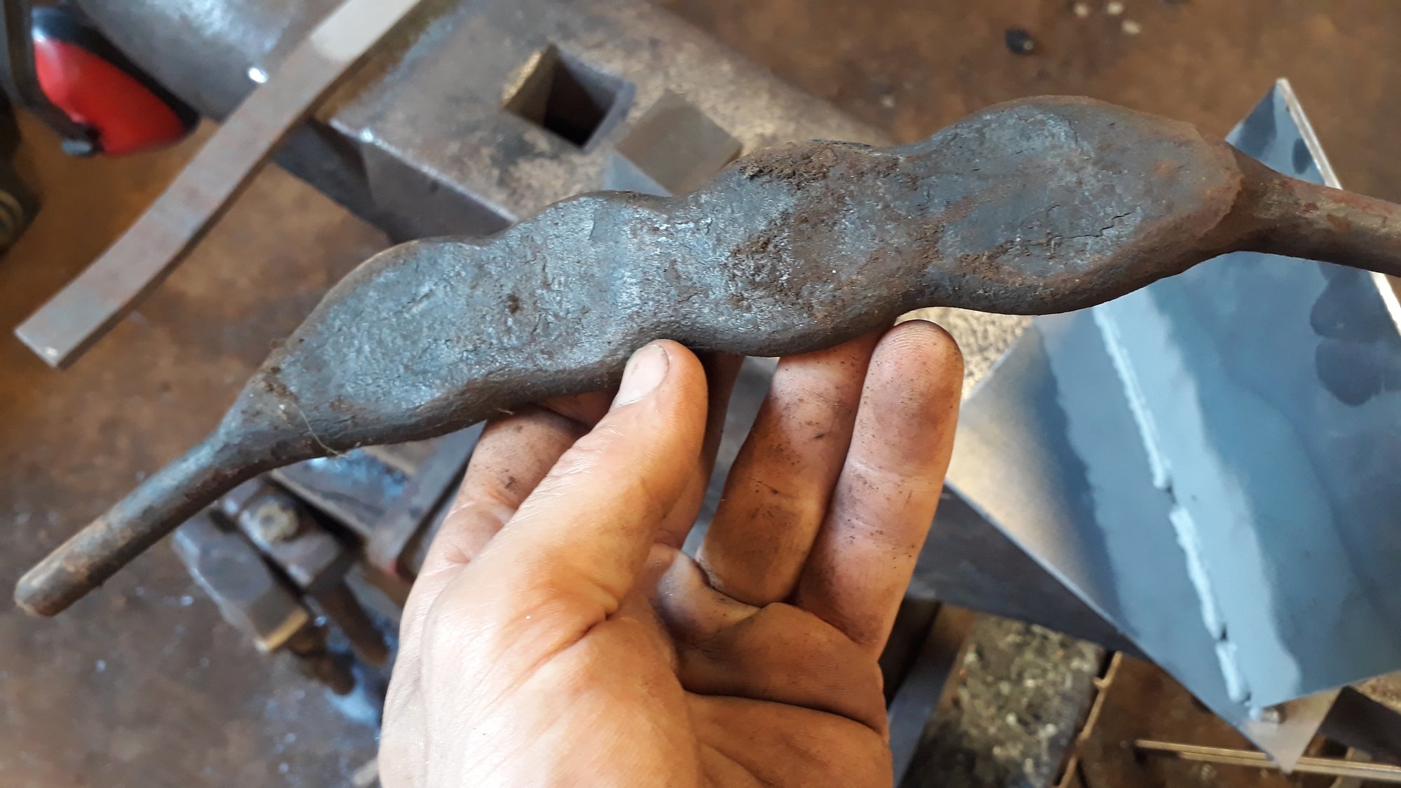

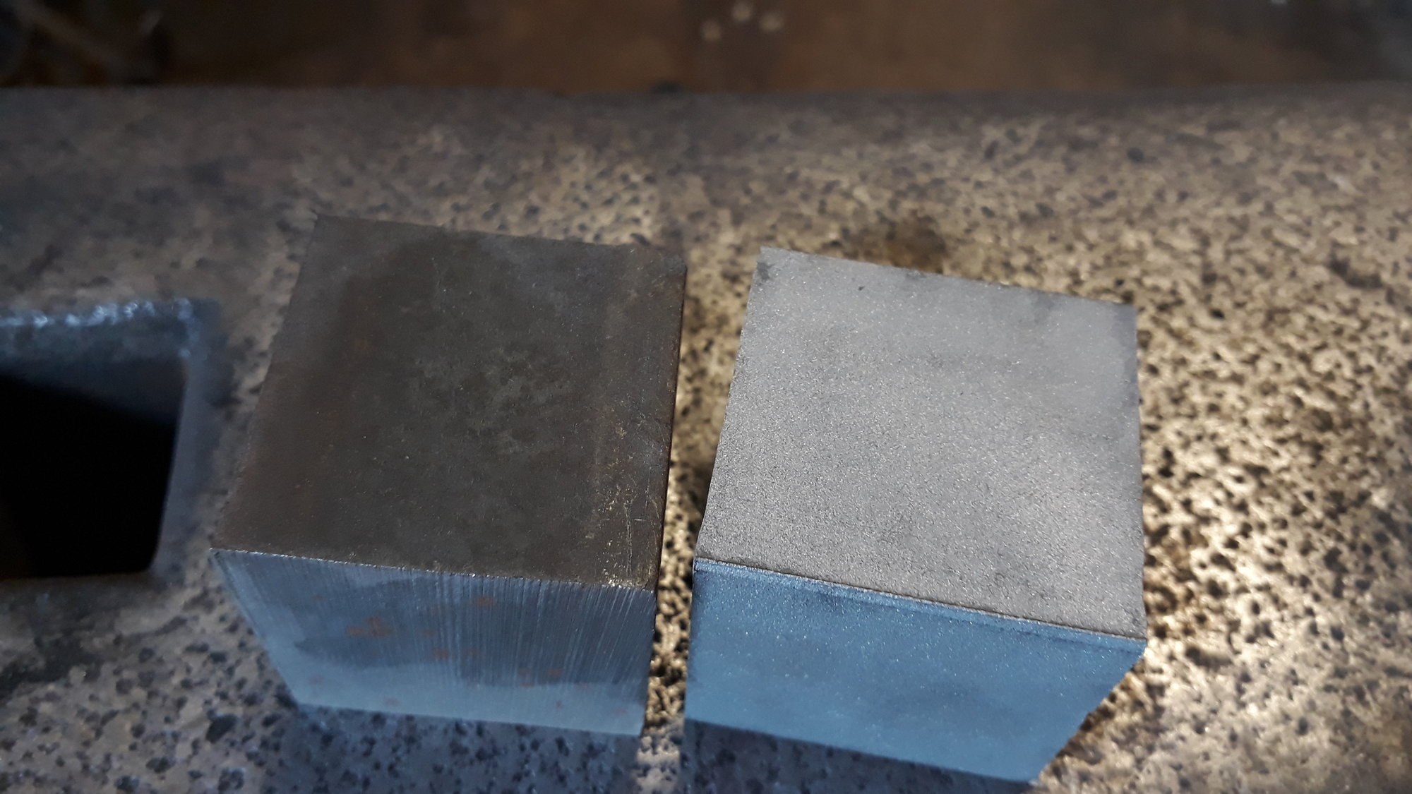

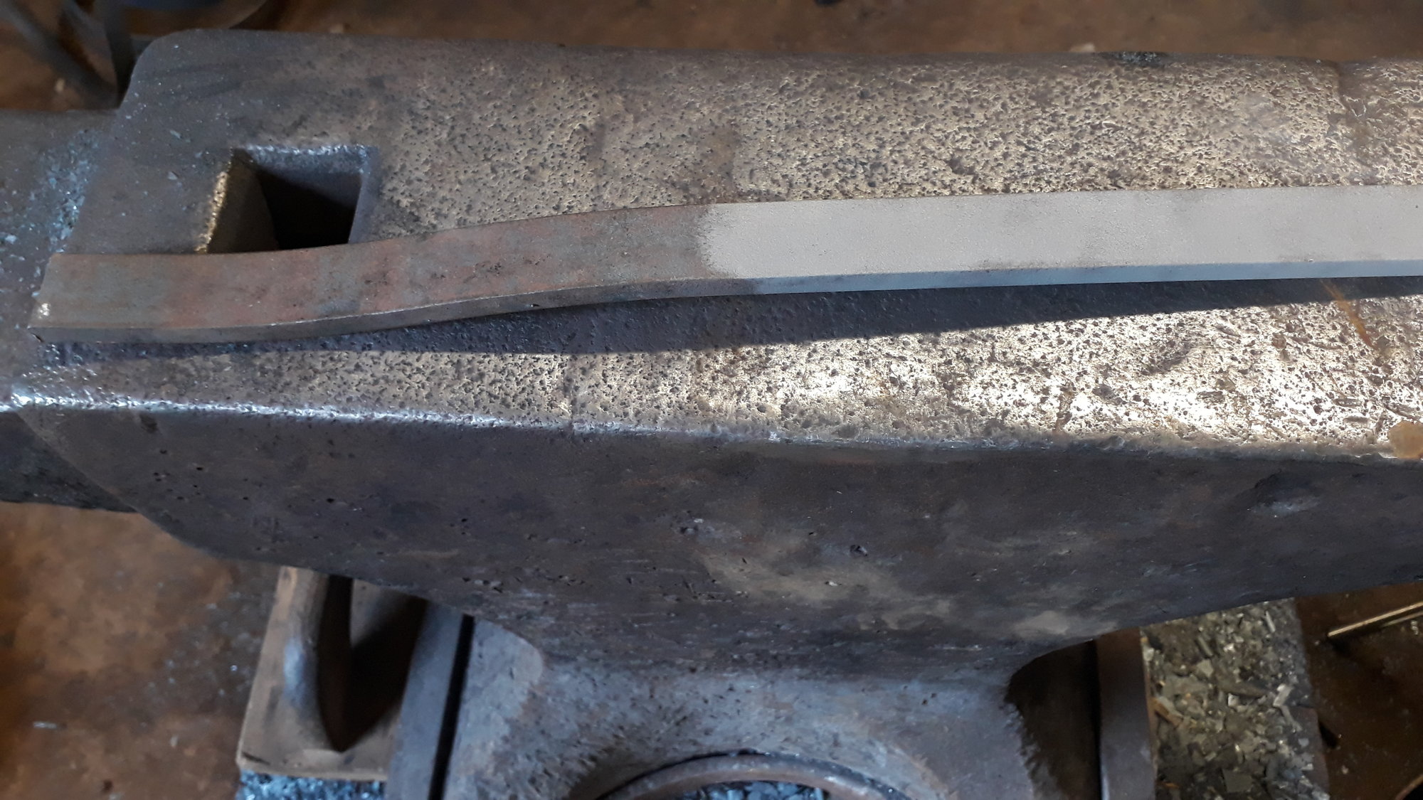

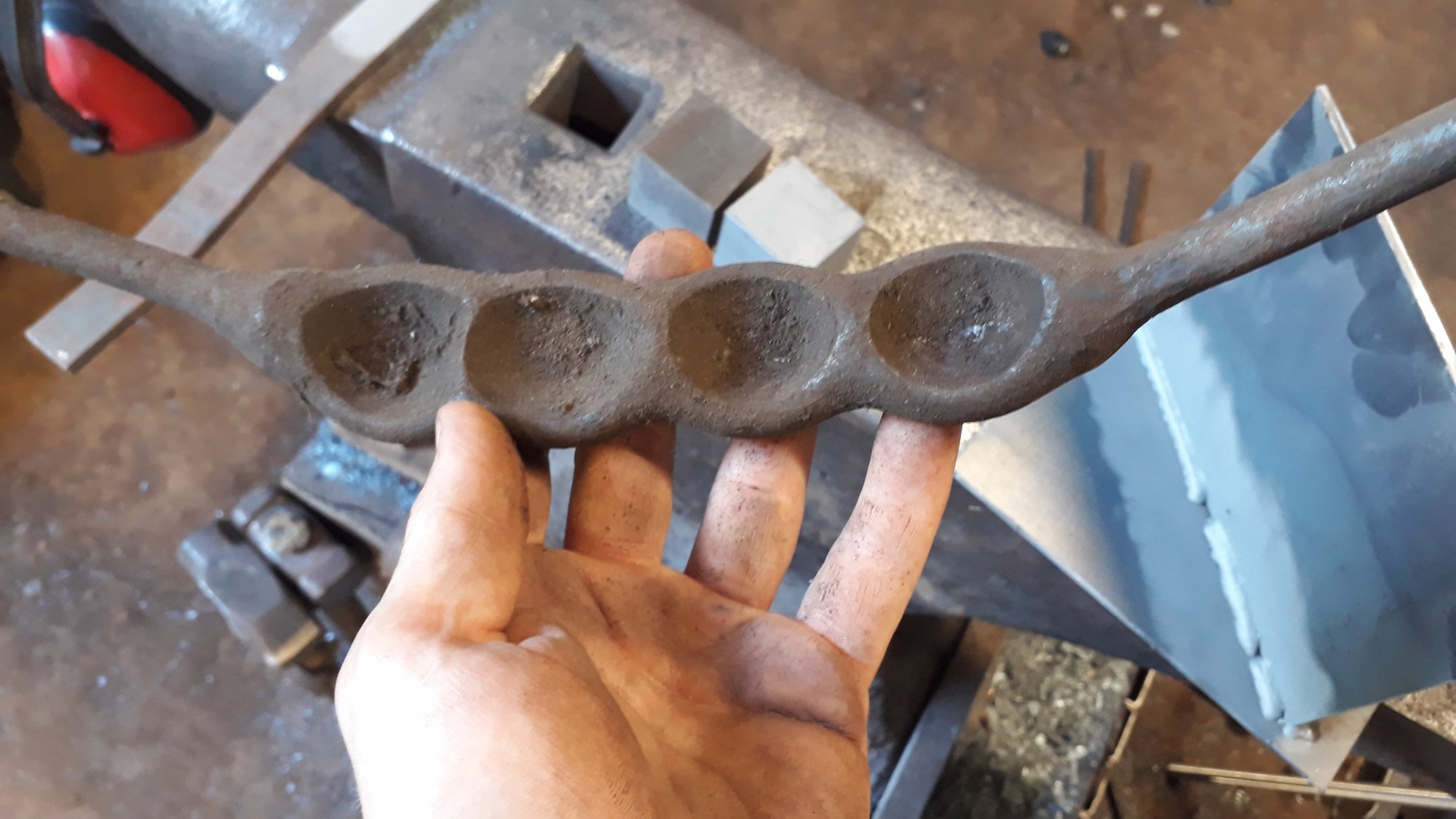

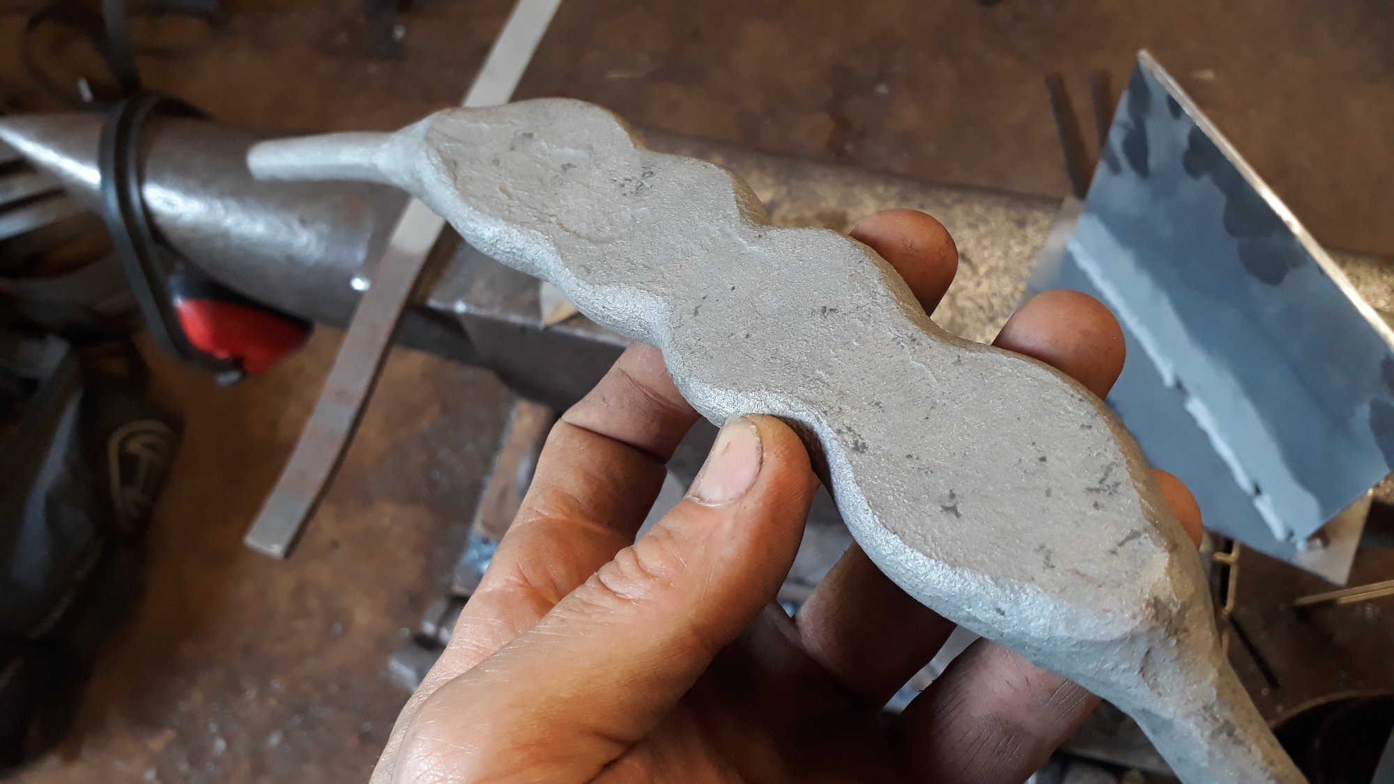

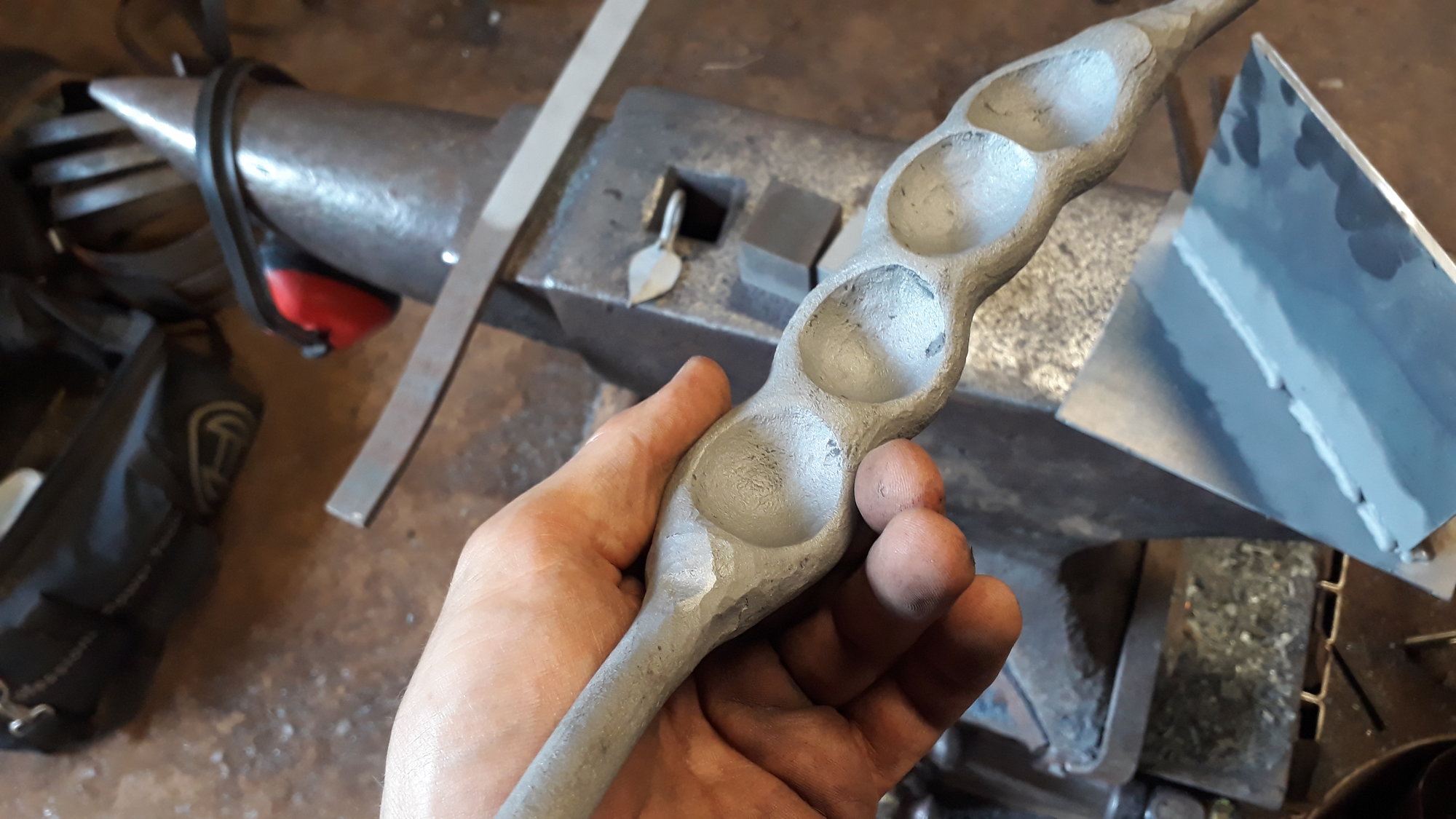

I know Clarke / Machine Mart equipment can be pretty useless but I decided to take a punt on their bench top blasting cabinet & it seems to actually be doing what I want it to. Using their 60/80 aluminium oxide grit with the 4mm nozzle it came with. I was once told that a 3mm nozzle would work best so I'll try and get my hands on one of them. Tried it on a variety of test pieces for different scale types:
Flat bar, 40mm cubes and old sculpture component with heavy scale in the depressions. I never really believe the reviews on company websites so thought I'd post for the sake of others who want an unbias opinion, with evidence. Model No.: CSB20B.
