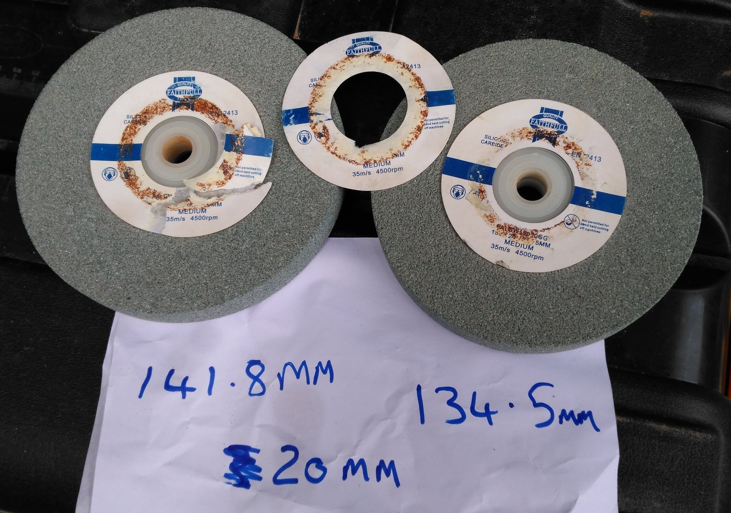

The new grinder has sillicon carbide wheels, I noticed these are really soft and need constant dressing if Im grinding steel. Should I swap over my spare aluminium oxide wheels as most of my grinding is steel?
Or is the wheel wearing just a feature of the higher powered grinder, vs the little silverline I had before?
I was after a finer wheel than the normal p60. Im guessing this p120 would not last long on steel?
https://www.amazon.co.uk/dp/B08L6RKPRP/
Sillicon carbide certainly cuts steel but it seems intended for carbide, so they are all made with a soft binder?
