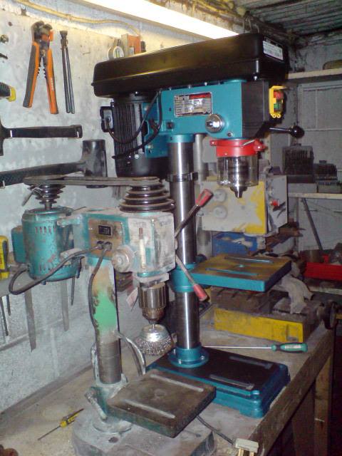

You mean, as in the drill press vice? As PDG says, clamp it differently - a fair selection of G-clamps can be your friend here.quick question guys life the thing your drilling is bigger than the clamp that opens and closes width what do you do?
