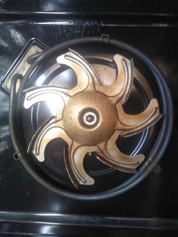

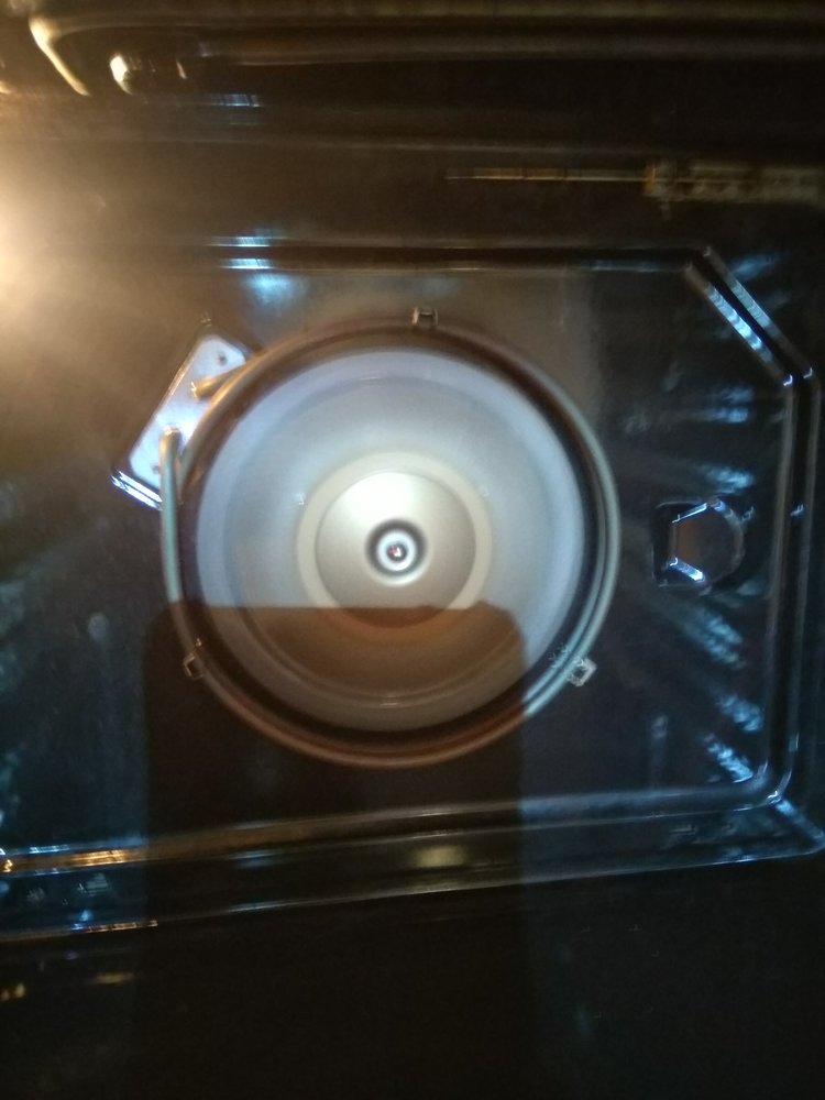

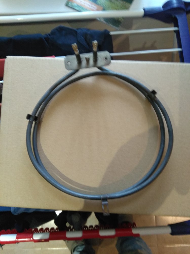

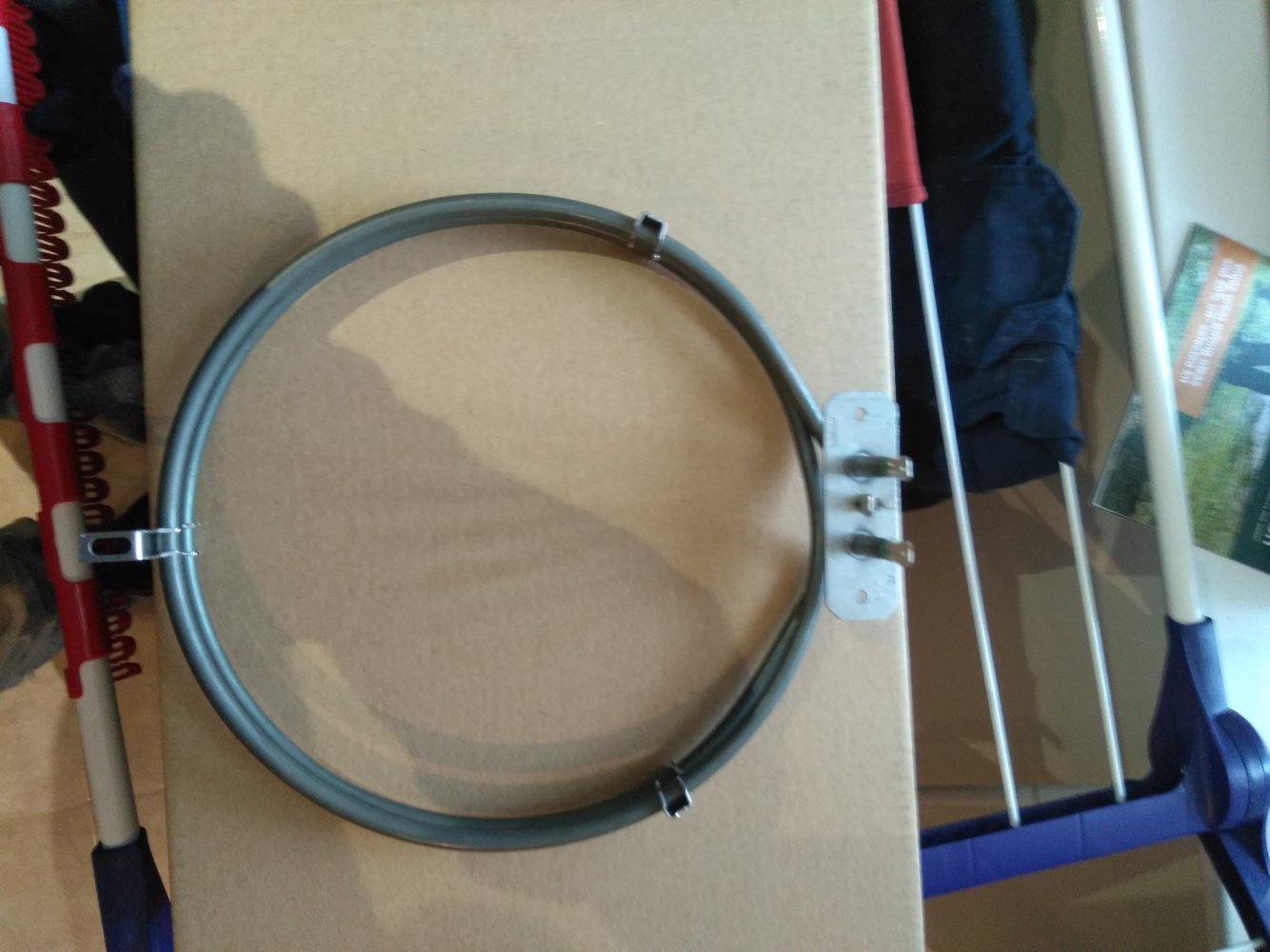

Ok so I have a beko built in fan oven , the model number doesn't come up on the beko spares website , I e mailed them and no reply . I suspect it might be supplied by Howdens as the rest of the kitchen is by them .
Anyway the problem is the fan is catching on the element that surrounds it , the metal ,"clips" aren't holding the elements which distort with the heat ,
The model number for what it's worth is OIF 22301 XR
just bend the element out a bit
