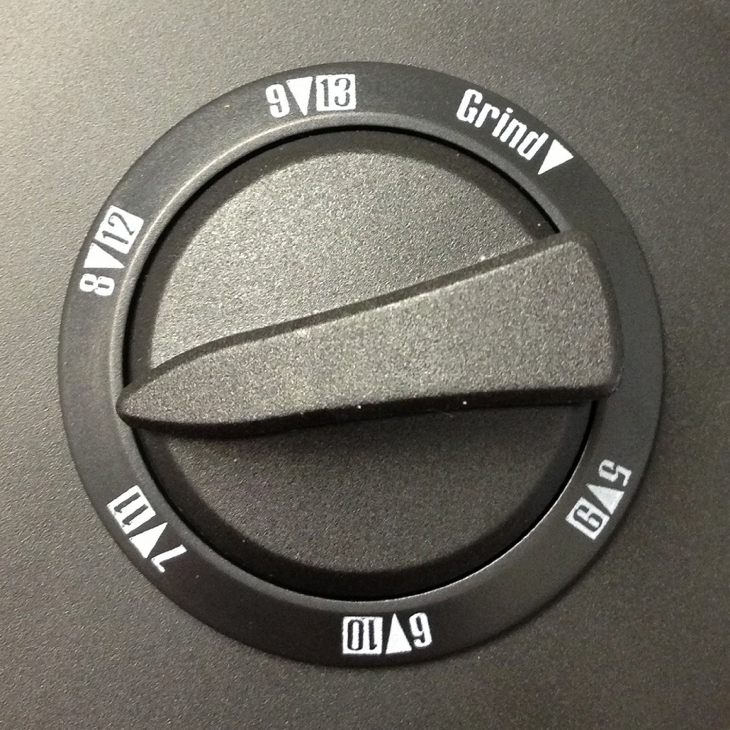

You can't set it on 9-13, you gotta choose one. Say 10, and see what happens. Either change it for 9 if you can't see the weld pool, or try 11 if it's still too bright.
Yeah, that was it. Damn thing was set on grind, I was seeing after images which always faded after a minute or two and never any headaches so I think it was dark enough to prevent any damage -- much, much better now that I've got it set on 10. Mask should come set at the highest for safety purposes, the manual doesn't mention the knob and silly me I was always looking at the inside of the helmet.
