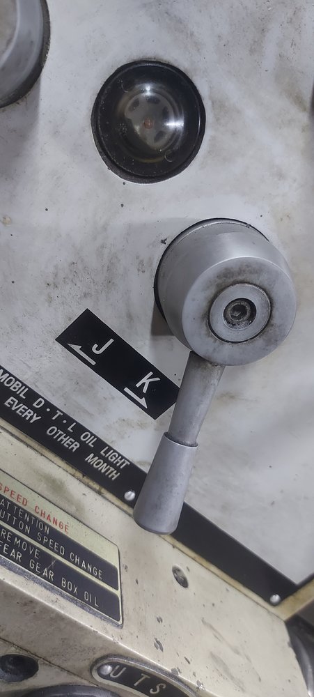

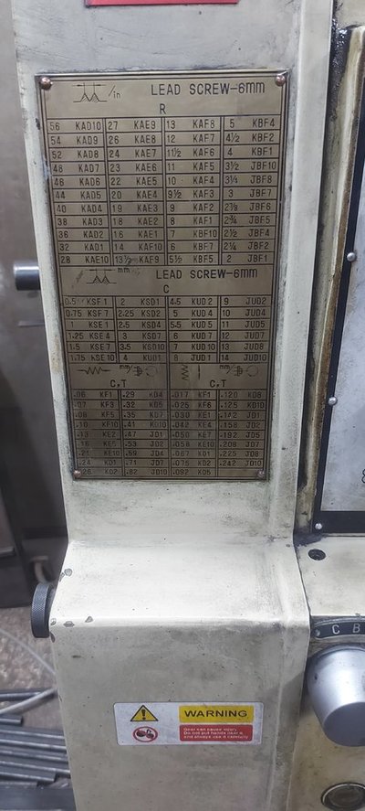

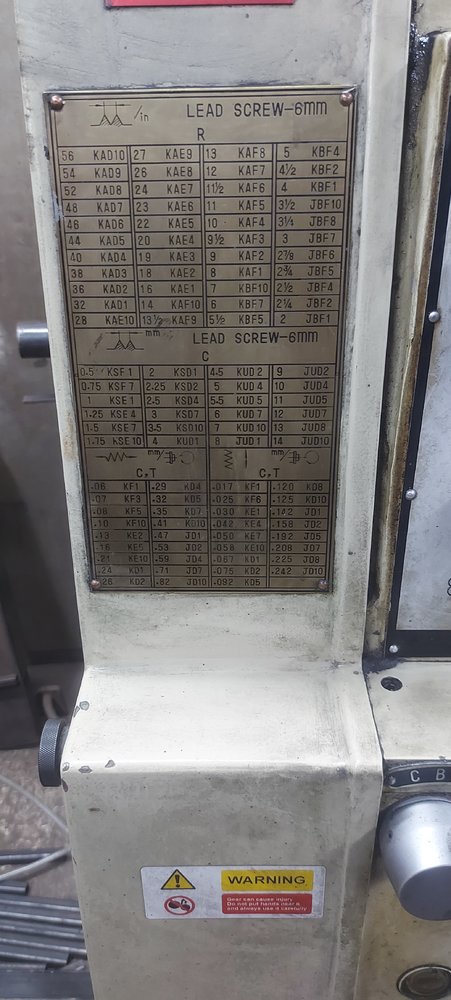

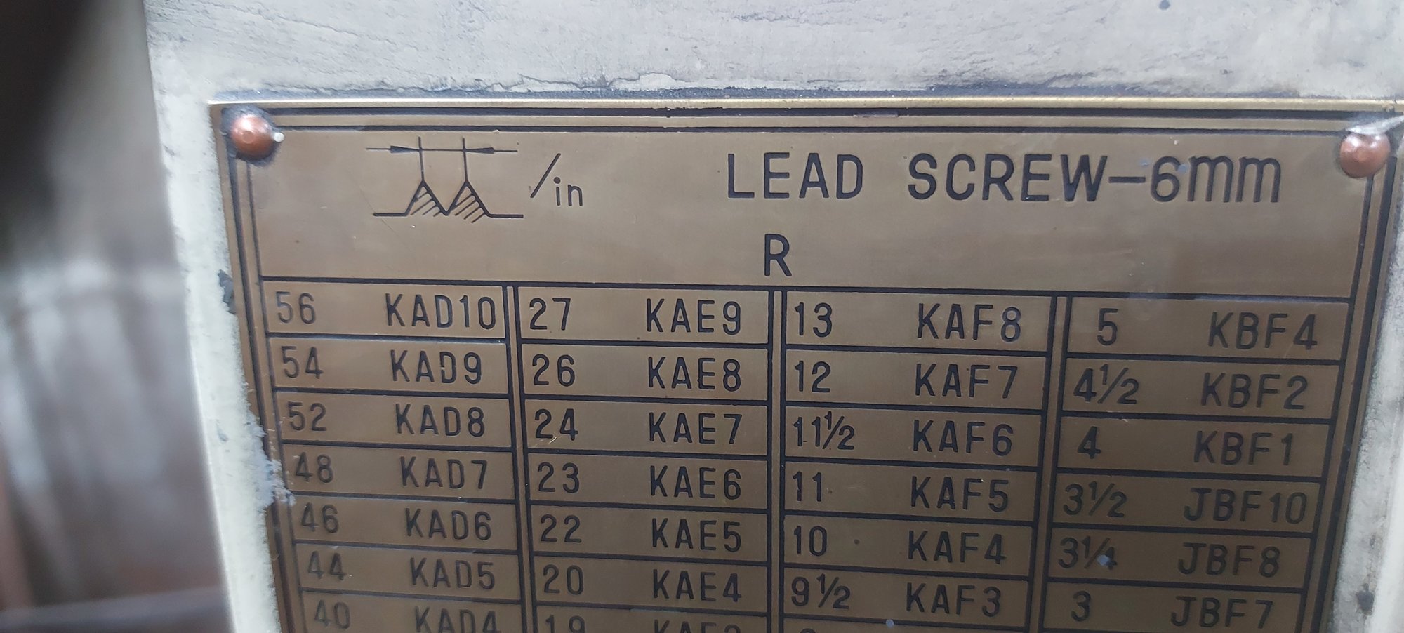

R 56 KAD10 , levers are set to those , where is the 56 ?
Made me laugh…..The bit that goes from 0.5 to 14 is your metric threads.
The bits below that are your longitudinal (LHS of table) and cross feeds.
*Does it have a setting for FCK U ?*

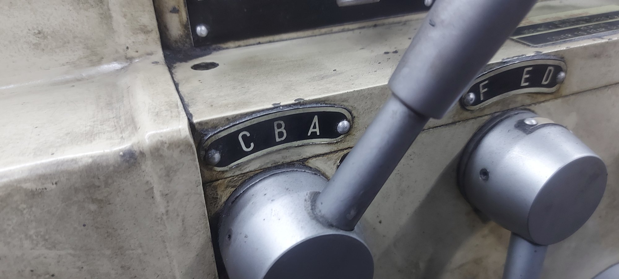

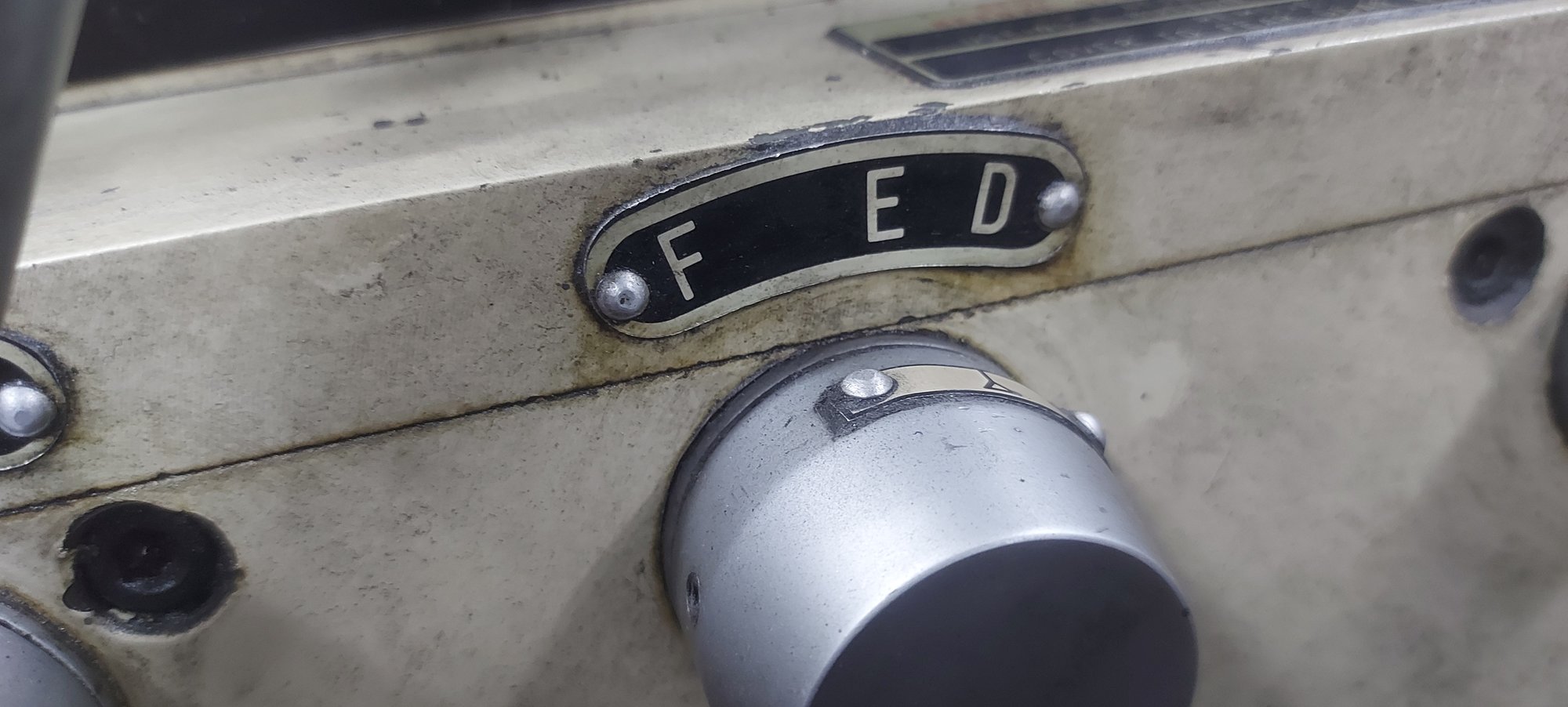

56 is 56 tpi (threads per inch). Others follow a similar pattern.
You can work out the logic of the levers (what cogs they move) by halving or doubling the tpi. Look at 2 tpi and 4 tpi and the difference is J or K.
For all the Chinese machinery knockers, how many western machines will do both 11 1/2 and 19 tpi?
