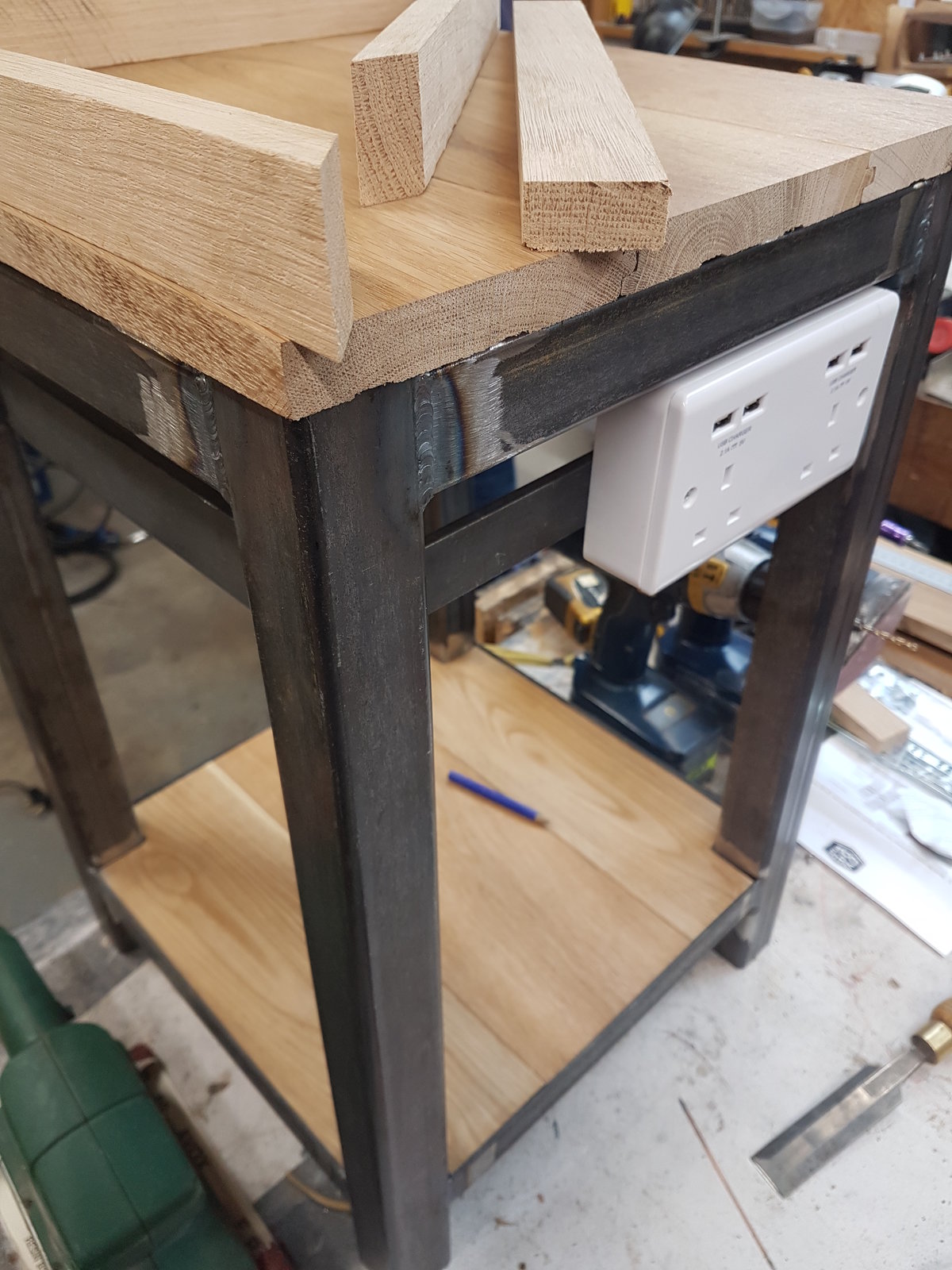

Yes, the earth is connected to the frame inside the socket boxes. The body of the lamps are also earthed on the inside.Nice work!
Have you connected an earth wire to the framework though?
More edging and some electrics. Because I'm an idiot I bought an unswitched socket, so had to do a bit of a redesign and add a switch.View attachment 169895
You're right, it's rated to 10a, not 13. I intended to use a switched socket. If I sell them I'll have to alter things but since it's just me using it and the only things that will be plugged in are a lamp and a Google home mini or phone/tablet/kindle charger it will be fine for my use..I'm not trying to be a H&S nanny, is that switch rated for those sockets? It looks like a lamp cord switch and they have a fairly low current rating.
