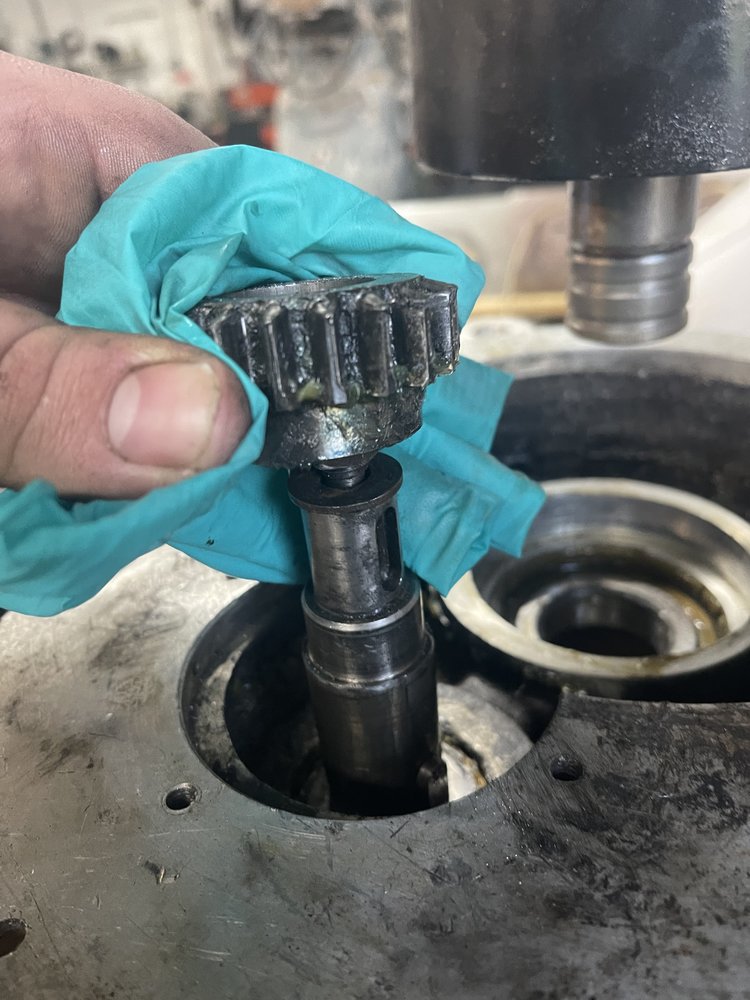

I think it's too deep mate. Might be worth giving it a tickle so it's a bit flatter thoughPlaner job

It's had a lot of use, in one section of the table.Other than the table and the few abused bits that looks like it has the potential to be a really nice machine - never seen one with the frosting still intact.
It can't have had a lot of use.

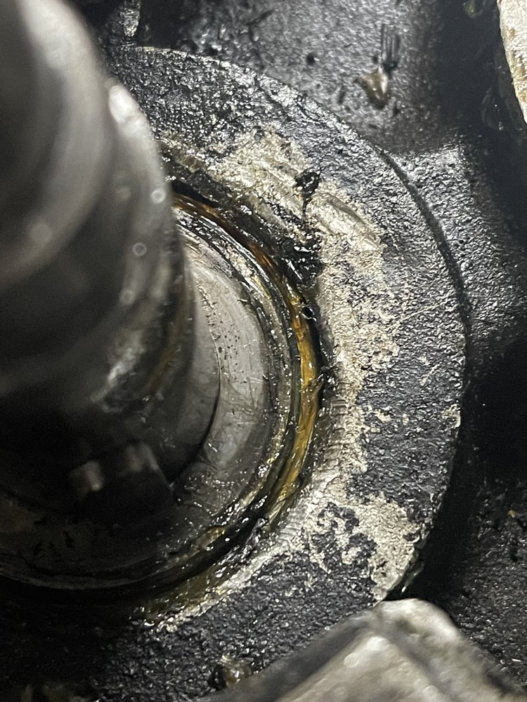

and you don't want a nasty crack in your beaver do you!Lol at the grease build up, BTDT. Nasty crack starting on the head housing.
No chance of getting a file in there. It's a pocket down in a bore.If it's just pry marks just run a flat file across it. Less chance of changing the geometry.
Out of interest why have you stripped it down? Was there noticable wear, was the noise the quill spline sloppy?
