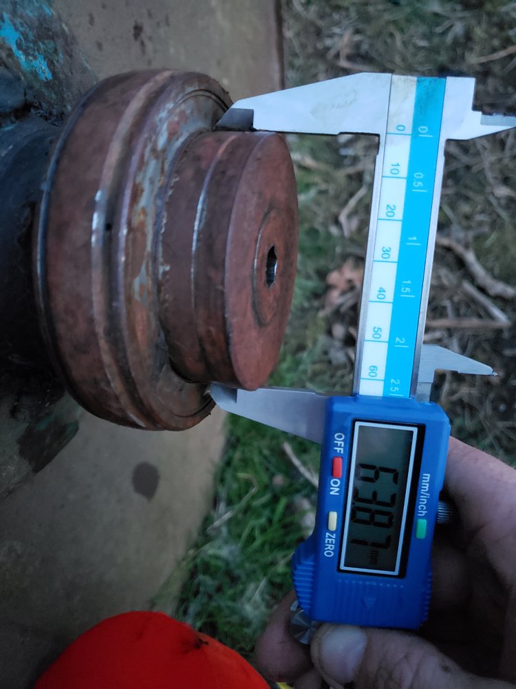

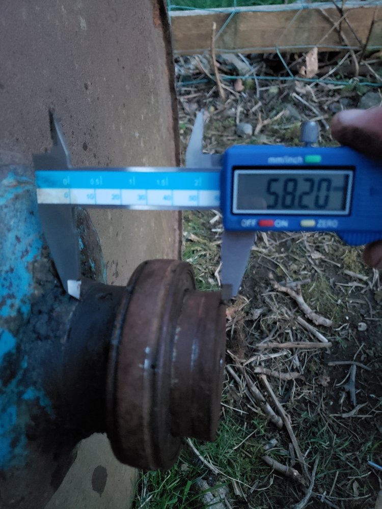

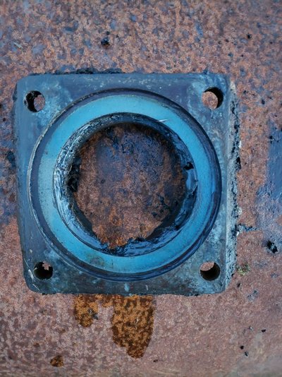

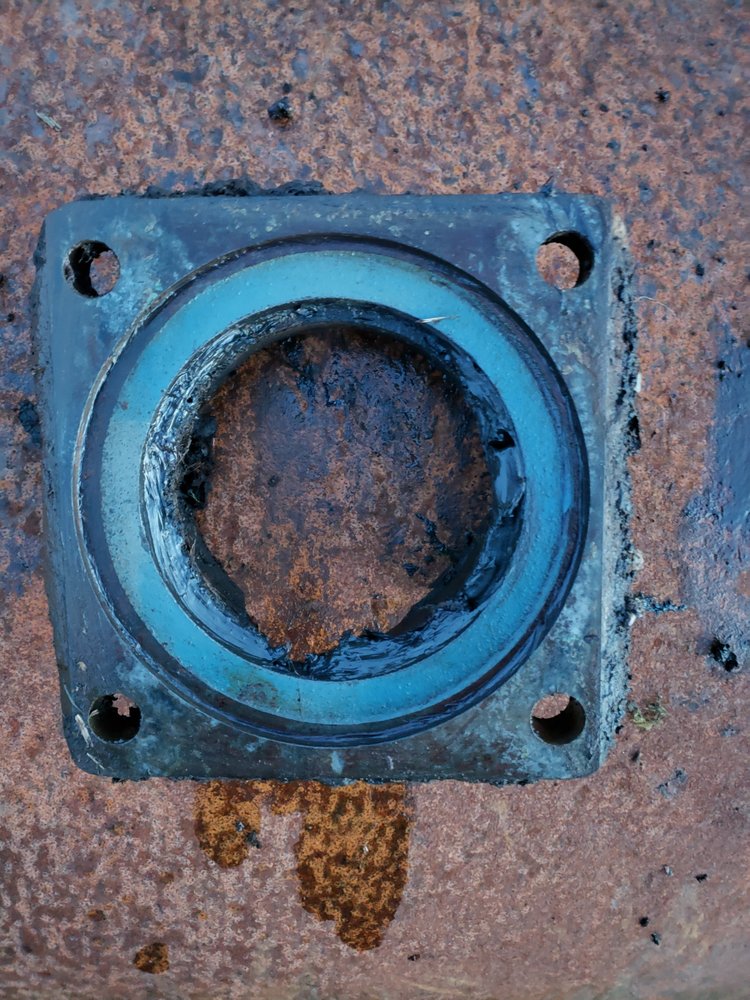

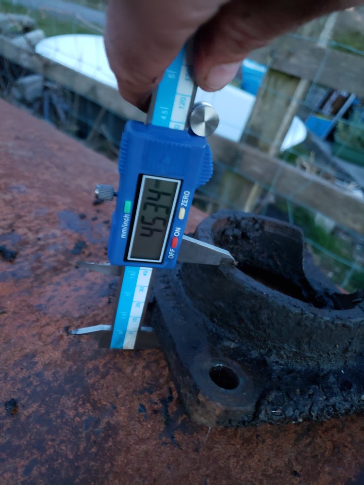

Been asked to make up a part for a grass roller which has thrown a bearing, and then sheared the mounting off the A frame. Making up the mounting is ok, as there is another one to copy. There is also a bearing on the other side to take measurements from. However, I am more used to nice smooth bearings with sensible sizes. This one sits in a groove on an "axle" internally and then fits into a cup attached to the A frame on the outside
Do I use the diameter of the groove as the internal diameter, or the axle? - the difference is 3.75mm in diameter, so definitely going to make a difference. The groove is not as wide as the bearing, so it isn't for the whole thing to sit into.
I also don't really know if it is going to be a metric or imperial bearing! It has an 89.75mm OD, 20mm width, and either 59.75mm or 63.5mm ID (the oddness of the numbers makes me think it is probably imperial...)
