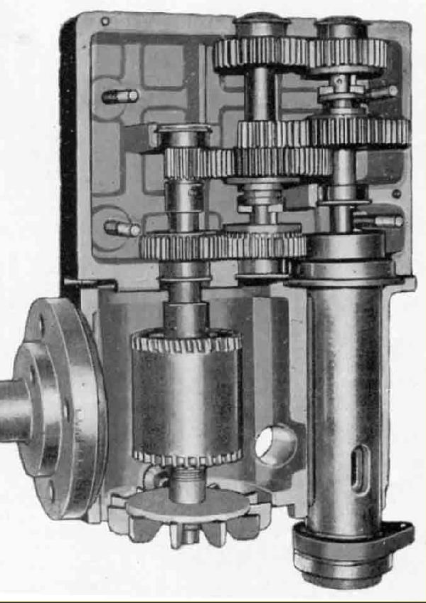

I recently got an Arboga U2508 mill (Yes, the EM825 will be up for sale soon) and there's a bit of noise coming from the front of the gearbox. (definitely front, not generalised) Nothing terrible, but a bit rattly, so I opened it up to see. There are 3 shafts; drive (motor), intermediate and output (spindle). The grease in the bearings of the latter two are the original yellow colour, but the output shaft's bearings are greyish. To my line of thinking, this is probably microscopic metal particles indicating wear. This matches up with the audible indication.
