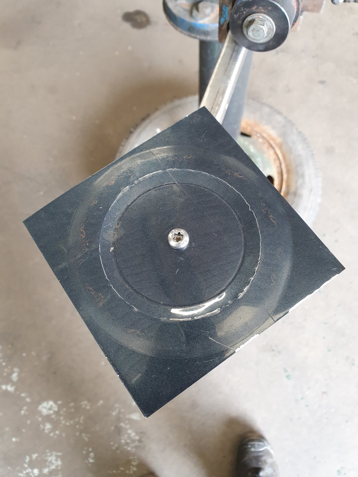

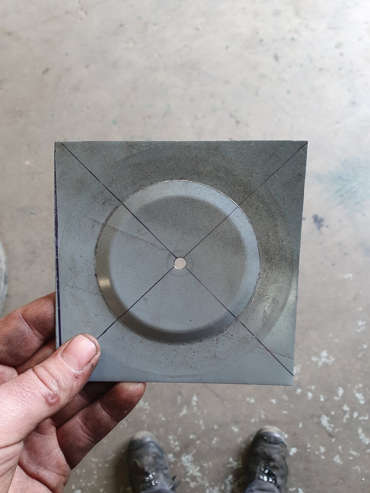

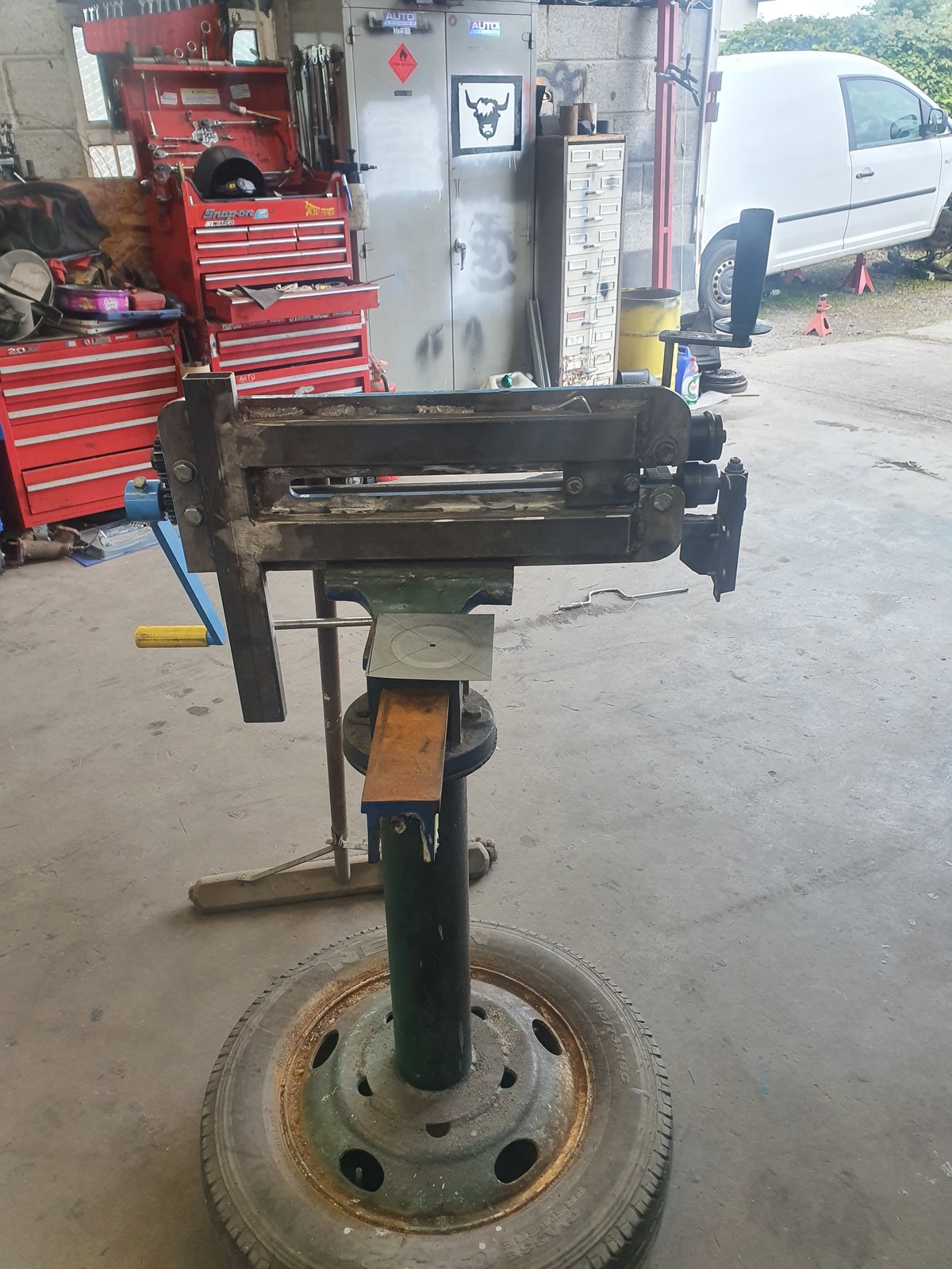

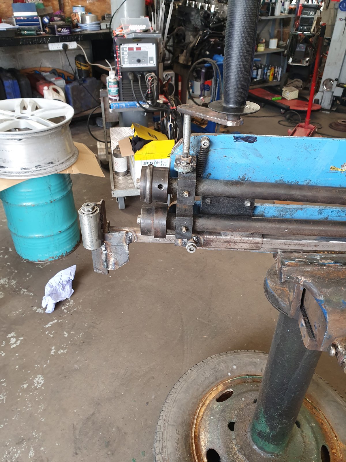

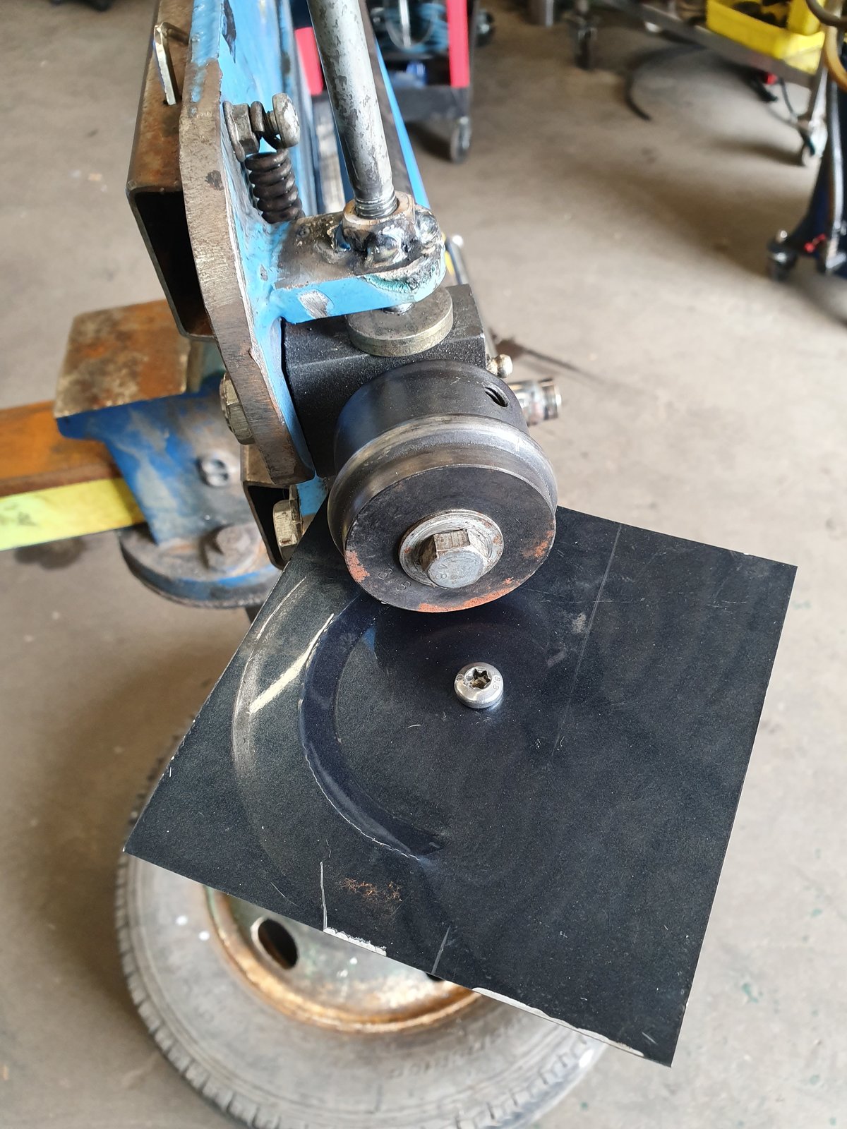

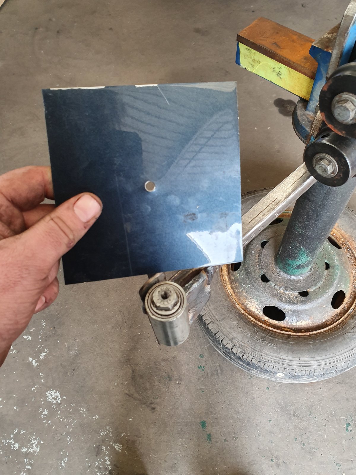

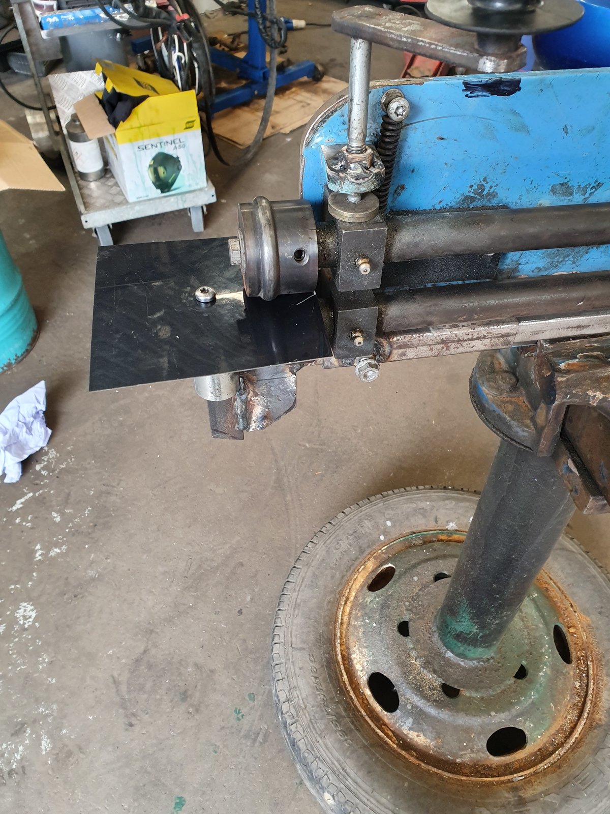

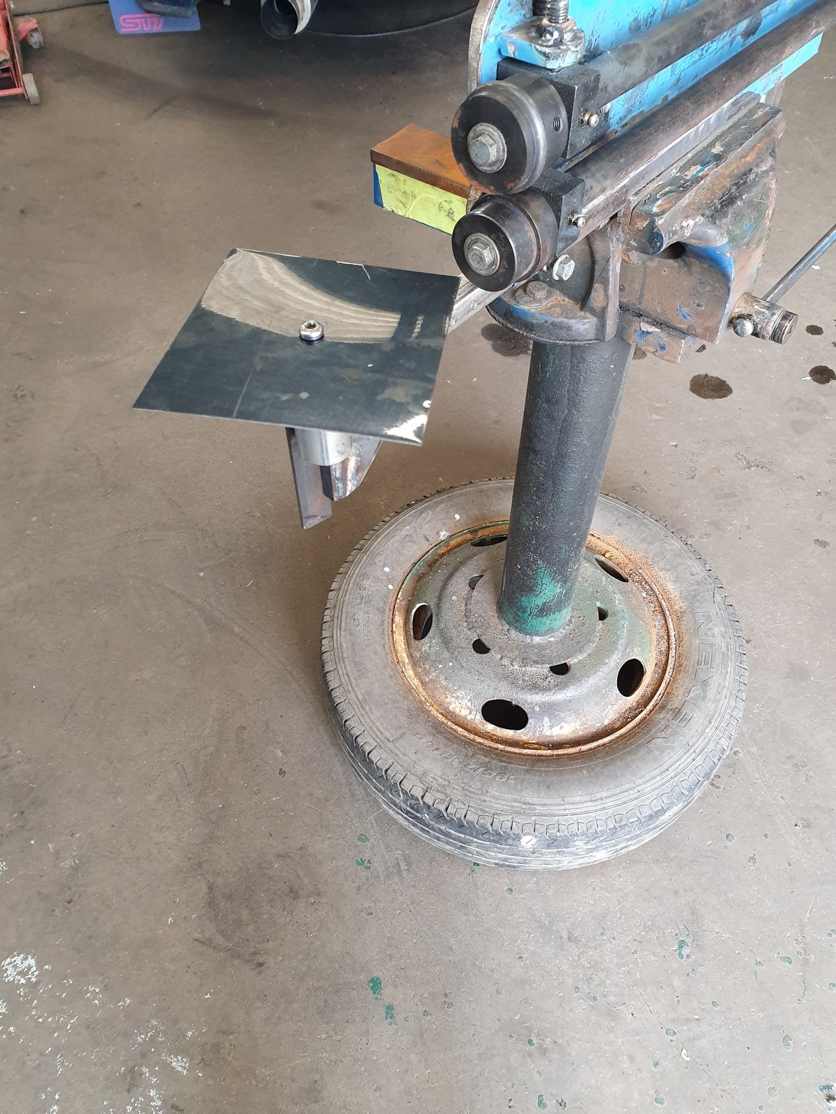

I made this circle guide for my bead roller.
The silver part is a steering pivot from an old kids quad, the hex head bolt spins on 2 bearings and has a m6 tapped hole to secure the work piece. You need to have a 6mm hole in the centre of the circle.
Then it's adjust it to the desired radius and clamp your dies and give it a few turns.
