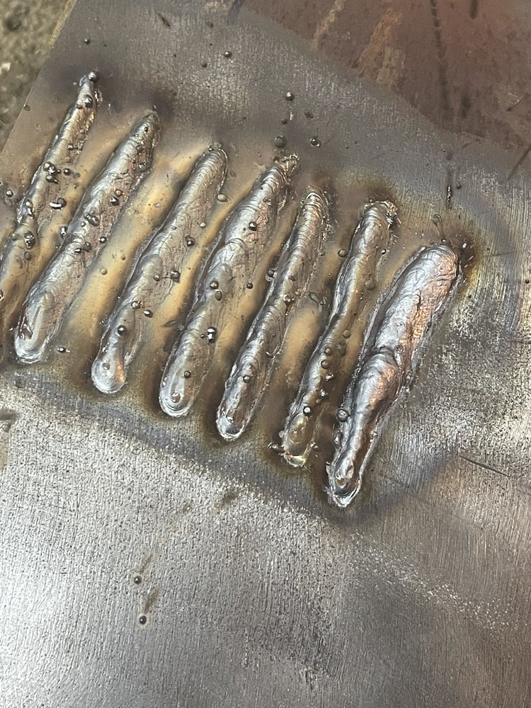

Situation update
The wire was feeding, then stopping, burning back then going again.
Running the wire without starting an arc confirmed that something was up with the wire feed. Tensioner was quite slack
Then the nut securing the wire roll was way too tight
Few quick adjustments and I now have this
My best welds ever, done on a bit of scrap from the same bottle I’m trying to weld

See getting better already.Situation update
