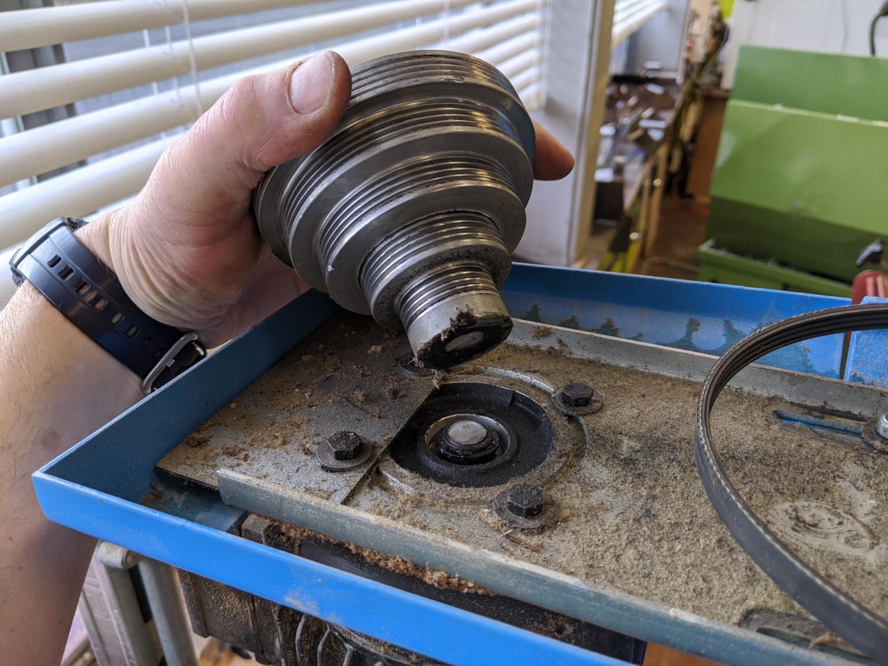

Meddings are UK manufacturers and hold a good stock of parts. @Screwdriver has it right, belt tension. They’ve started putting stickers on the new machines stating not to over tension, obviously this is what happens... You can hear when it’s over tensioned as it causes the pulley to run out of true and the whole lot vibrates.
unusual for a motor spindle to snap unless there was a flaw in the metal
