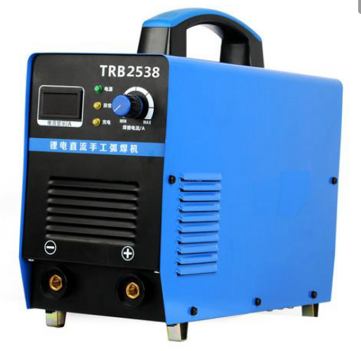

No I am not trying to advertise this, but had an email, must have been from some previous Ebay purchases, saying about a Lithium powered welder that would do 38 times 3.2mm rods on a full charge.
Specs show the batteries are 55Volt and either 26 AH or 36 AH, so to me that is 1.43KWH and 1.98KWH max output, I really would have thought you needed more then that amount of stored energy?
