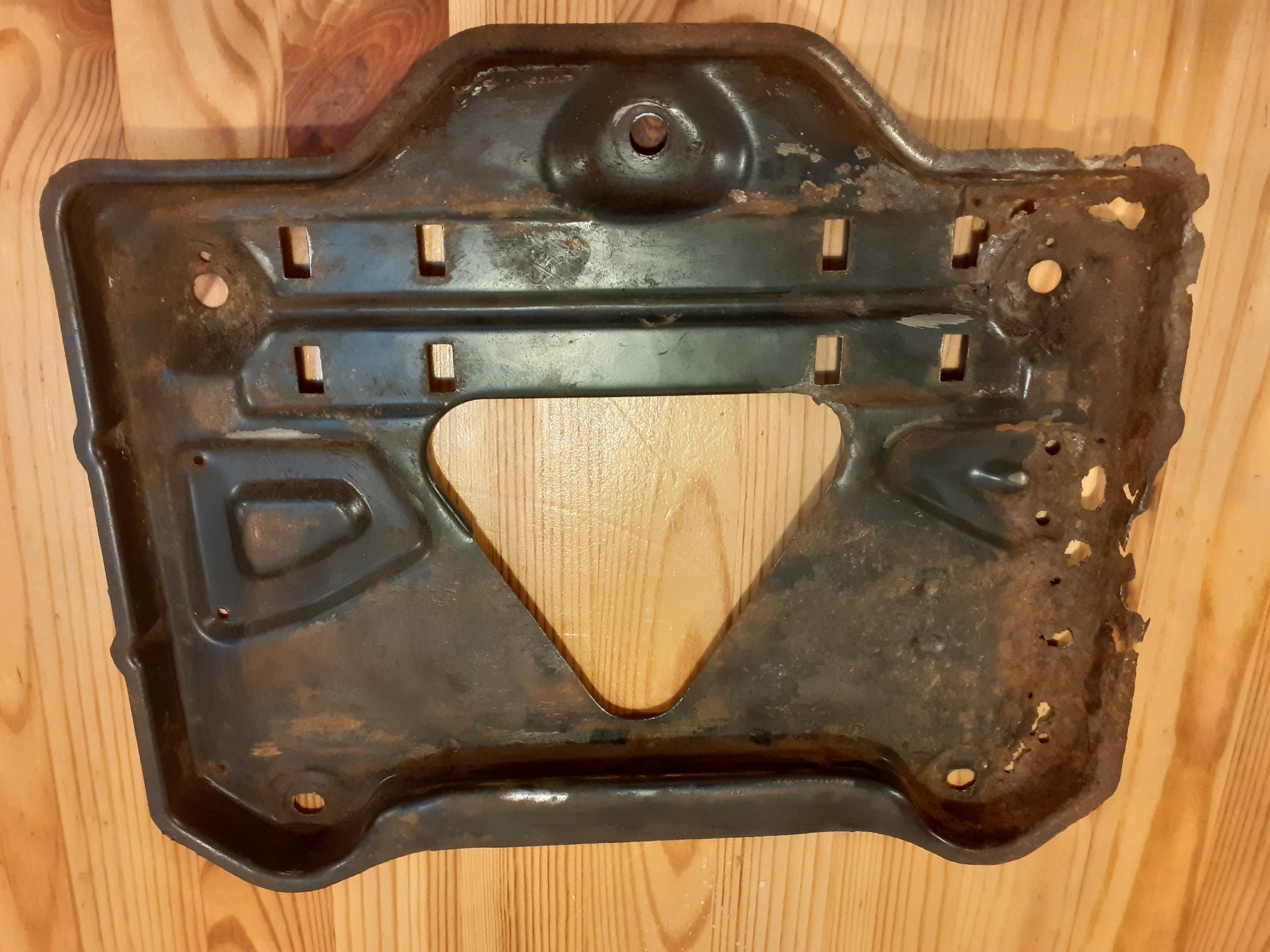

    I have this less-than-perfect battery tray and I'm wondering how feasible it is to craft a repair piece for the corroded part ?
    It's approx 1.4mm thick material with a fairly deep flange at the edge. I'd be doing it mainly to try and develop some sheet metal skills and it doesn't need to be concours ☺. I just don't want to tackle something that's way beyond do-able. Any opinions or advice gratefully received.

    cut a couple of inches off that end , make up a plate with the edges bent over to match and join it on

    I wouldn't have thought fabricating one of a similar design would be too difficult to achieve

    What I'm wondering is if the flange at the corners of the patch can be shrunk or is it more practical to cut out the excess at the corners of the patch and weld up the cuts ?

    @jgr2015 Looking at your picture its general overall condition doesn't look great?
    I would consider fabricating a whole new tray personally, Rather than repair the old one

    id try and make it up just for the giggle to see if i can
    but a look on ebay to see if you can get the same for a few bucks might be a chance ?

    Presuming we are looking at function here, bit of sheet, molegrips and a hammer.
    Battery is rectangular, add tabs for any mounting bolts not in rectangle

    It's a good question as to whether it might be easier to start from scratch rather than be patching.
    They're thankfully not impossible to get - more I'd like to learn some sheet metal skills.

    From memory the battery is squeezed into the corner next the scuttle on the 190, so going nowhere.
    Refer back to previous post, if you are looking for function for say an mot, i would bend a bit of sheet to the simplest shape and bolt in.
    You could then have your play copying the old one at your leisure

    Not quite the same but this post might give you a few pointers on making a repair piece for your battery tray.
    This was 1.2 thick if I remember and was fairly easy to work with.
    https://www.mig-welding.co.uk/forum...-from-the-brink-hopefully.81348/#post-1160068
    If you can make forms out of wood, or better still steel if your working with thicker sheet, you can make all sorts of shapes.
    I've ground shapes into plate or welded bits of scrap together to make forms.
    Steel is brilliant for the job, if you take too much off it's easy to put it back.
    With a decent form all you need is a hammer, some G clamps and a couple of blunt chisels to make that.

    You could patch it or just make a new one. The benefit of a new one is you can make it to look however you like. The trick is working out the easiest way to make it.
    Cut out a base
    Fold over an edge for the corner sections in one full length
    Tack both together at one start point
    Slot the corners so you can bend and follow the profile
    Weld the base to the edge and the slots in the corners.
    Grind the welds
    Drill some drain holes.

    I’d add a few steps in to put some shape in the base etc to look more like original but if it is his first time how complicated he wants to make it is up to him. The method I suggested would look original with a battery on it.
    If doing a repair do it in as many bits as needed to make it easy to make and weld together would be my advice.
    You will learn techniques and tricks as you go along but the best advice I will give you is keep it as simple as you can when making something, think of the easiest way to make it that will turn out how you want, don’t over complicate things.
