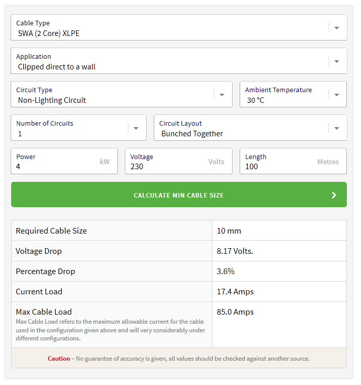

so what was the input current rating on the machineMy old Rehm was specced in the manual.
"Will run off 100mtr extension cable from a 13amp supply with no current losses".
I've never tried it but these modern machines can do wonders nowadays. (So they claim).
then we can calculate the voltage drop and cable conductor size required at that length even if it is 13 ampit means a lot to me. the machine must have an input load to calculate the cable csa over 100 meters, yes it can be done but your not going to do it with a bit of 2.5mm leadWell it's rated at a max of 16 amp fuse.

I'm not a sparky so I cannot speak for anything other than what I read about it and what seems logical to me.it means a lot to me. the machine must have an input load to calculate the cable csa over 100 meters, yes it can be done but your not going to do it with a bit of 2.5mm lead
il not bother arguing about voltage drop and cable size u know better il leave it at thatI'm not a sparky so I cannot speak for anything other than what I read about it and what seems logical to me.

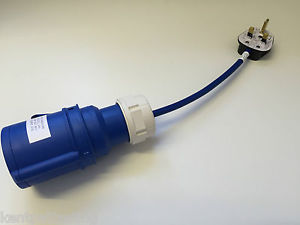

The thing is Rehm state 100m off a 13amp plug no current losses.
You say 2.5mm cable no chance. Well I would say they probably can because you can't physically fit a bigger cable than 2.5mm2 in a 13 amp plug. I'm sure they would of tested this feature before making a bold claim. Inverter technology these days brightspark. I would even hazard a guess that Fronius and ewm claim similar things. These are not Micky mouse companies. These claims will of been tested and proved.

Logically you couldn't get 10mm or even 4mm 2 cable in a 13amp plug.
Either these companies are telling some big porky pies or they have achieved something in development.
