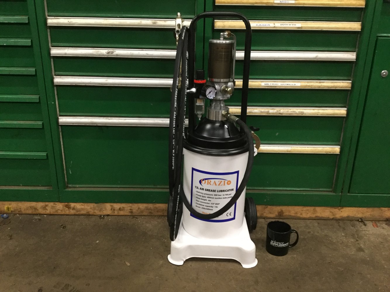

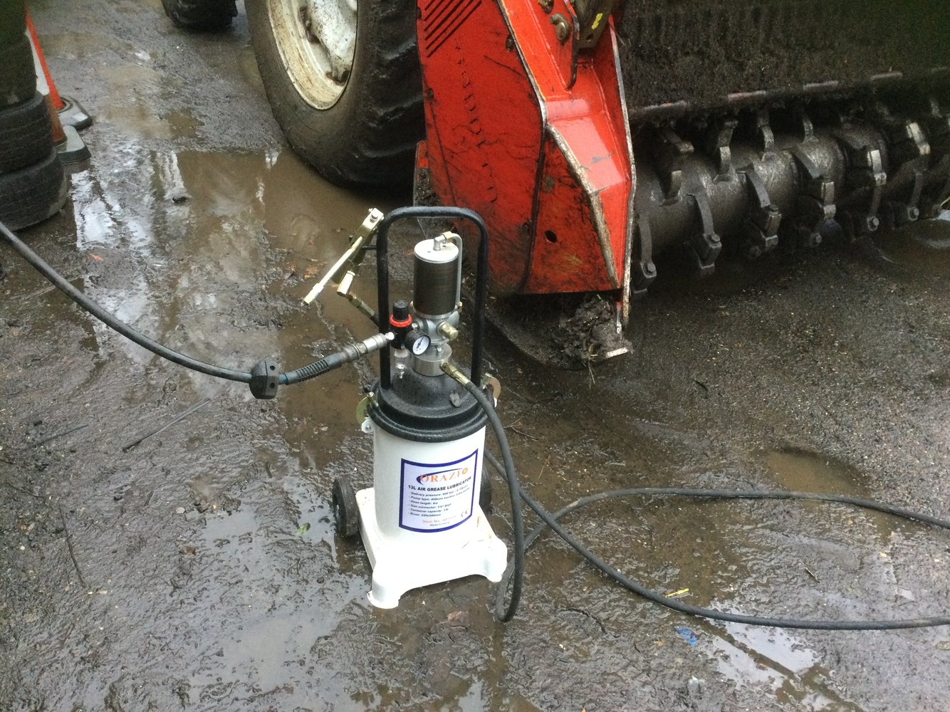

Mine clicks with every pump but worried now because clicks don't seem as loud.Right I striped down the check valve and thoroughly cleaned the area nothing untoward.
I then slightly stretched the check valve spring, it's back pumping.
But the gearbox clicks loudly every cycle.
But I was pleased to be able to get it running just ahead of greasing a machine
