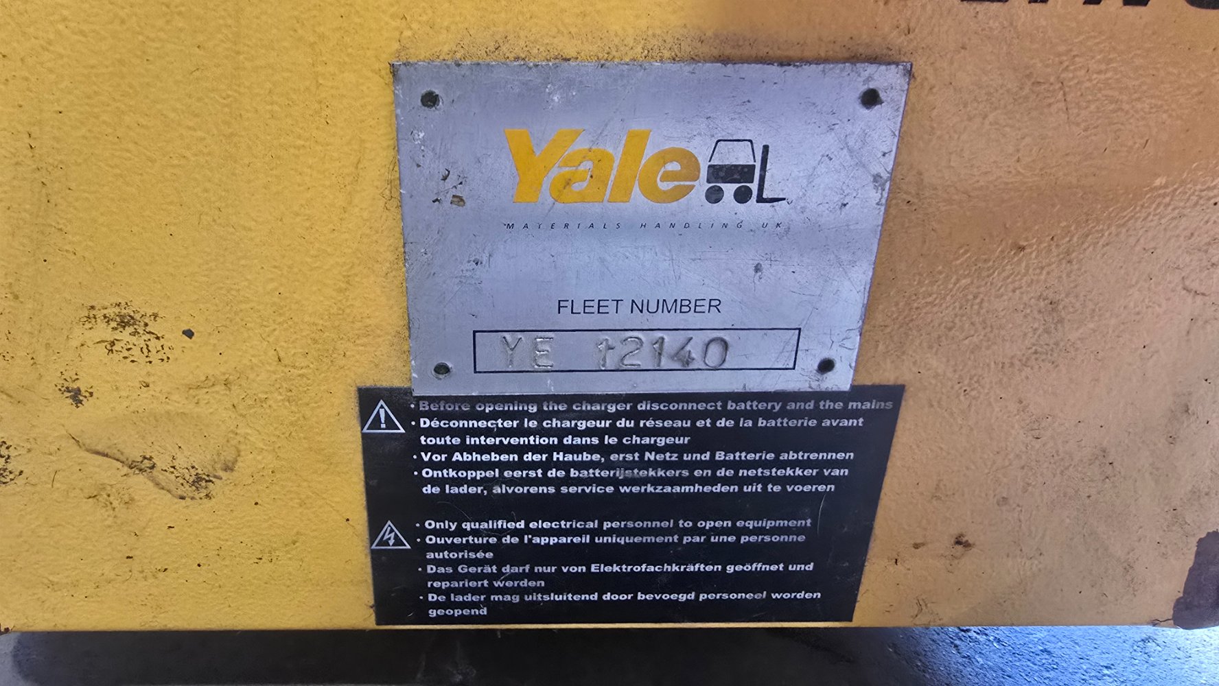

Tried ringing they called me back. Will get an engineer to pop in. I warned them I am broke they said never mindRichmand Services (with an a). Think they are Newport based

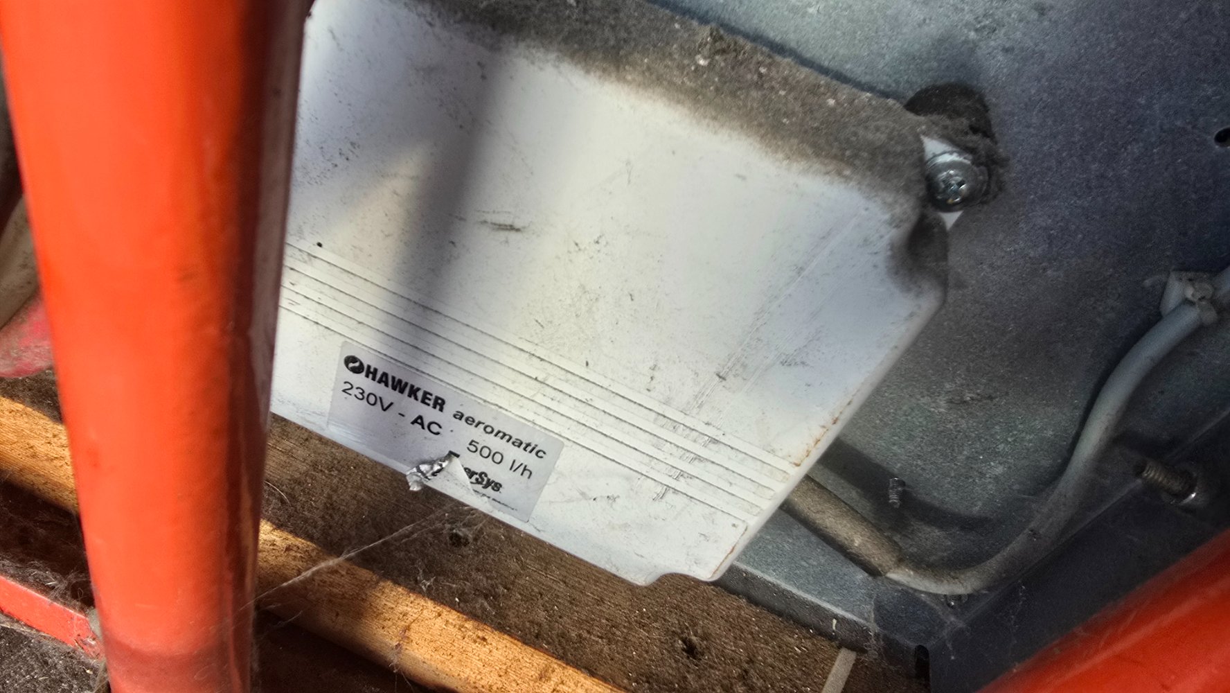

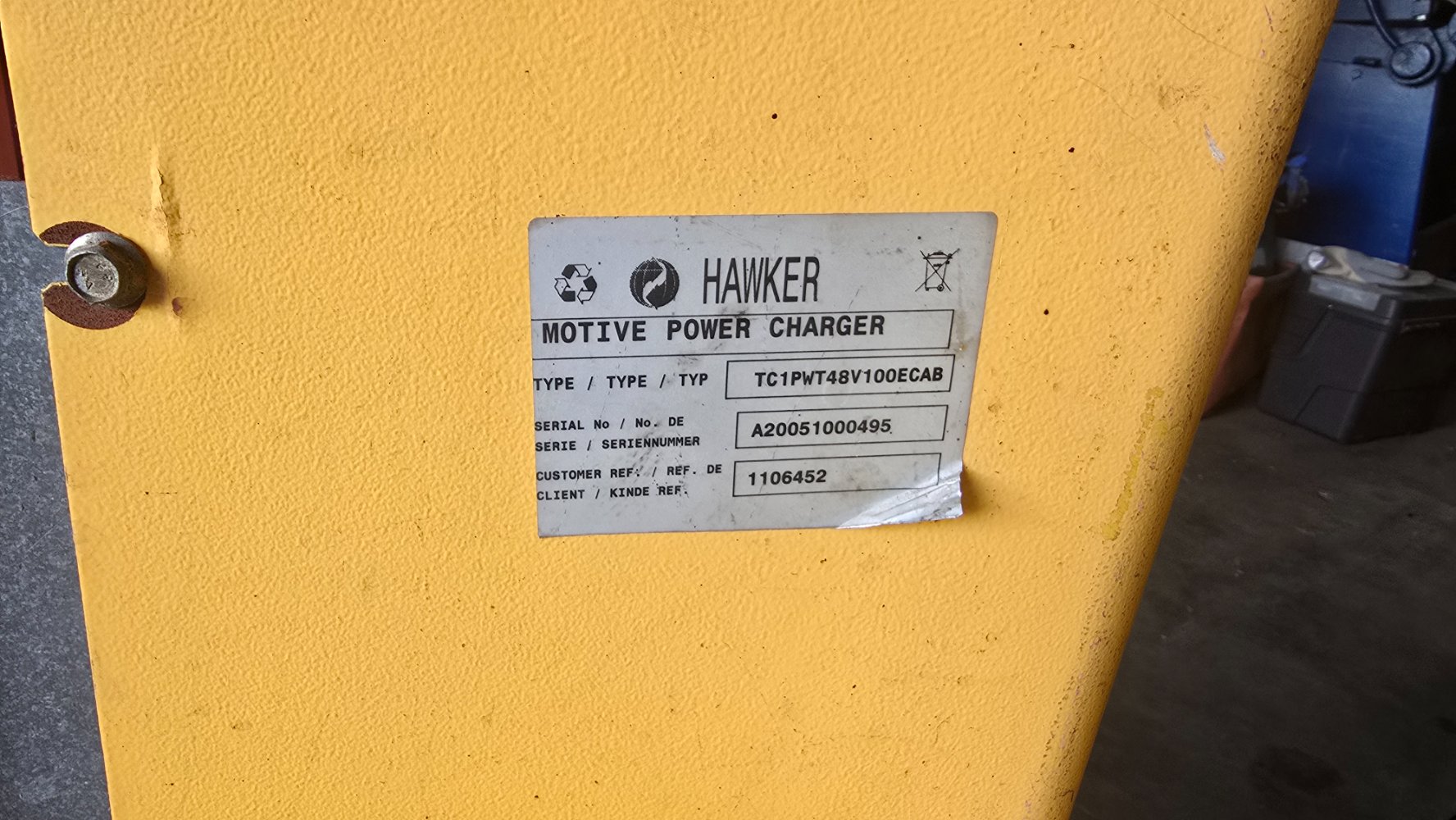

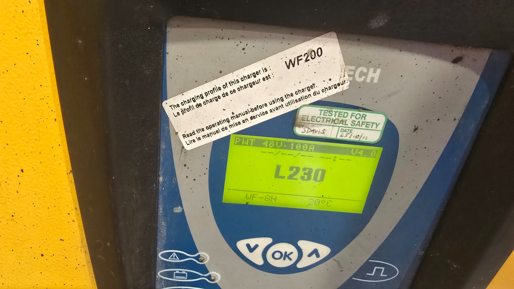

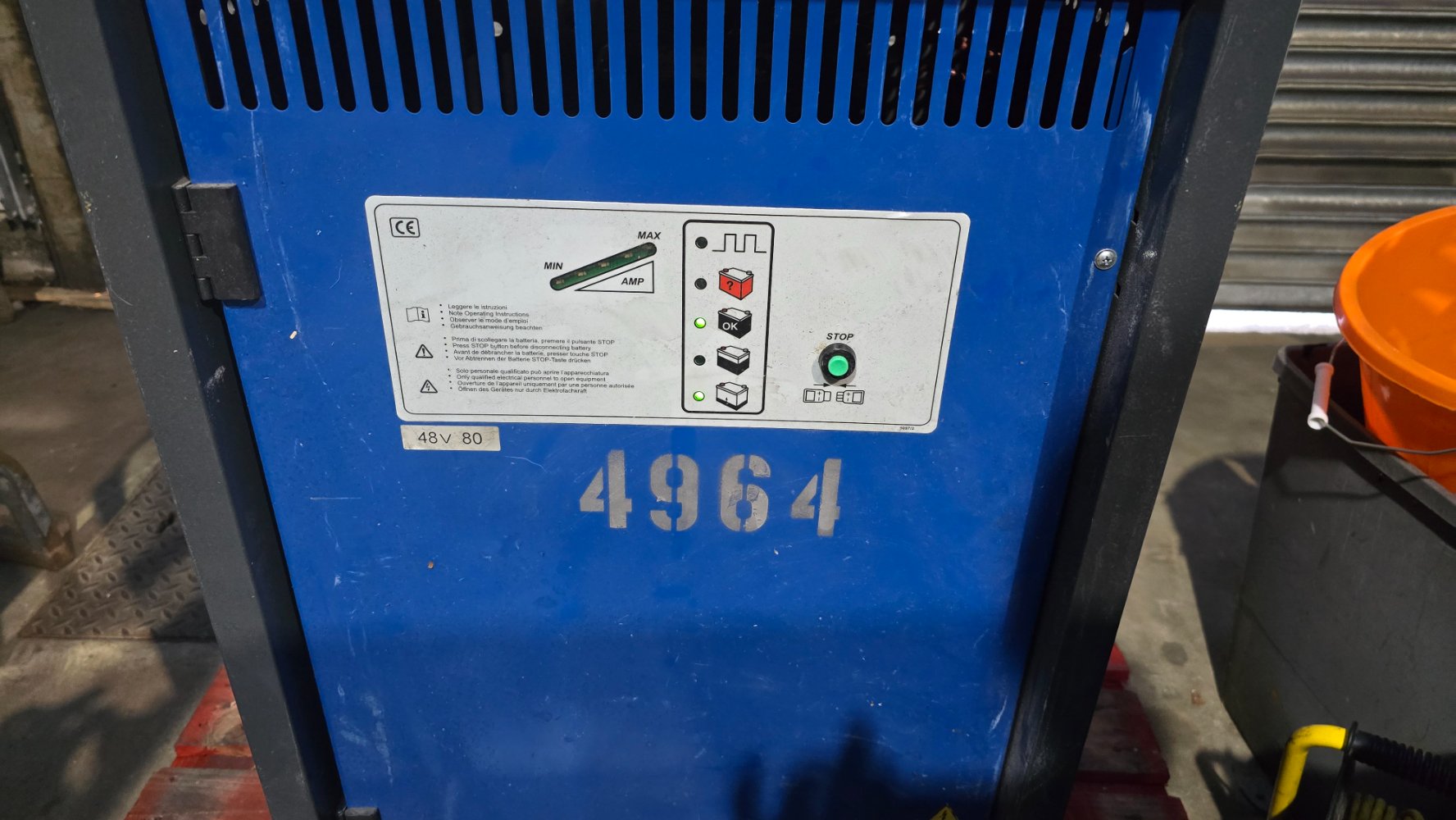

.Well it was fine for years. Not a lot of use mind. Say 1 charge every 3 months. Cells bubbling like crazy but never had to top them up. Until now.if the batteries haven't needed filling then they defiantly haven't been charging properly
No but never let the batteries drop be4low 20% charge.the batteries were probably slowly dying, just didn't use it enough to notice
do you leave them on the charger? best to leave it plugged in when you're not using it, charger should keep them at float voltage

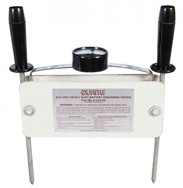

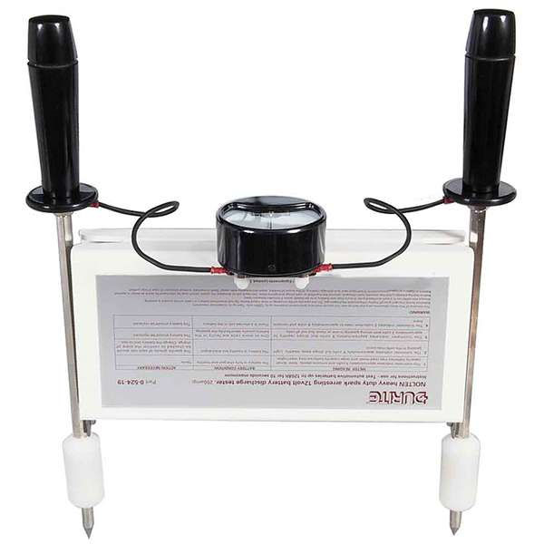

Thanks for that. Voltages all checked. Will dig out the hydrometer next.Fizzy, my method for testing traction batteries:-
1. Top up and fully charge the batteries overnight and allow battery to degas/settle.
2. I then used to draw the layout of the battery pack, and record the 4 readings in each cell in order.
3. Check and record each cell voltage/sg reading, before the "on load" test.
4. Now check and record the cell voltages on full load (max lift/hydraulic relief pressure valve open for at least 3 to 4 seconds for each cell or until the voltage stops falling).
5. Recheck sg readings and record.
Now compare your figures:-
The "off load cell voltages" should be above 2.2+ volts (certainly 2.0) ideally after charging with an sg reading of 1280/1300 (lowest 1250)
While on load testing, cell voltage should stay about 1.8/1.9 volts, 1.6/1.7 volts absolute min, if it drops below this the cell is dead/replace.
If you have good/fair voltages, but with low sg readings, you could have the electrolyte liquid sg adjusted/replaced, which would help depending on the other readings for that cell.
show these figures to the battery tech....
Depending on the latest specs used for lead cell technology (I've been out of this side of the game for several years), this will give you a good basic idea of where your battery is condition wise.

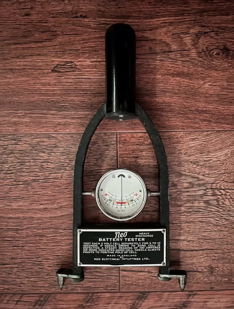

Use a decent one.....Will dig out the hydrometer next.
