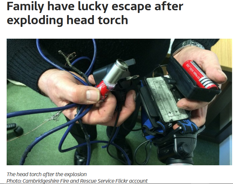

most led torches are supplied with the AA cartridge or the adapter for a single 3.7v cell...Just beware that things like torches, particularly head torches are mainly designed to work with low power batteries, for example dry cells, Duracell etc and as such don't really have much by way of circuit protection in them. If you substitute the low power battery with a high power li-ion battery the cell is capable of generating huge currents, more than enough to melt the wires connecting the cell pack to the torch unit. If that happens when its on your head it will smart.
Its just something else to think about when modifying the design as well as the longer run time.

fook that i am leaving the 3 aaas in the head torches then
Been using the 18650 batteries in torches and head torches for a few years now, never had any issues. Bought a cheap dive torch off the bay( I don't dive, live in soggy Argyll) it works with three AAA batteries. Fit a 18650 ino and it works just the same, no heat coming from any where it's not meant to
do they last longer than 3aaa's? do they alos just stop working when a charge is needed or do they run dimmer and dimmer like the standard AAAs
