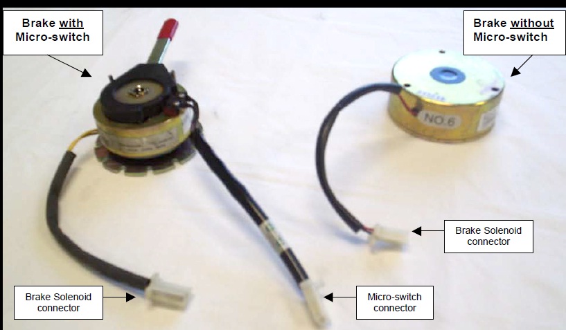

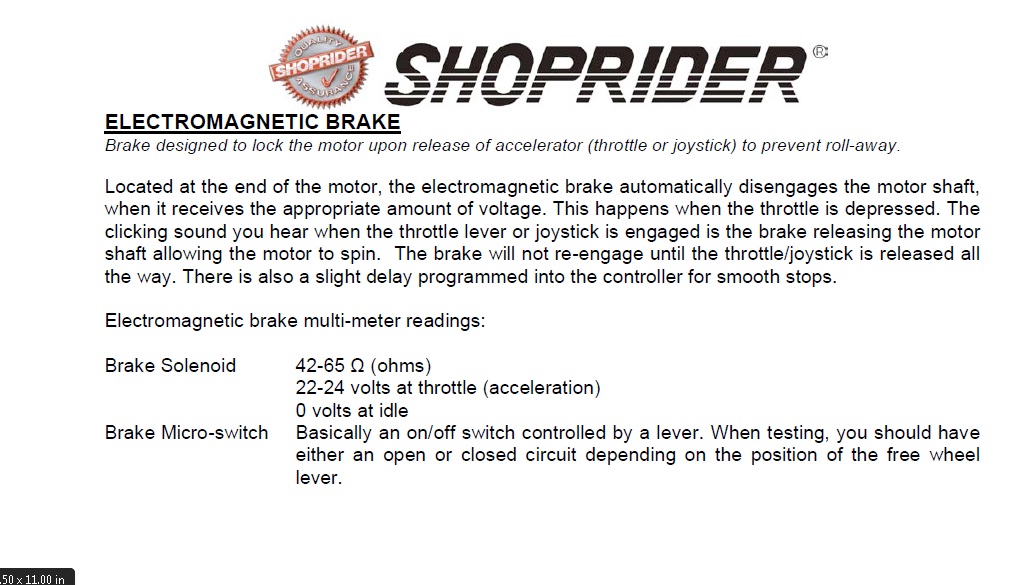

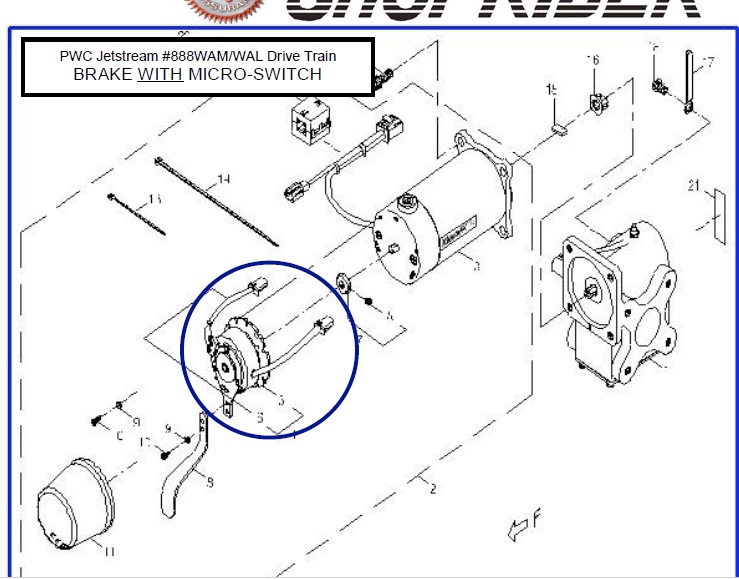

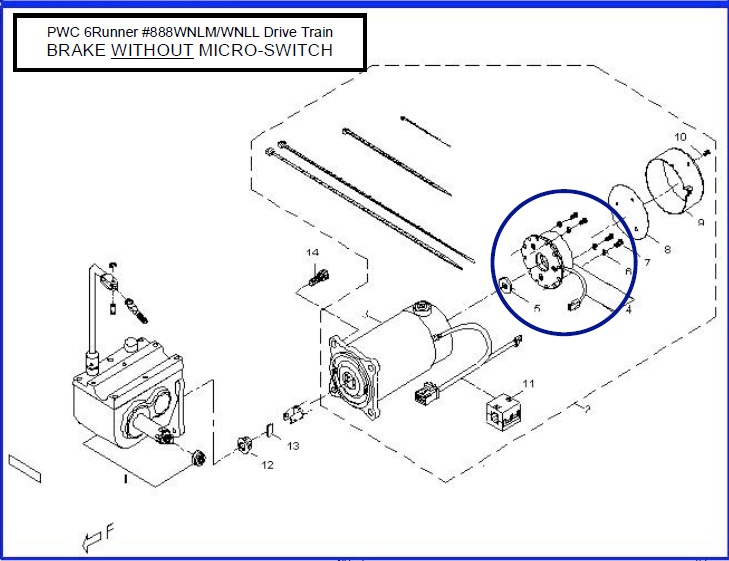

Normally the brakes are held off by a voltage. If the volts to the brakes, braking relay fails the brakes are applied.Interesting, How does this work, because the owner said that it applied the brake when it died and wouldn't release?
It is a safety feature.
