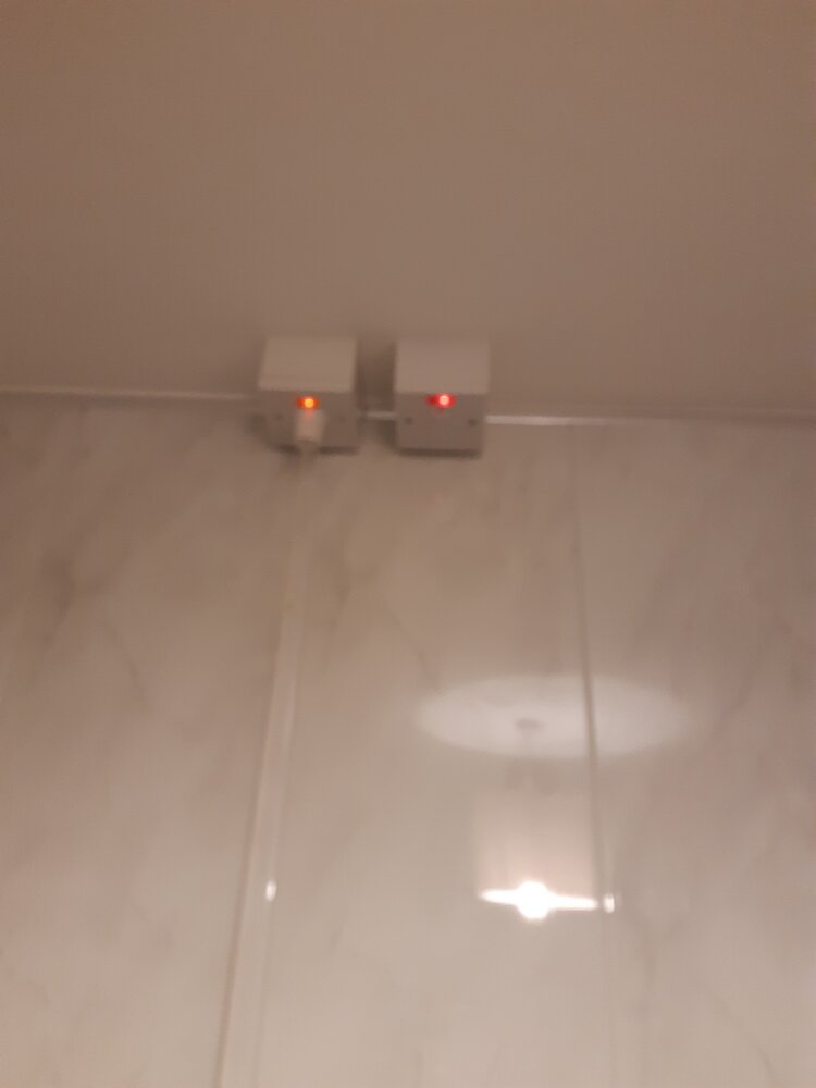

Hi chaps, particularly the sparkies,
I'm currently having a replacement en suite installed and my bathroom fitter has just come out with something that has me a little confused. He says I should have an isolation switch for the extractor fan?
It's just a regular inline extractor fan with timer, mounted in the attic, drawing out of the ceiling. Does it need an isolator?
but id fit one no matter what . its a silly reg not needing one on same floor but there you go
