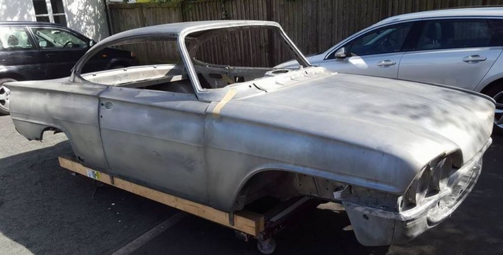

Hi Rob,
Time is of the essence now, i f you haven't got spray facilities then brush and roll epoxy on, I wouldn't worry about the finish at the mo, as the first couple of coats end up as dust when you start to prep it.
Nice job of the strip, who did it, can you discuss costs and waiting times?
Cheers
Martin
Enviro Strip Tamworth did the job, You'll have to contact them re cost as it varies on shell type and what processes you want done. I got a bit of a discount as I did some of promotion for them at the Resto Show at the NEC. Waiting time also varies a lot dependant upon time of year.
Ive had two C Capris done by them just a few months apart, I would recommend the Pyrolosis process as it does not involve a caustic dip which can sit in the seams and leach out after the car has been repainted.
