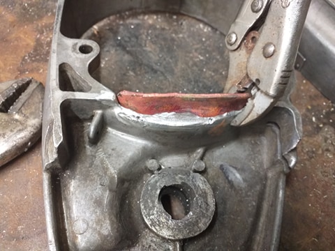

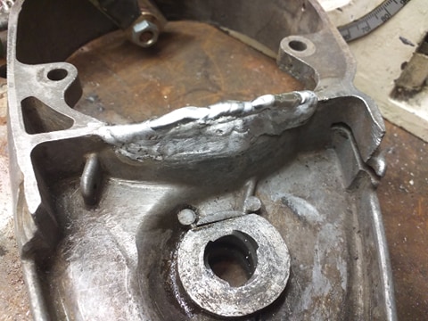

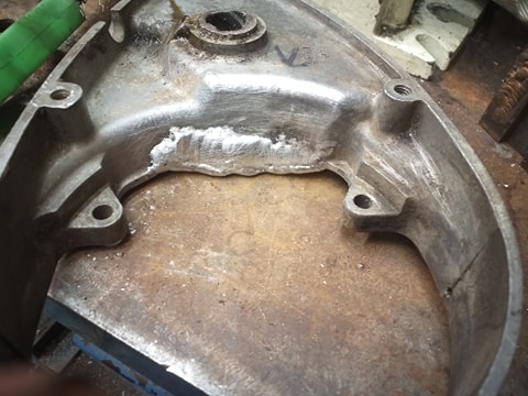

Finished the last one today
Yes thick copper works very wellIs that a piece of copper you are using as backing? Looks like a good repair.
looks like it i am not in to old bikes just weld up casingsWorm drive for the clutch?
