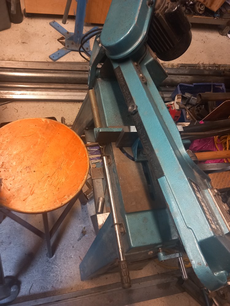

Before I would go adjusting, I would get a new fresh blade, as the blade you have been using might be dull (from rubbing & not cutting)Thanks folks, turns out all it needed was tha weight adjusted. Twist the pressure off the spring!

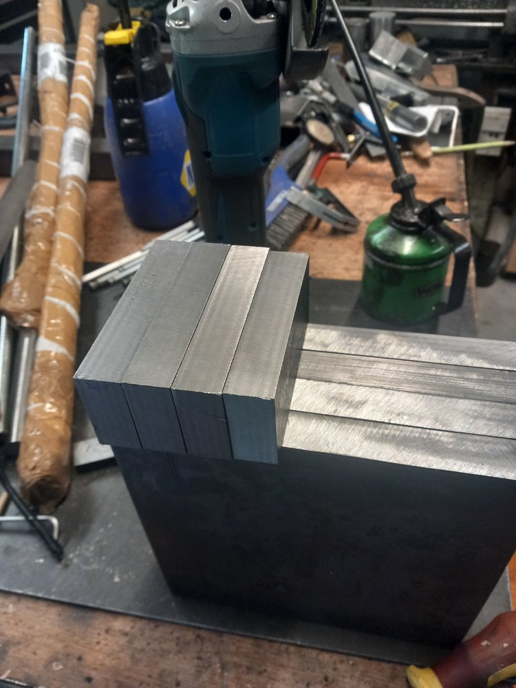

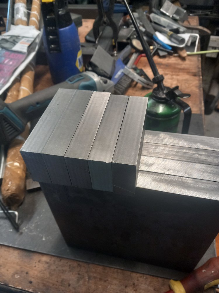

Still a mill off square, is that acceptable or could it be adjusted too? Cheers
and may cut off to one side.
