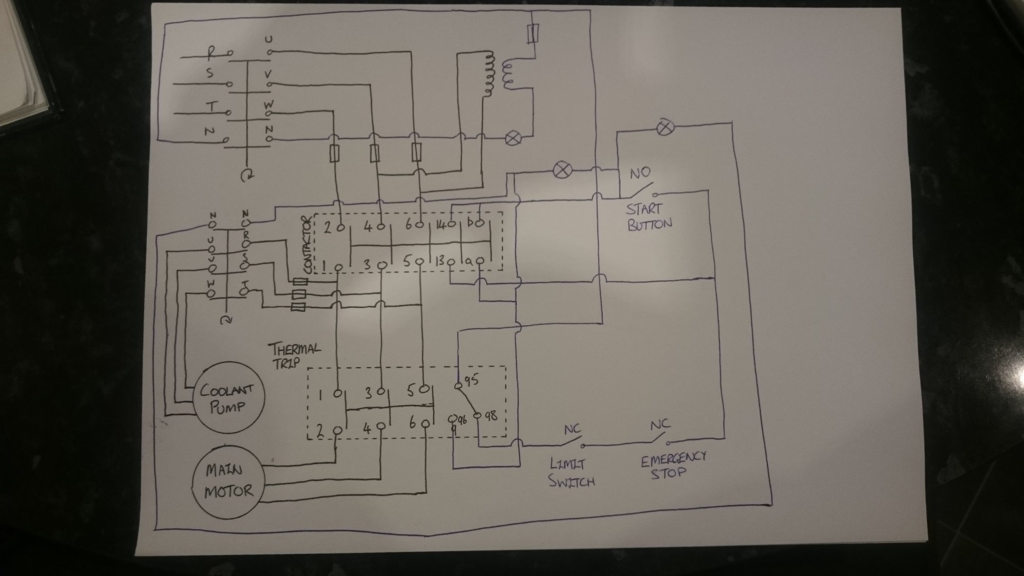

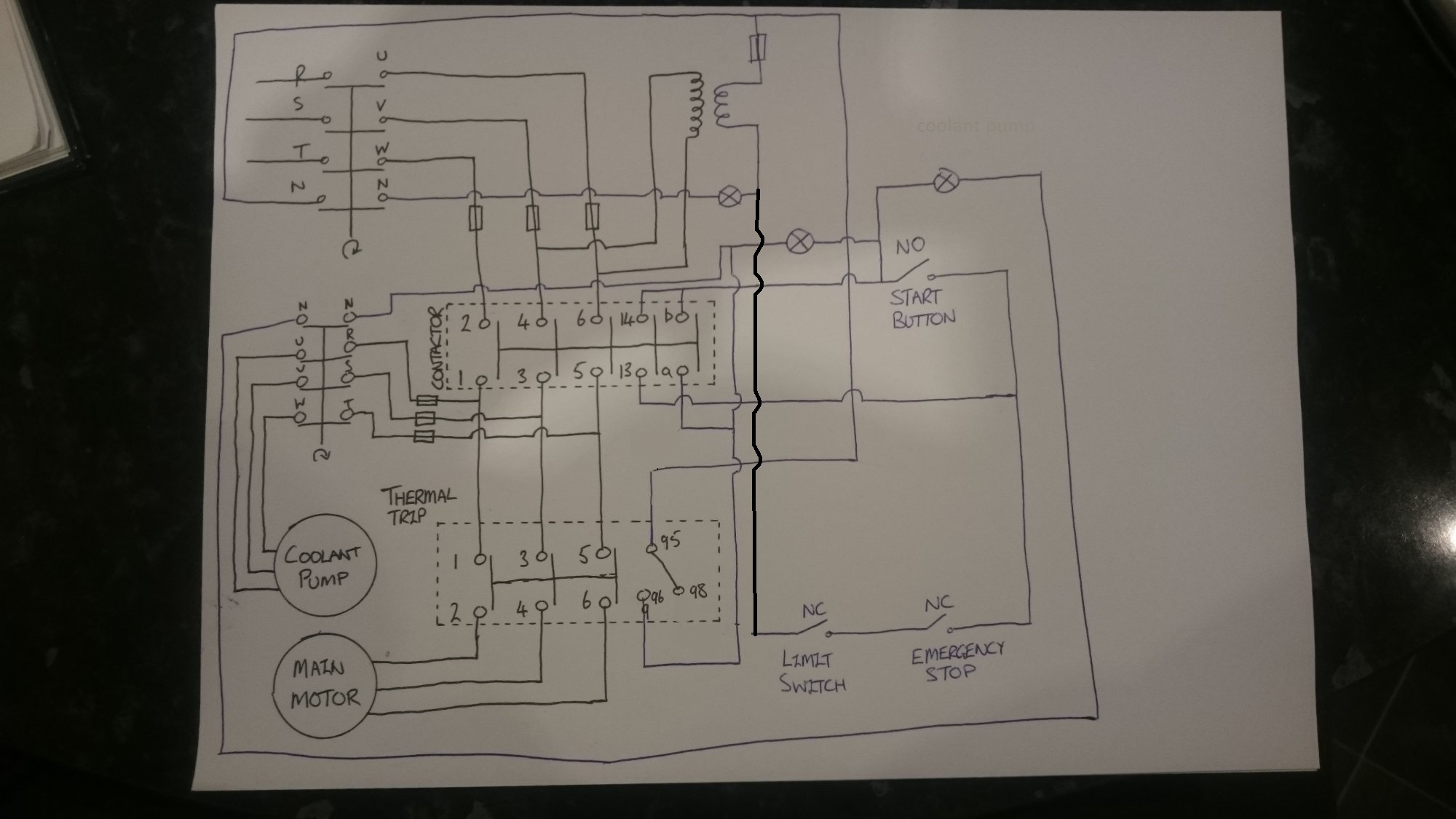

I would assume from the pictures that terminals 'R' to 'W' will be the 3 phase connections and the terminals '1' to '6' will be the low voltage for the control gear. Not sure I like the use of earth cables being used as power connections as it can be a little confusing
