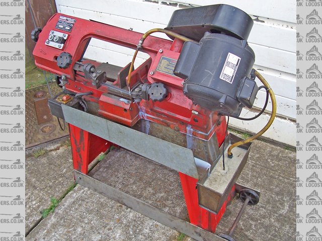

Good choice I've put a bi metal blade on mine and I plan to make a few more modifications but it only took a few minutes of tweaking to get it cutting straight. I noticed in your OP that you mentioned cutting sheet too so just a suggestion I found I had to put a 24 tpi blade on for sheet as the standard 14tpi blade tended to snatch and ended up loosing some teeth![]()
Any suggestions for sources please - been searching the internet but cannot find a bi-metal 64 1/2" blade with 24 tpi - best I have found so far is 14 tpi?
