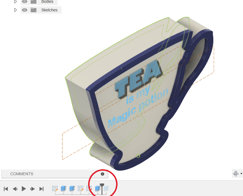

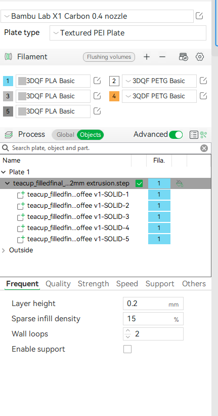

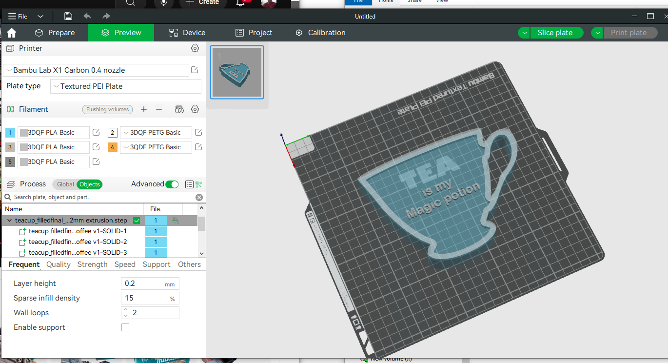

SO I saved it and exported it in various formats and tried importing it to bambu studio (it does the same in orca.
Any suggestions appreciated again![]()

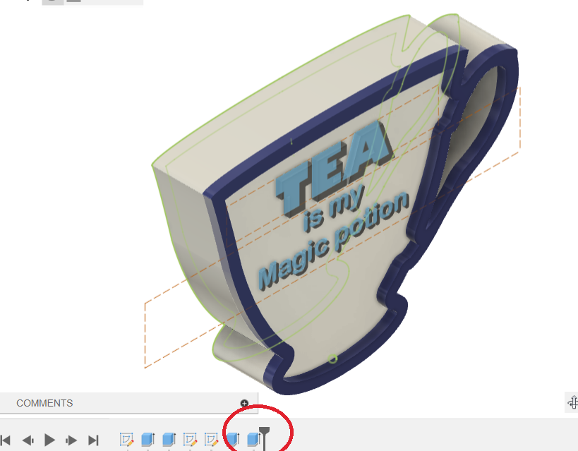

I havent extruded anything. All I did was alter the coffee text to Tea. It was already done. But I am not sure why the is my magic potion is not showing up in bambu studio though even if it was the top line. Or do you mean the top line that now says coffee.You have only extruded the top line.
Drag the history marker to the end of the timeline - the extrusion for the second line of text is the last operation:The is my magic potion is missing but its clearly there in the fusion file.
Ah ok I had managed to get it working somehow. BUT I am now in bambu studio territory and I dont think either you or Aj have a bambu.Drag the history marker to the end of the timeline - the extrusion for the second line of text is the last operation:

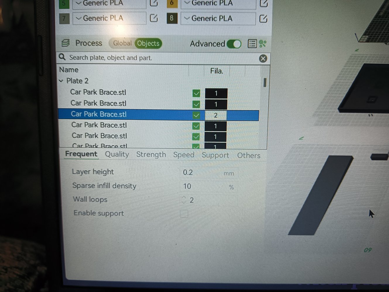

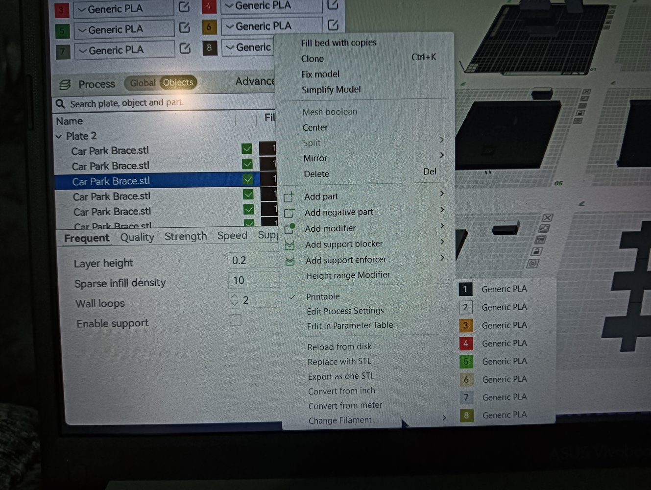

If you right click the 1 to the right of the solid you want to change and pick 2 it will change just that solid to the colour you require.Ah ok I had managed to get it working somehow. BUT I am now in bambu studio territory and I dont think either you or Aj have a bambu.
I can see whit in the model but cant change it in the damn AMS...AARRGGGG
You have got to right click the 1. Here is an example from mine. The filament colour is in the menu.I think thats the problem. There is only 1 showing. There is nothing for the white..View attachment 481175

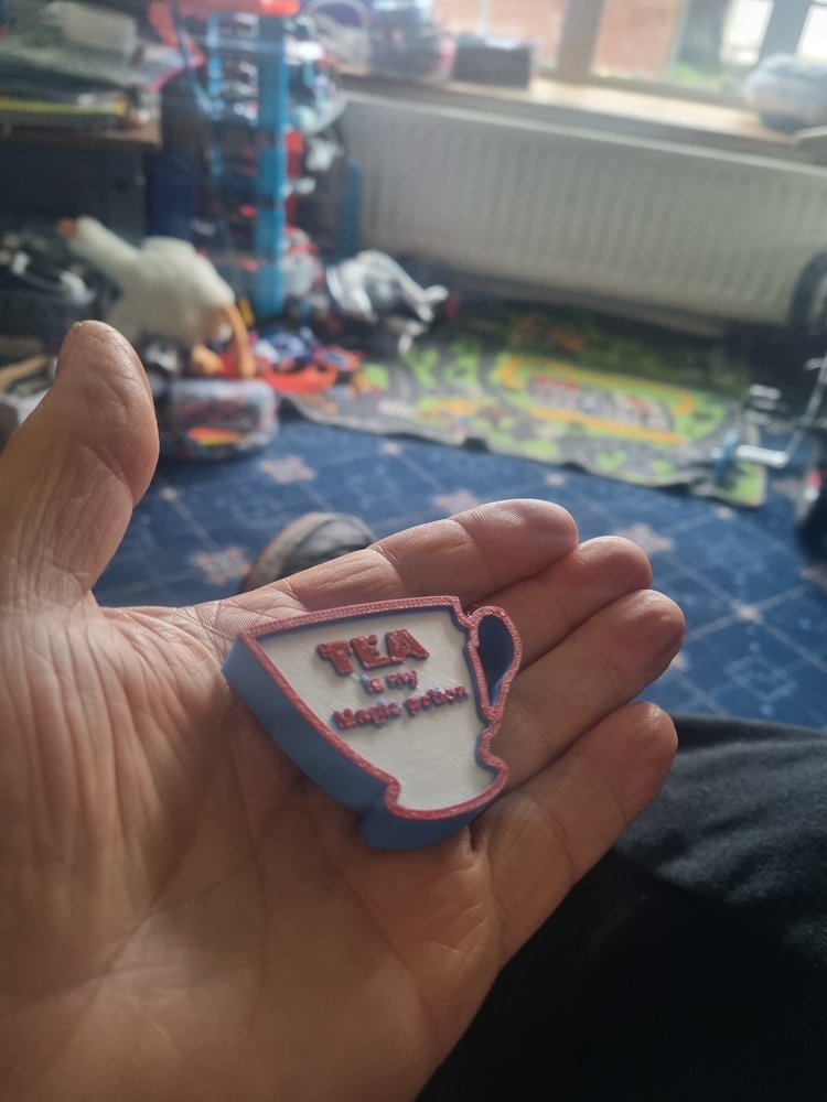

I need to get time to be in front of the screen later. But I printed a small version and strangely it printed how it showed on the plate.You have got to right click the 1. Here is an example from mine. The filament colour is in the menu.

Its really strange as in some models you can clearly see a part that is a colour but it does not respond to right clicking. it seems like clicking it 3 times works.You have got to right click the 1. Here is an example from mine. The filament colour is in the menu.

I've not had that problem, I expect it will happen at some point though!Its really strange as in some models you can clearly see a part that is a colour but it does not respond to right clicking. it seems like clicking it 3 times works.

I add the text in Bambu Studio as I find it very easy to do. You don't get any colour issues either as you assign the colour as soon as you lay it down (same right click option)I watched 8 youtube videos yesterday and although I think I know how it should work , mine doesn't, well not how they claim anyway.

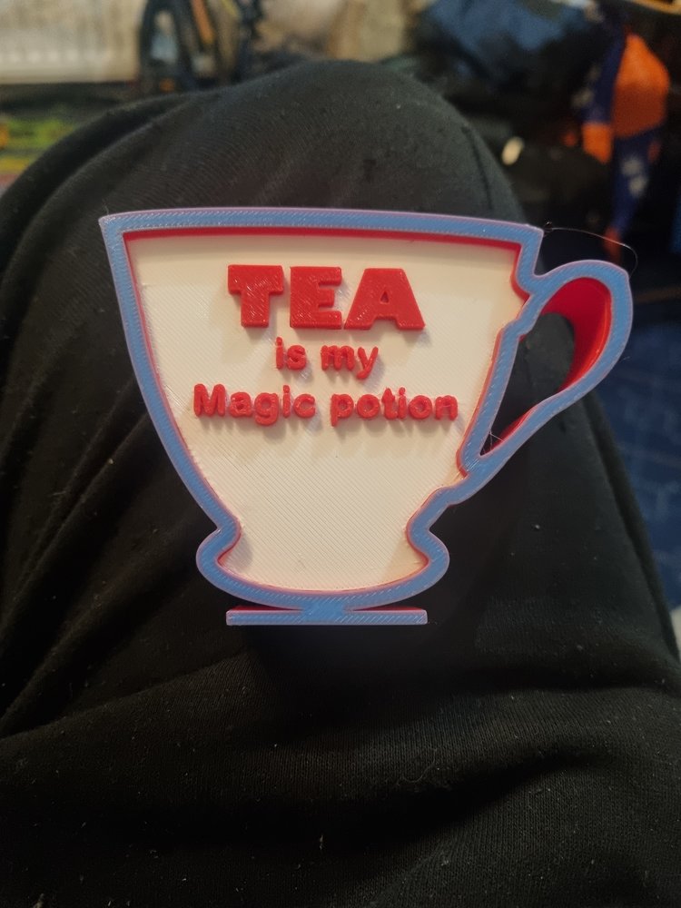

Another test print and the stand actually works a treat. Very satisfying.
I know it won't seem a lot, but today has gone well, just need to cook the lamb dinner and print a bigger version of the potion cup..
