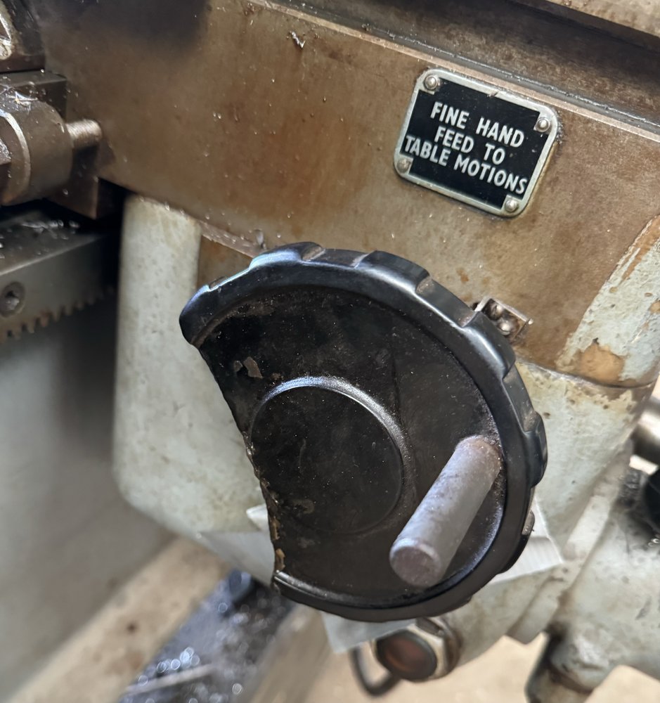

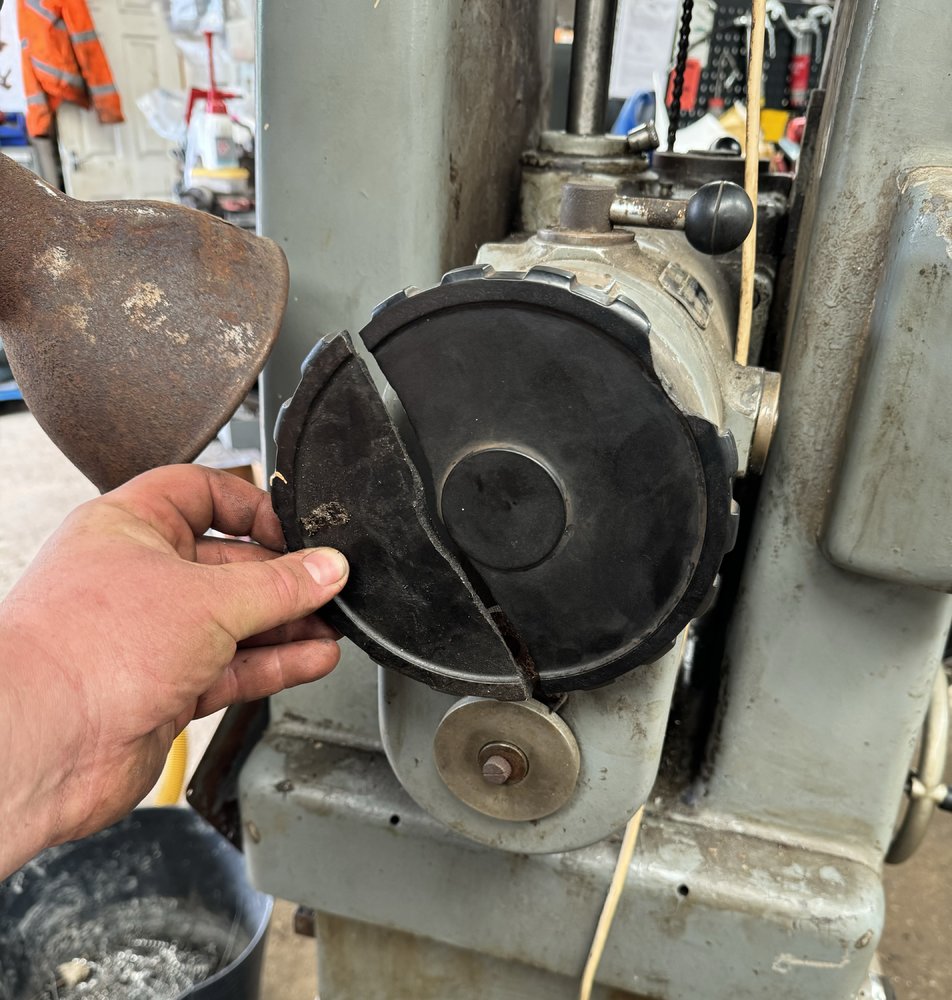

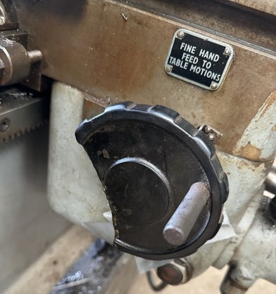

I have several ( approximate size ) nine inch dia black Delrin , one inch thick blanks . Heat the knurled threaded insert if that is how they are mounted to Delrin melting point and press into the finished blank . Deep knurling the edge is easier than milling out the gripsI've checked the usual suspects but can't find anything with the same shape.
OD 7" & 5"
View attachment 452047 View attachment 452048
Could even cast the thing in aluminium, or whatever.Glue it together. Fill and fare the glued edge. Use it to make a silicone mould. Cast a new one in something. What that might be, I do not know. Maybe black epoxy (but you need a vacuum pot to stop the bubbles).
Would like to keep it as per original.I have several ( approximate size ) nine inch dia black Delrin , one inch thick blanks . Heat the knurled threaded insert if that is how they are mounted to Delrin melting point and press into the finished blank . Deep knurling the edge is easier than milling out the grips
PM me if you are interested
Cheers, Maybe if i draw on cad @Hood could mill on his cnc.I’ve got a alloy disc you can have
Be a lot of work on a manual mill
You’d be surprisedWould like to keep it as per original.
