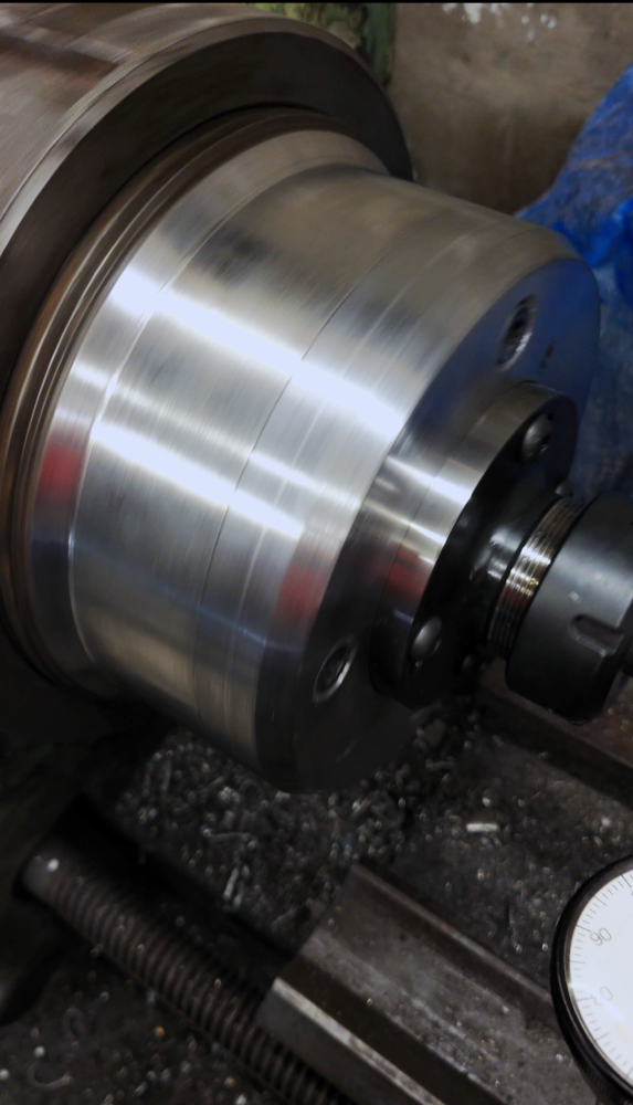

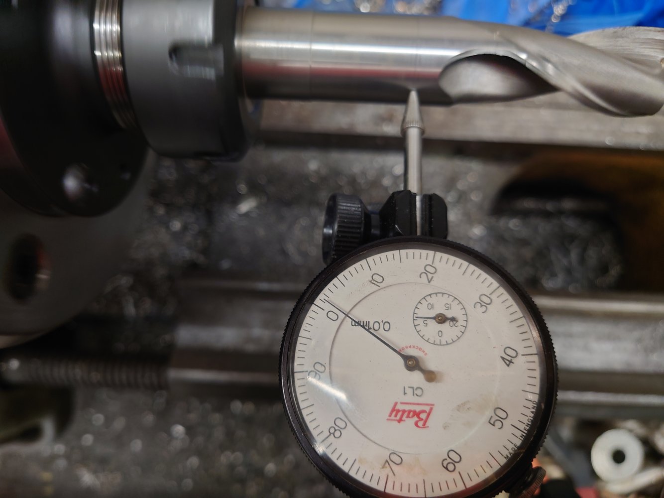

Hi folks,
Just fiddling getting my 100mm backplate er40 chuck mounted to my massive L2 spindle nose, I've a 7" diameter backplate, which with a 0.01mm indicator is showing 0.02mm on the face (went down to maybe 0.015mm after a stoning as there's some odd marks I may face off yet) and 0.03mm on the od of the rim.
That's about a thou I think. Is that acceptable for a collet chuck? I mean it's a amazon special so I'm not sure how concentric it is to be honest..!
Any help much appreciated.
Cheers, Dan
