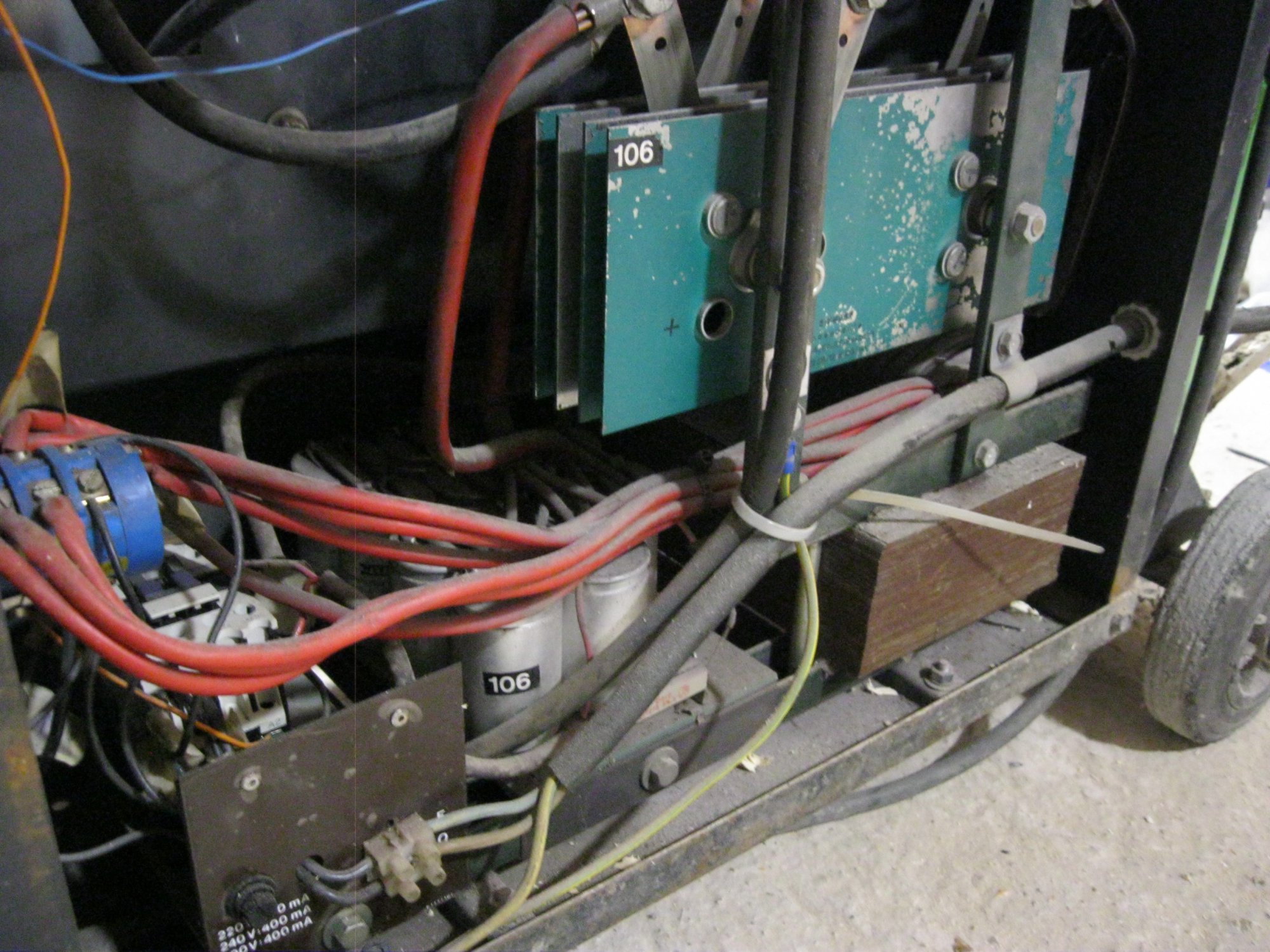

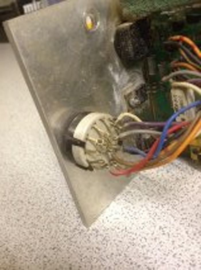

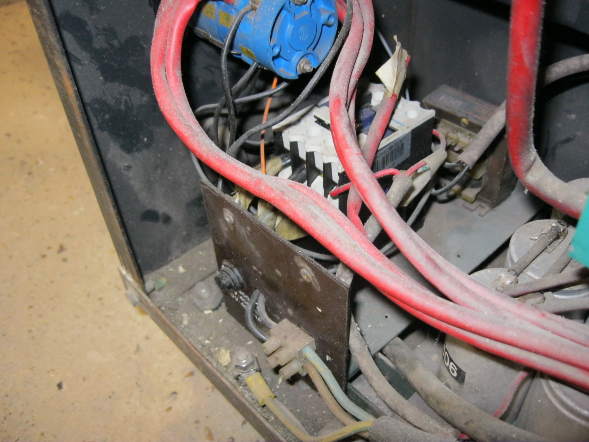

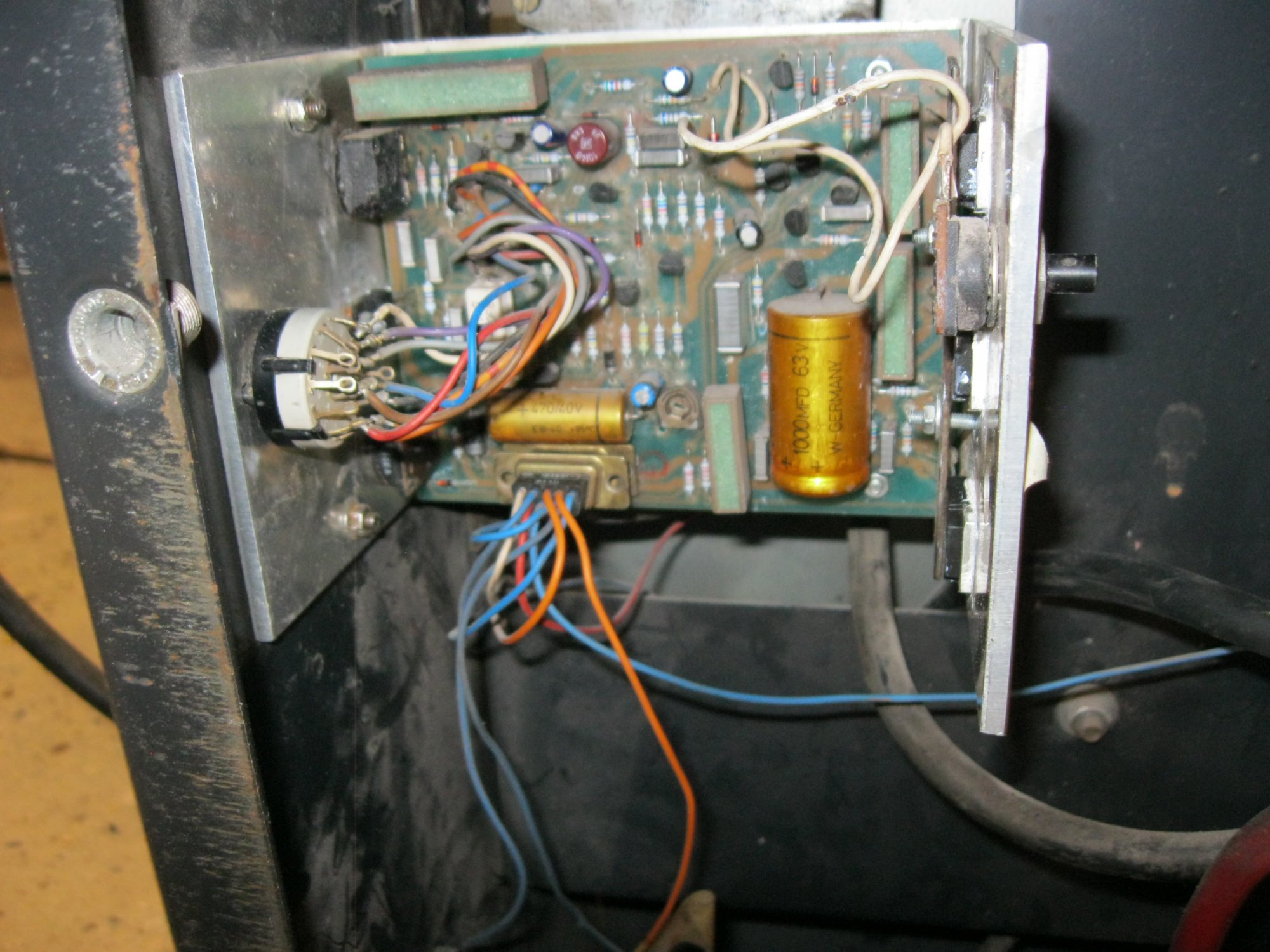

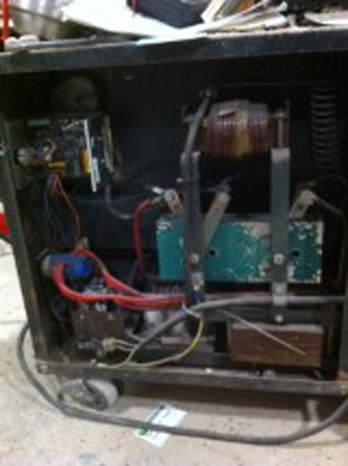

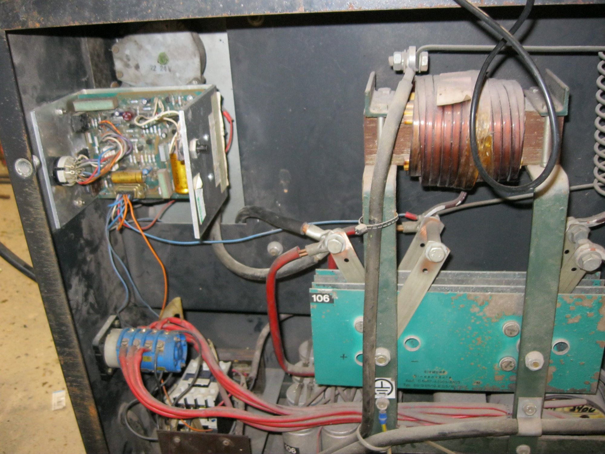

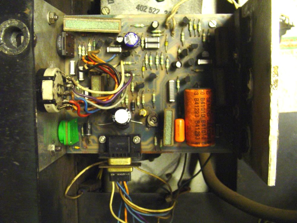

my friend from college days tested it . he used to repair modern technology cranes etc. he has stripped it right down and replaced parts even if they tested ok!we could do with a wiring diagram for that exact model, when the pcb was delecared ok, did they actually try it on another mig ?
can you post a good picture of it both back and frontmy friend from college days tested it . he used to repair modern technology cranes etc. he has stripped it right down and replaced parts even if they tested ok!
any help is good help, the aim is to get it workingJust 'fyi', I'm not trying to stop the remote support on here, it's worked brilliantly many times - I just know I'm terrible at it
i have just read it all and i now have a brain freeze!! thanks for the info though, much appreciated. i'm off to bed and will sort it tomorrow!The pictures are not big enough in that there is not enough detail in them, so what you really need to post is the full size pictures and then just add them as a thumbnail so when we view them we get full size.
Any how a search found this post on here back in 2012 with some circuits and a pdf etc, not sure if the same welder or not but may be of help
http://www.mig-welding.co.uk/forum/threads/migatronic-automig-180-mono.31581/
Hope the information there helps.
Adrian
as you can see the boards are different slightlyView attachment 82085 is it anyting like this one
