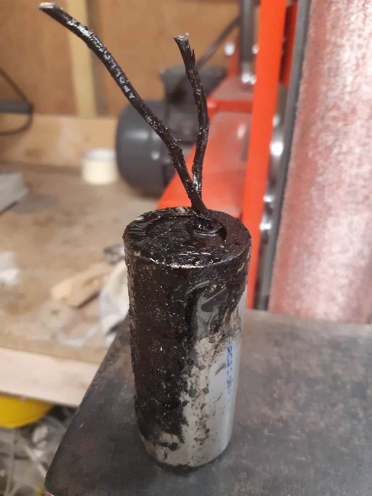

I recieved the new Capacitor from Axminster, connected it up and it's still the same?
Makes a humming noise but wont rotate, the new capacitor gets warm though?
If you do the lawn mower start with it with a piece of string and get it revolving before pressing the on button it works fine..
Any ideas? thanks
NoThanks
I got a message back today saying it looks like the capacitor and they have sent a replacement, is that satisfactory?
