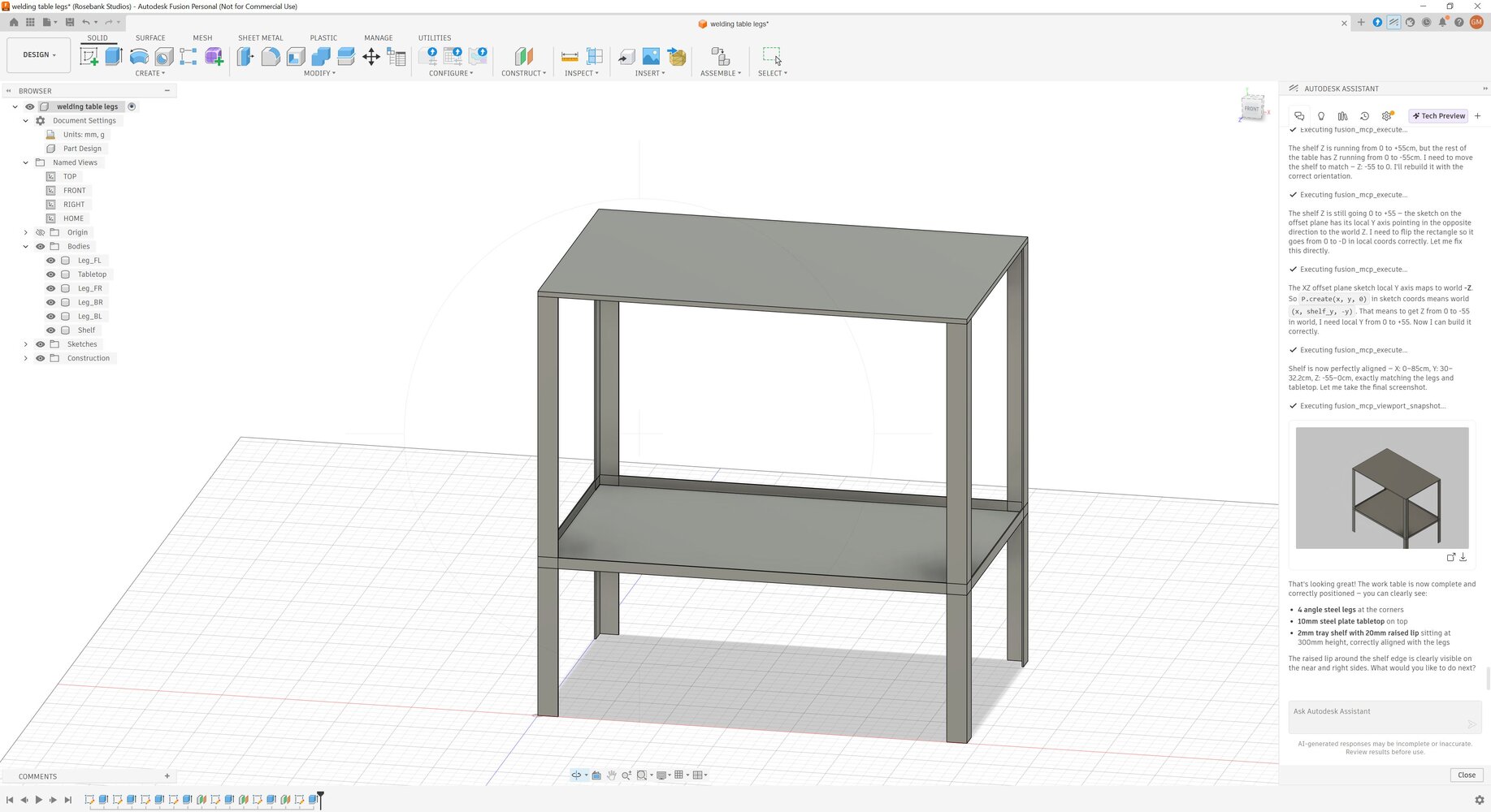

Then asked it to add a shelf at 300mm height, 2mm steel sheet with 20mm lip
We got into a bit of a heated debate as it kept drawing a solid 20mm plate, but eventually we got it right...not bad for half an hour's work in a new modelling tool!!

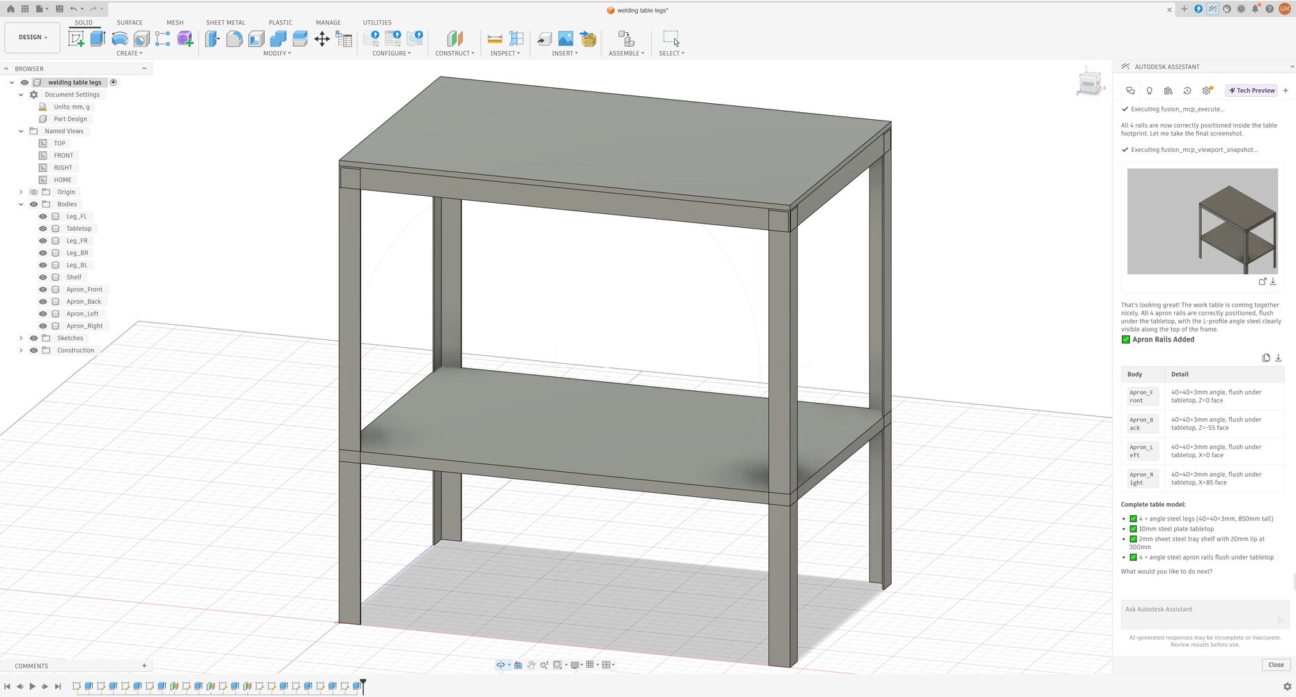

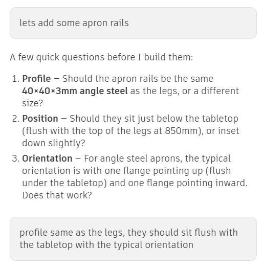

Then it asked if I wanted to add an apron rail to support the table top, or any bolt holes...went for the apron rails:
It made some mistakes, the rails were off to the side of the table initially, but it managed to spot that on it's own and recalculated the positions for them based on the existing model with no further prompts - I was quite impressed with that aspect of it.
It's not "instant" as the Ai is generating scripts to control Fusion, then executing those, then trying to verify results...but it was a damn sight quicker than I could have modelled it !!
Anyway, I just wanted to share this because it's a complete game changer for my modelling work...and if you've not tried it out, I strongly recommend doing so.
