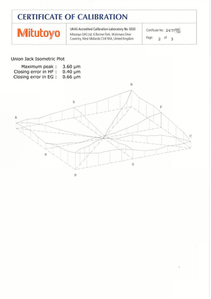

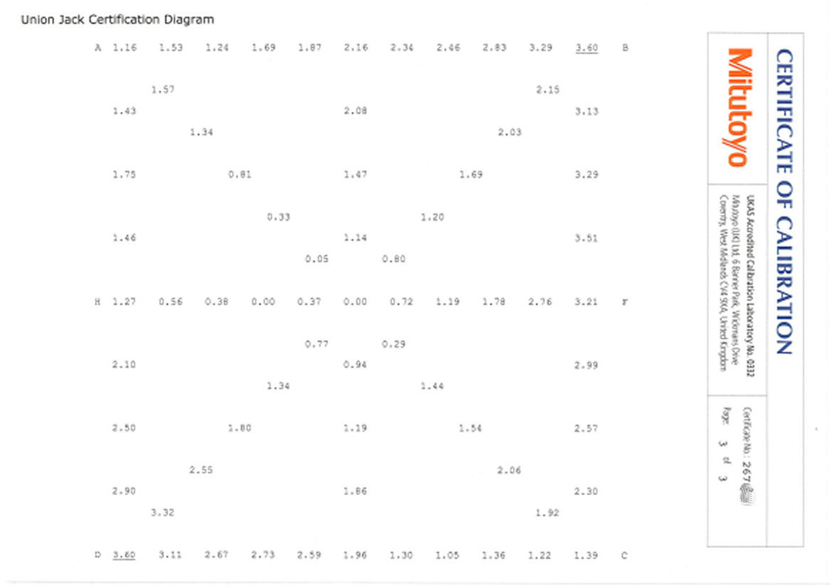

How high?We bought a brand new Mitutoyo surface plate and it wasn't as 'flat' as you'd imagine, although within claimed tolerances. Five years later we had it remeasured and it was barely different, the high spot was still in the same place as well.
They call it a 'Union flag' plot, for obvious reasons. EDIT: ah, I see it's called that on your software as well![]()
