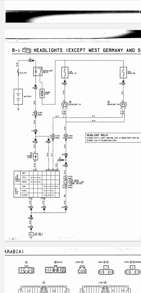

I'm part-way through re-wiring the lights on an old jdm corolla and I have all working with the exception of the high beam indicator light. It does actually work as it should but it's very dim (the other lights on the dash are all 100%).
When I remove the bulb and put a voltmeter across the terminals it reads 6volts, which appears correct from the wiring diagram as it's in series with the headlamp bulb, ie. 6v + 6v = 12v.
I've swapped bulbs around but the bulb seems fine
Any thoughts?
