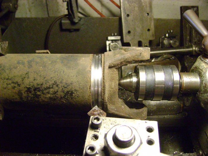

A guy needed 6" cut off for a V-8 Vega project.

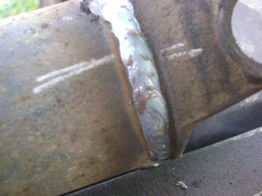

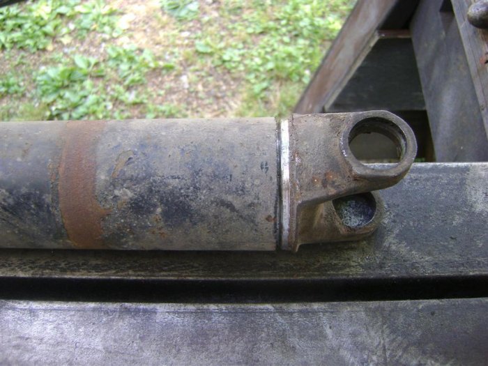

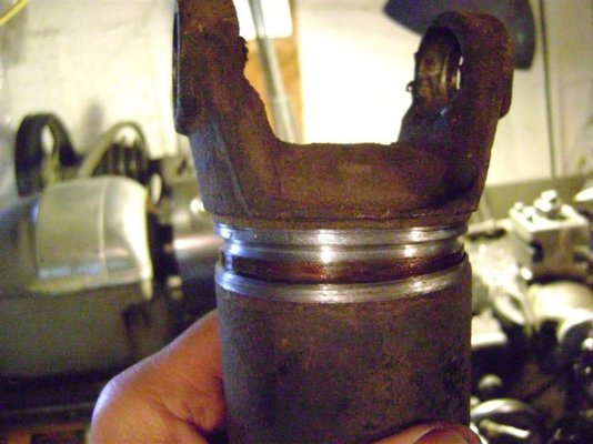

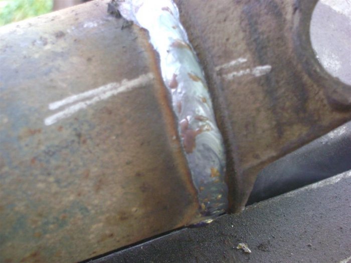

The first pic i removed the u joint, chucked it in my lathe and center drilled the yoke. Then i turned off the old weld, 3 wacks with a hammer until the yoke came out. Then put it on my welding fixture and tapped the yoke back in. Tacked the top and measured the holes and made the other side the same. Then ran a bead around it and done. This one makes #104 since i have been doing them in 1977...Bob
