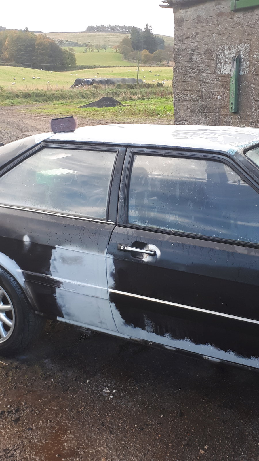

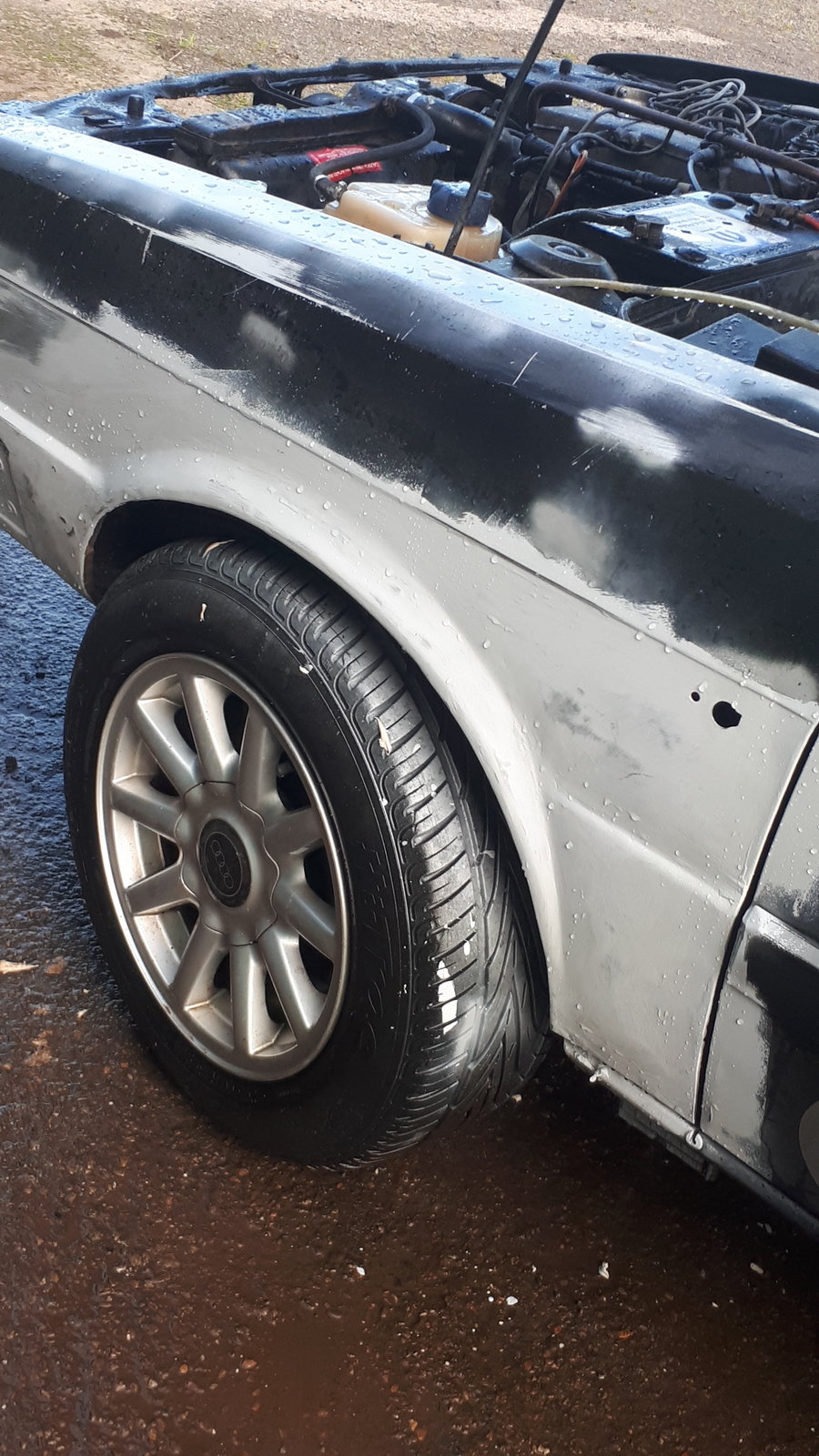

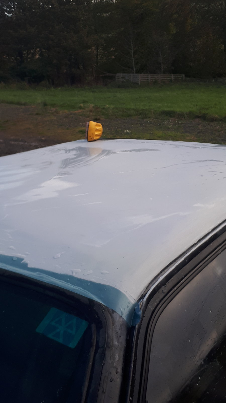

finaly got round to filling and block sanding the new roof and a couple of other areas with dings and reclaimed the ns front wing, typical i had a newish rh one but i had to make new sections around the arch out of 18swg
the body is in amazing nick for its age sills ,bootfloor ,floorpans good as new
no rot on bootlid edge
its hard work that long sander i think if i do more il get an air one ,

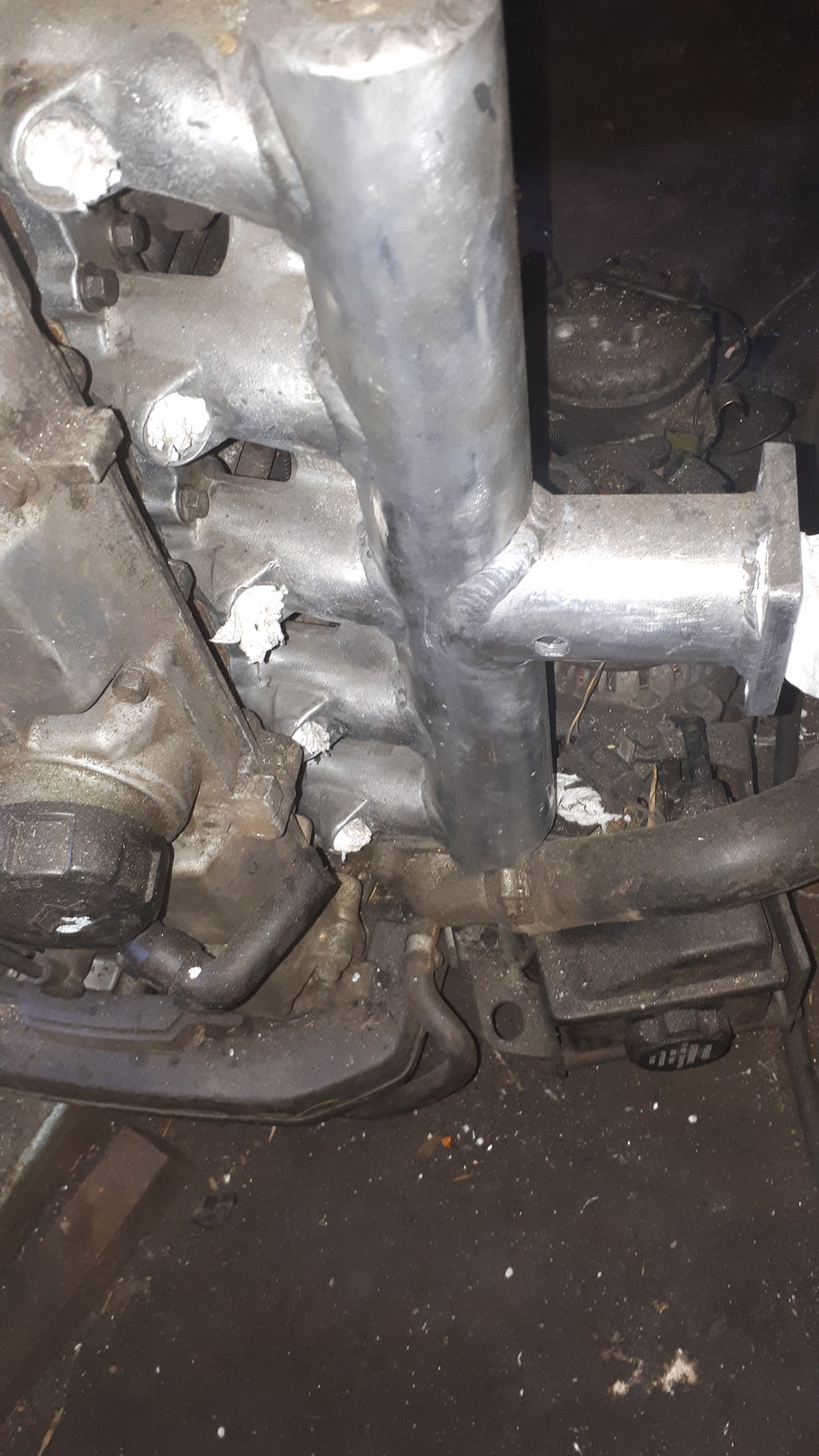

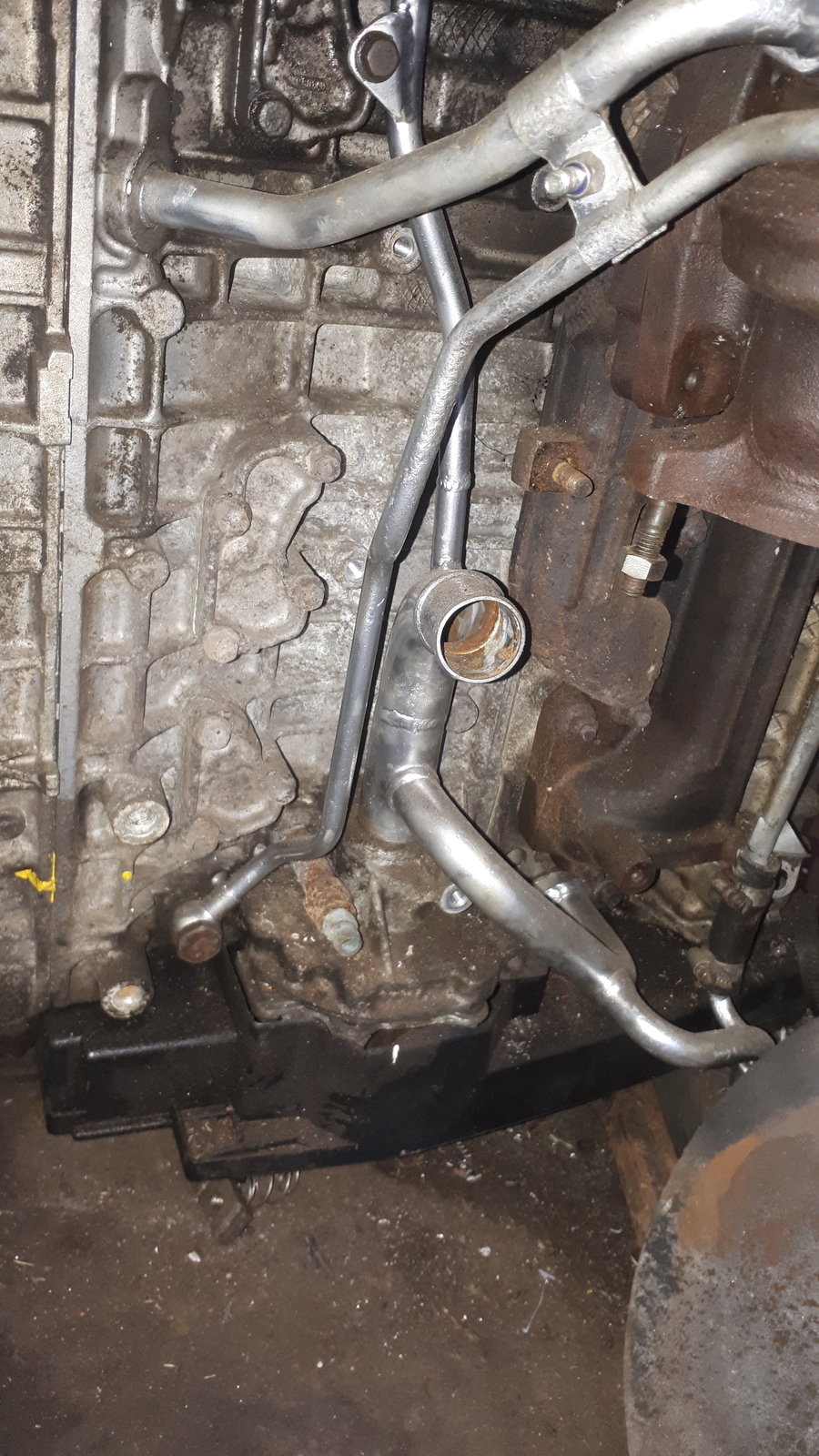

volvo engine almost done
su blow thru conversion made
next move an isolating coat more sanding then 2pack black primer
and more sanding
modded the volvo water pipe to rh front inlet
