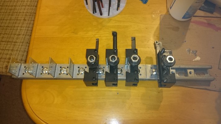

I've about a dozen holders and want more!

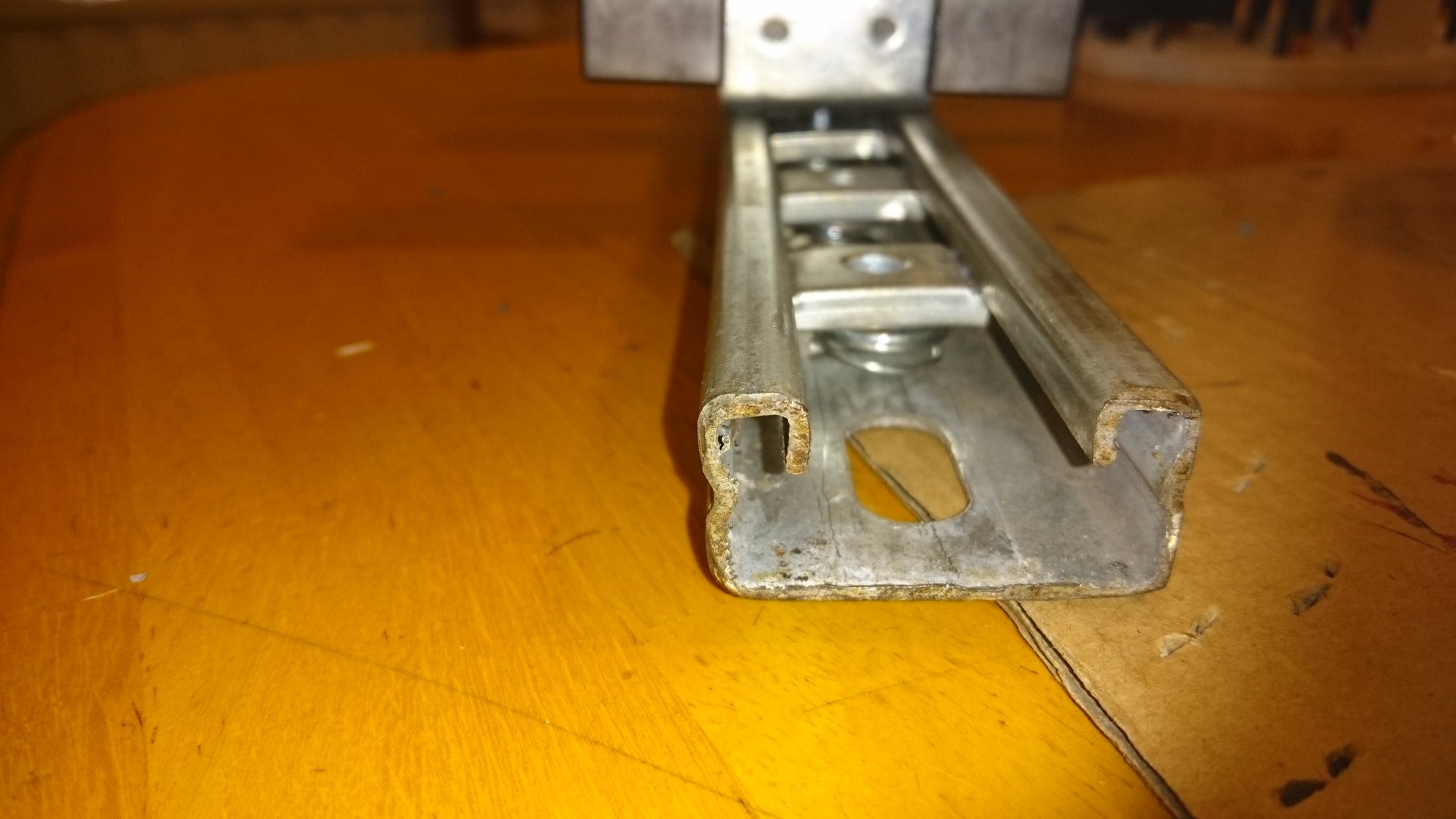

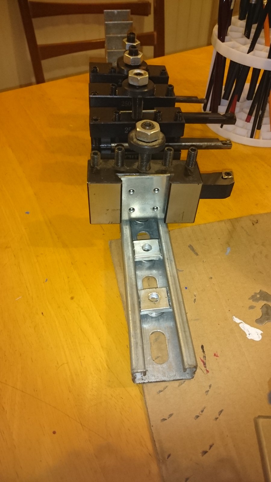

First thing we do in work when fitting any type of Unistrut is pull the springs off. Once slid into the strut the tightening action on the bolt turns them to the lock position anyway.

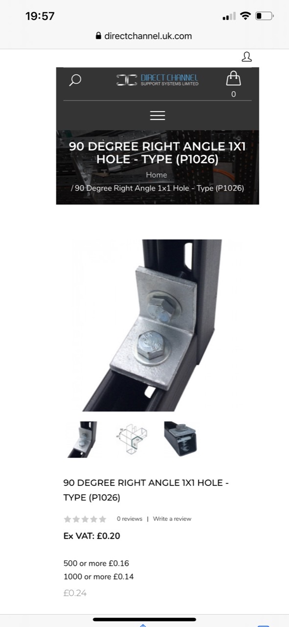

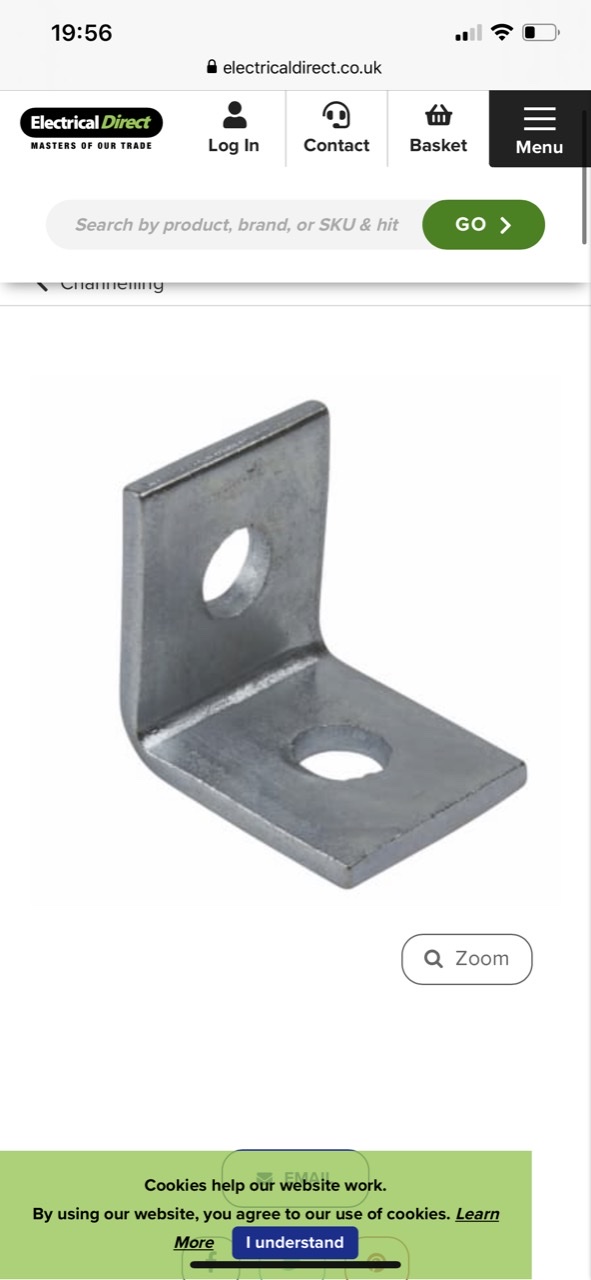

You could Machine the 90 degree Unistrut brackets to have the correct dovetail width and angle to be an interference fit.

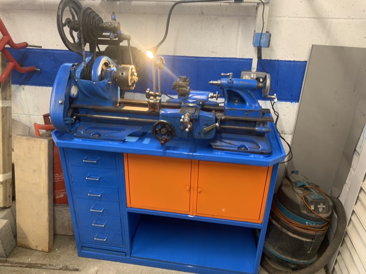

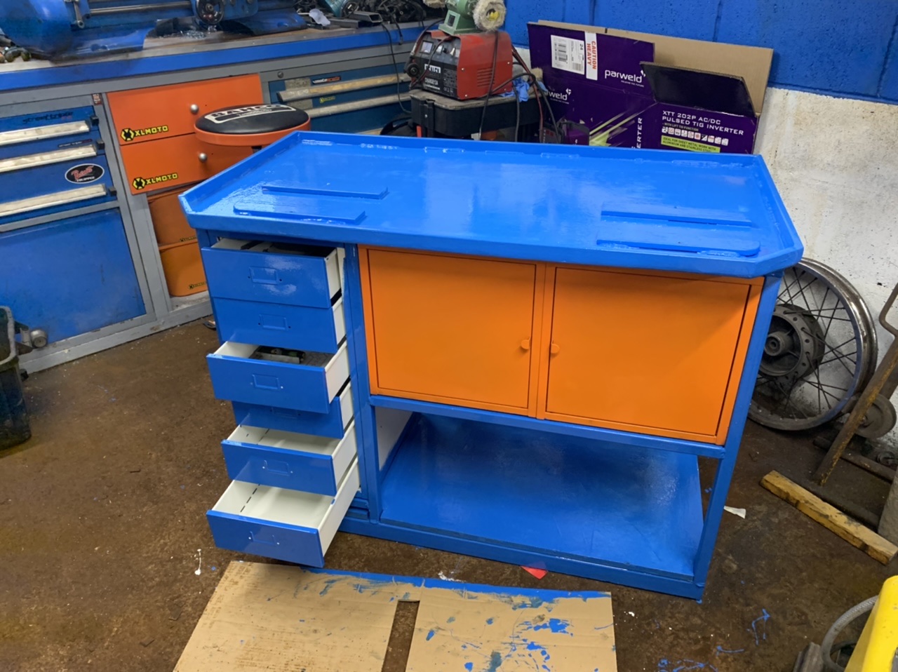

Got my mounting feet drilled, tapped & attached then lifted the lathe on and welded them down before removing the lathe and painting the cabinet.
Very pleased. Top needs another coat and a few places I missed but it looks good and fits in with my colour theme. I have some unequal angle to edge to lower shelf then it’ll be done.
