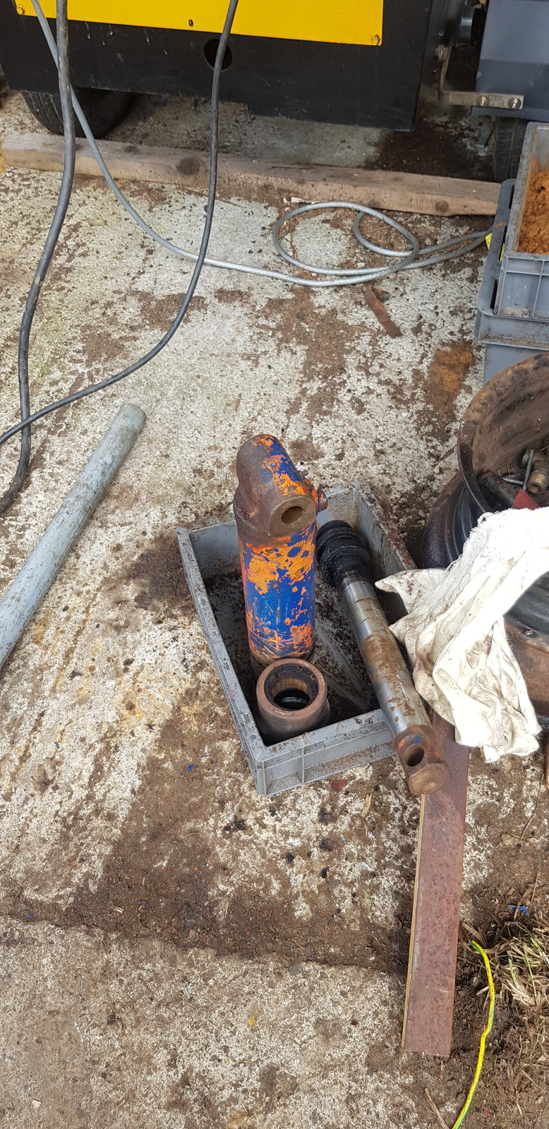

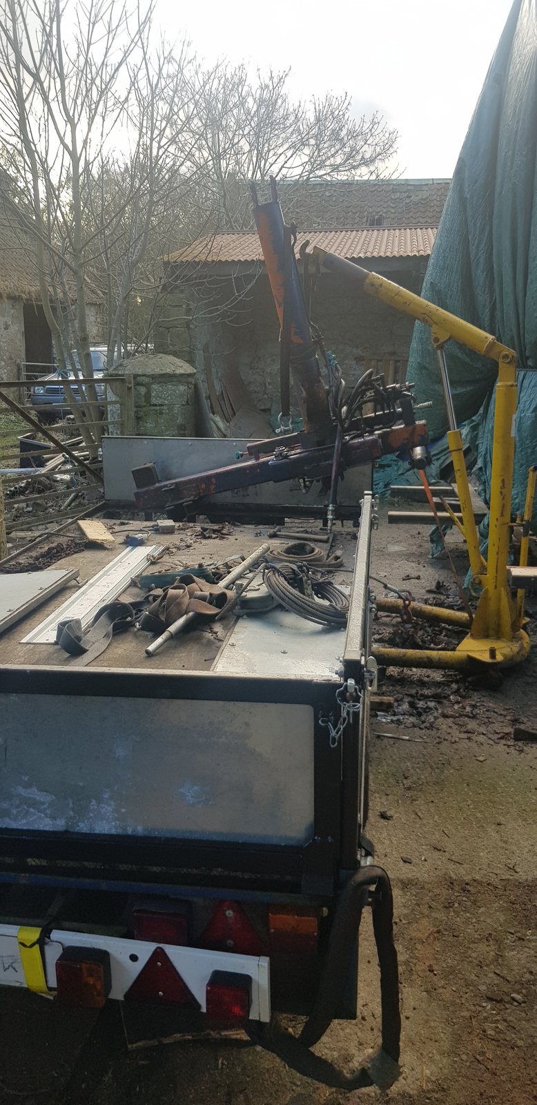

Well this evening it moved - solution was 20mins with the oxy-propane, then pressurise the ram, then another 20mins, pressurise again, and so on until finally it shifted. I was running the powerpack straight into the ram so could only manage one stroke but at least I know its possible now. Next thing is to try the valve block. I'll try and get more pictures up as well.
