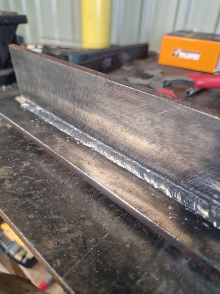

What do your welds look like with the sip wire?
) looked that great, & they certainly didn't with the wee Clarke, but I felt like the Clarke was for me all but unusable with the Clarke Flux Core - either cold welds on top of the thin metal I was trying to weld, or blowing holes - no kind of in-between. On better wire it was still limited of course, but had better range.
