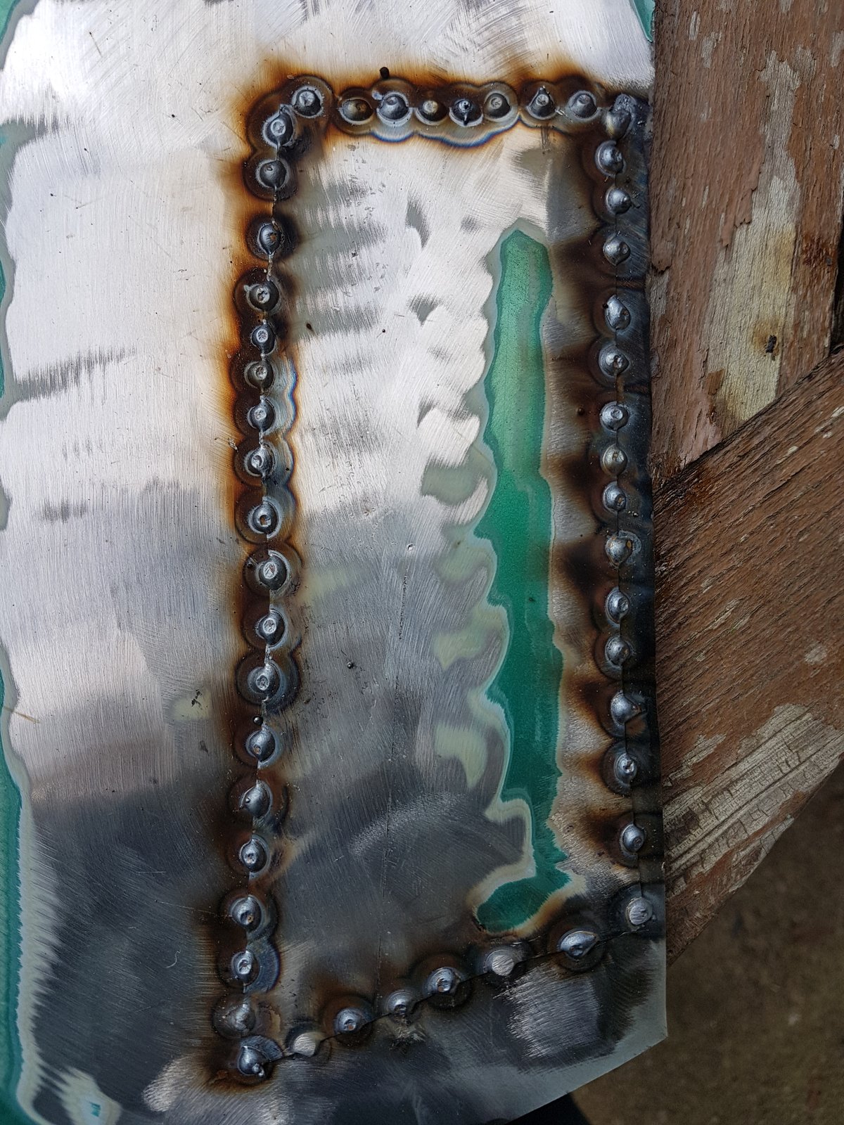

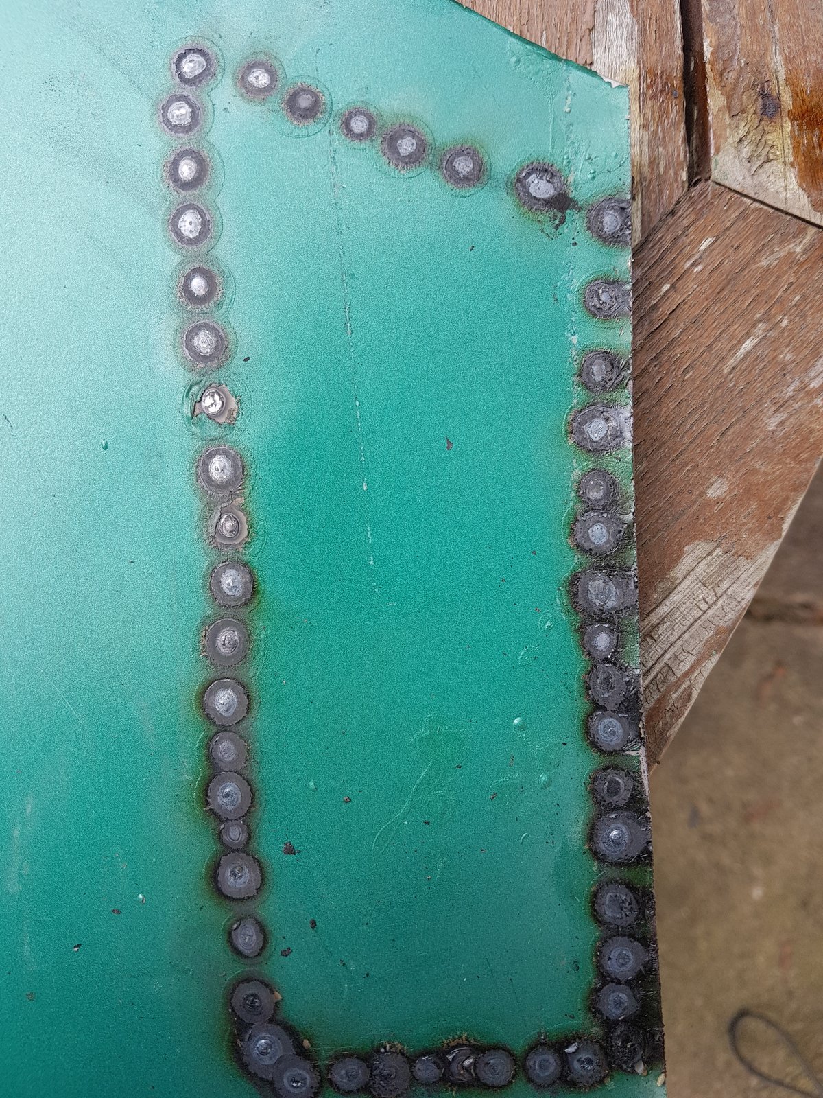

It's a bit lapped onto another bit.The backside looks to be one sheet, where’s the joint line in between the welds?
That's how you do body work lots of tacks all the way aroundYes it is just a bit I scrap I welded on to a bigger bit.
It is for body work on my car. I cant seem to do long beads of welds yet as I seem to just end up burning through. So for now I'm just trying it like this.
(All the welds will be hidden under plasic trim so it doesn' have to look pretty)
Yeah but you get less heat in the metal that way what I didn't make clear is all the tacks have to join upIf that's for body repair for mot work, it should fail as it's not continuously welded. Need to join those dots...
It's better to do beads/runs of weld - it is possible with practice and the right setup.
