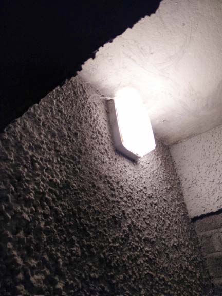

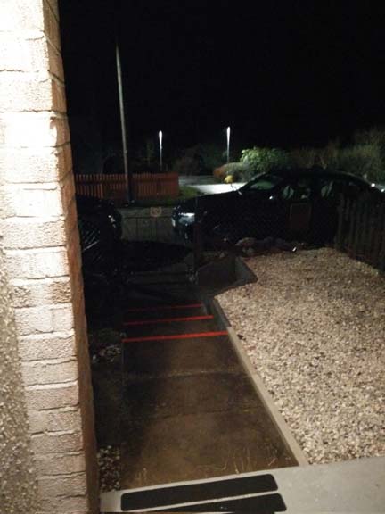

I'm not going to that extent to get round this minor issue. The current b/head light is tucked in the corner to the left of the door
] to feed the LED light, I'll just forget the idea, take the fitting back to Lidl for a refund [it was on offer] and live with it.

There's no alternative power source at the front of the house, so it'd mean going up into the loft and running cables....I'm not going to that extent to get round this minor issue. The current b/head light is tucked in the corner to the left of the door
but as can be seen it's useless for illuminating the front steps/path.
I want to mount the security light to the right of the door from where it would light up that area.
Unless I can [safely] use the earth in that fitting [I've not been into it yet] to feed the LED light, I'll just forget the idea, take the fitting back to Lidl for a refund [it was on offer] and live with it.
Appreciate the sensible advice Sparkies......![]()

It's 90% certain that there is an earth in your existing bulkhead light, just that the adaptor you've identified is not the way to make the connection. A direct connection between your security lamp flex and the incoming cable in the bulkhead lamp would be the correct way to proceed... And that can be achieved either by using the bulkhead lamp wiring terminals or a small junction box. That route does require some electrical confidence and competence though.
) but this will be doable by doing as you suggest - connecting the LED cabling directly to the light supply.
