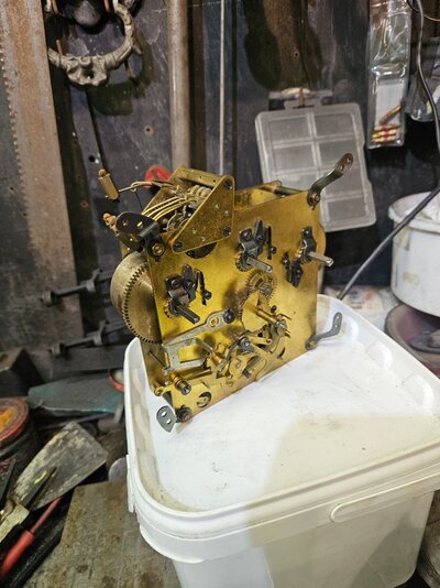

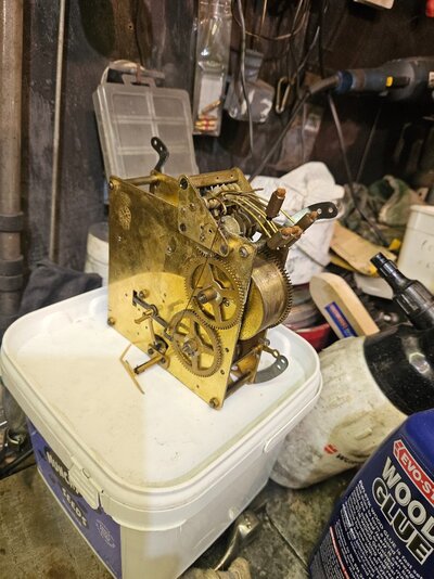

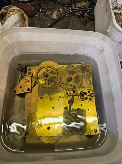

I inherited a “Napoleon Hat” chiming clock that had probably not been running for at least 60 years. I took out the chimes and movement, then cleaned and lubricated the accessible bearings (with proper horological oil). The clock now keeps perfect time and chimes correctly (selectable Westminster/Whittington).
Unfortunately the two springs for the chimes need to be re-wound every second day (they can only be wound about half a turn). These are fully-enclosed springs, and I am guessing that they are clogged up inside. The main clock spring only needs winding once a week.
I don’t feel competent to fully dismantle the entire mechanism, and a professional repair would almost certainly cost far more than the clock is worth. Is there any way to clean that type of spring in-situ by flushing out the gunge?
