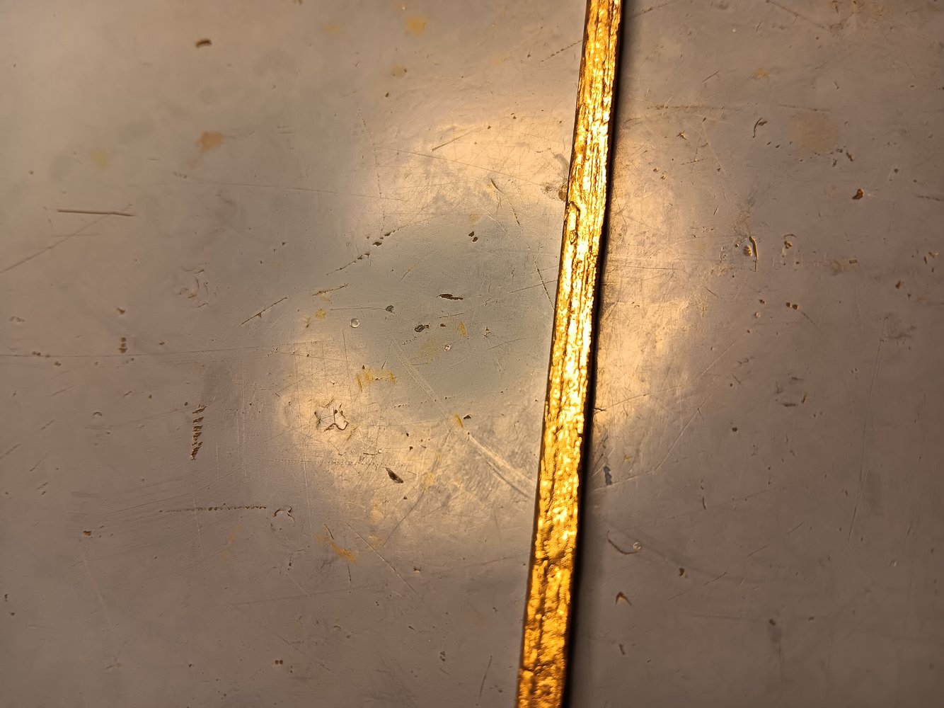

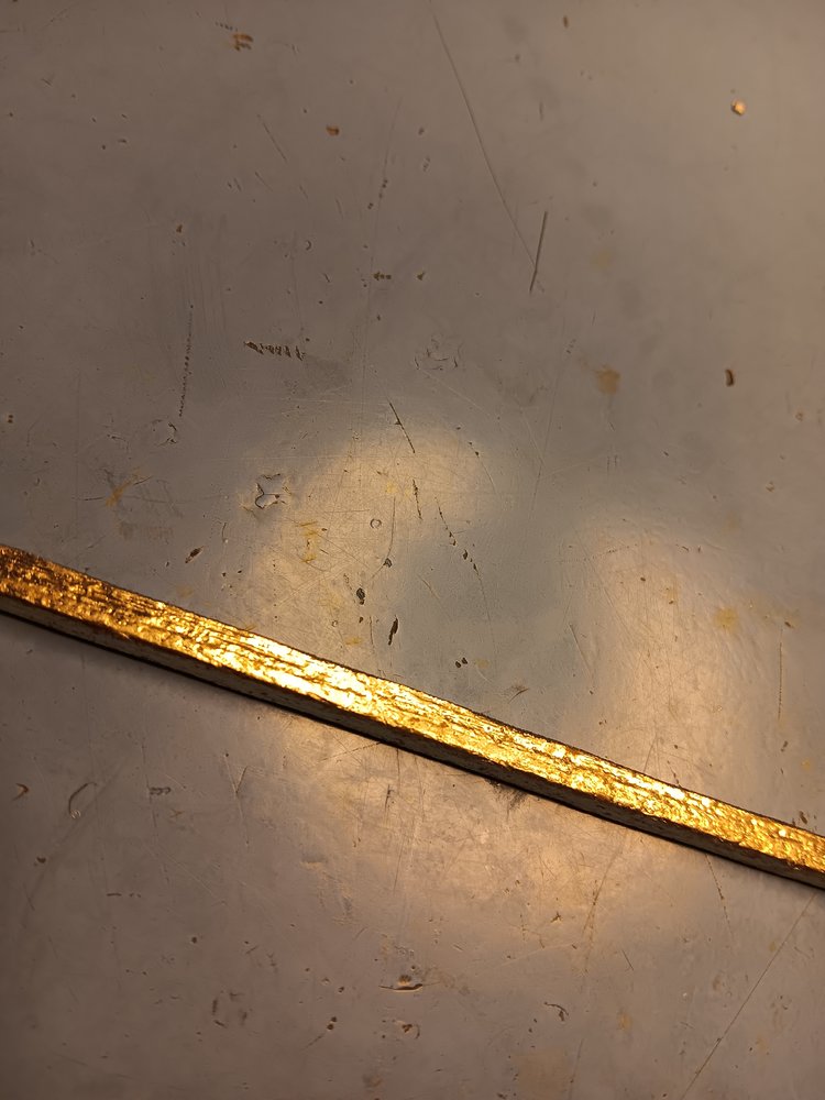

They look too bright, the rods we used were like the colour of cast iron and got surface rust on them when they lay around a while, suppose they maybe were cast iron?Like this aprox 20inches x 5mmView attachment 428300View attachment 428301
Right shape for cast iron welding rods but wrong colour, do they snap rather than bend? Maybe you get coated cast iron rods like copper coated mild steel gas welding rods? I don't know. Below is a link to similar to what we usedDefinitively not a solder material it is hard and no rust, still a mysteryb****r
Tried them with TIG ac & DC not a good idea like sparklers smoke and crap no weld

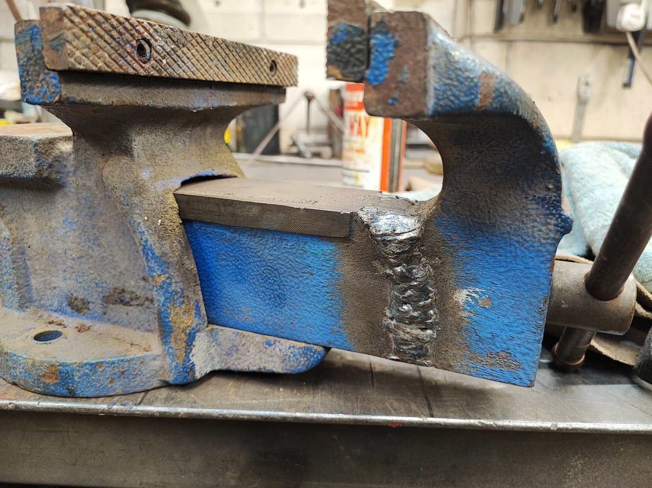

Cheers for the advice. I'll give it a go once work settles down again for 5 minutes.Grind down the weld and add a welded strap across each side, for further support/strength, is my suggestion. That is how I repaired a vise that was used for years, before being replaced by a better one.
