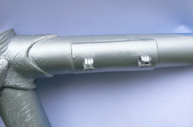

I'm pleased I have read the above first. Thanks very much. I'm sure I would have made that mistake. I've now fitted the rear panel, using a plug weld.
Previously, I've thought plug welds were a great technique and so easy. Today, the weld kept sticking to the plate, rather than the crossbar. Eventually, I managed to sort it out but an enormous amount of heat must have been involved.
I think the secret with plug welds is to make sure you drill a large enough hole in the top piece.

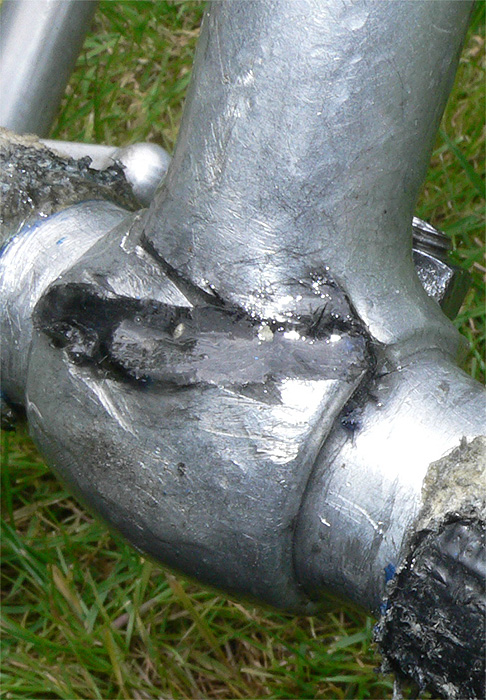

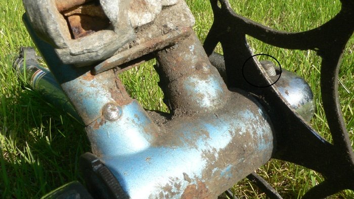

....can you take a slice out of that joint and see if its brazed?
